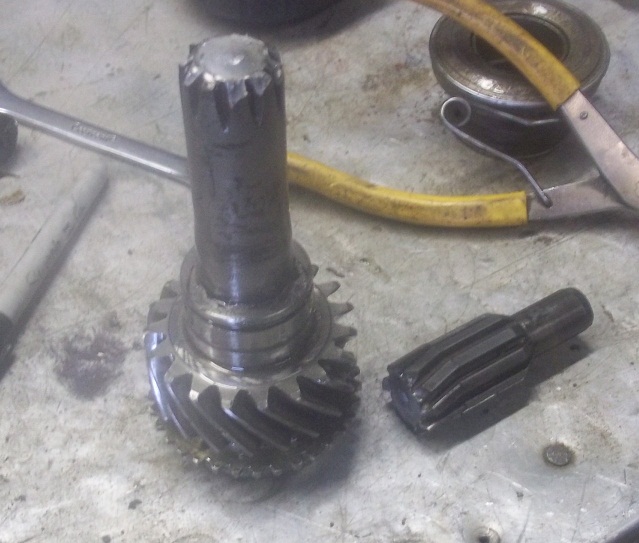

    Thanks Tim, I pulled it apart and found the input "Twisted Off" like I knew already. After thinking of options I got to thinking and remembered the car creeping so I had to hold the brake and I'm thinking I didn't release it quick enough. I dunno but finances right know only allow to replace the input and do some testing :D

  9. Toymaker
    Joined: Mar 26, 2006
    Posts: 3,924
    Toymaker
    from Fresno,CA
    Took the TWIN to a local car show and decided on an "Easy" Test Launch...........Damn if it didn't break the input again! So after a night of depression I go to my good friend Jerry Turner of Turner's Auto Wrecking with the toughts of somehow adding an 1 3/8" input to my 3 speed box. Jerry says check the ****** rack and LOW AND BEHOLD, Ford made my (mid 60's to late 70's) trans with the 1 3/8" input, and Jerry has a shelf of them!
    I know what may of you are saying, "Just by a Shaft" but this project has been built with "Stuff", I have more in the Axles and Clutch than the complete car. So today I begin beating my head against the wall :D, taking it all apart and still planning on making BilletProof WA next weekend, photos at 11!

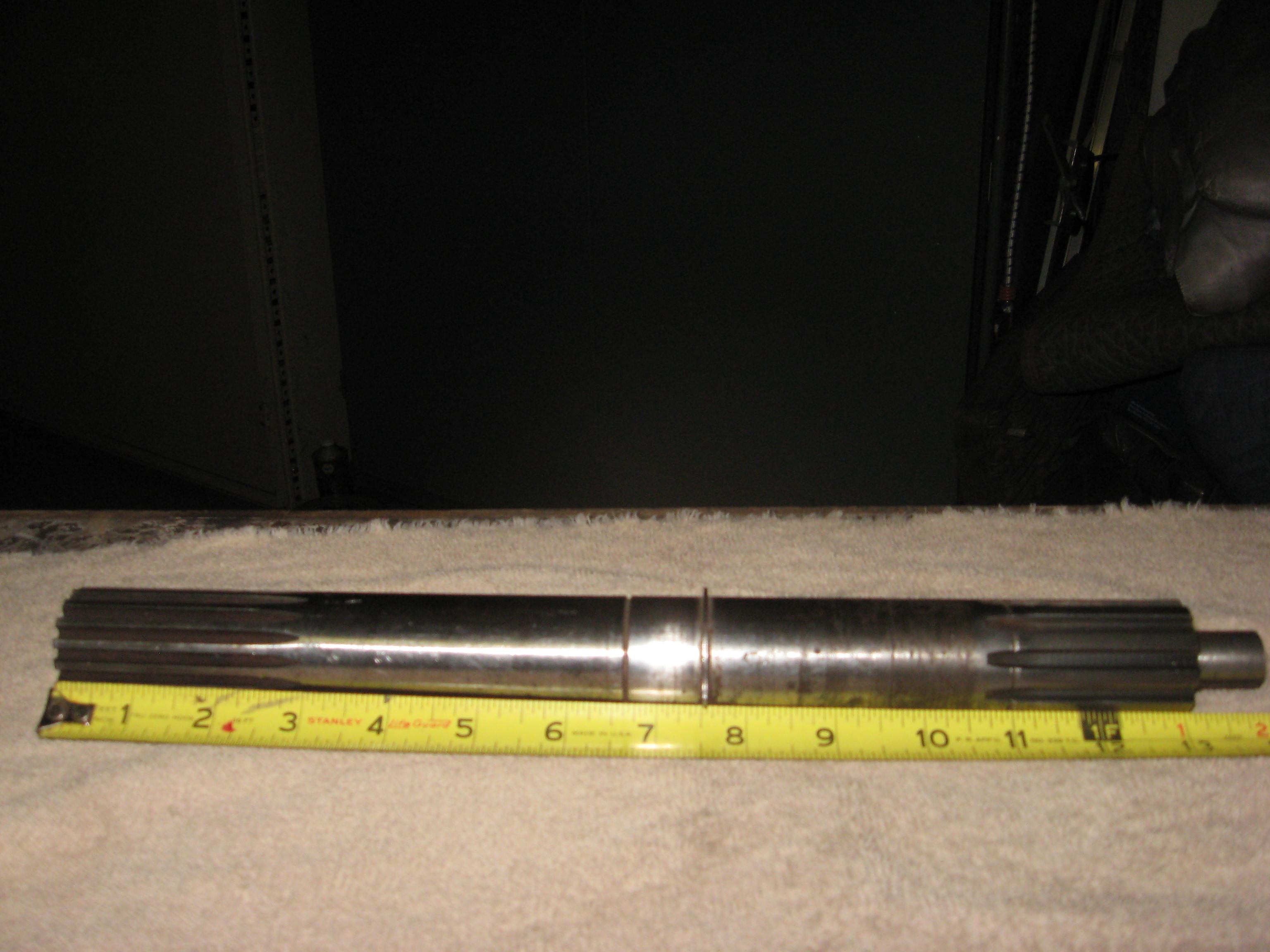

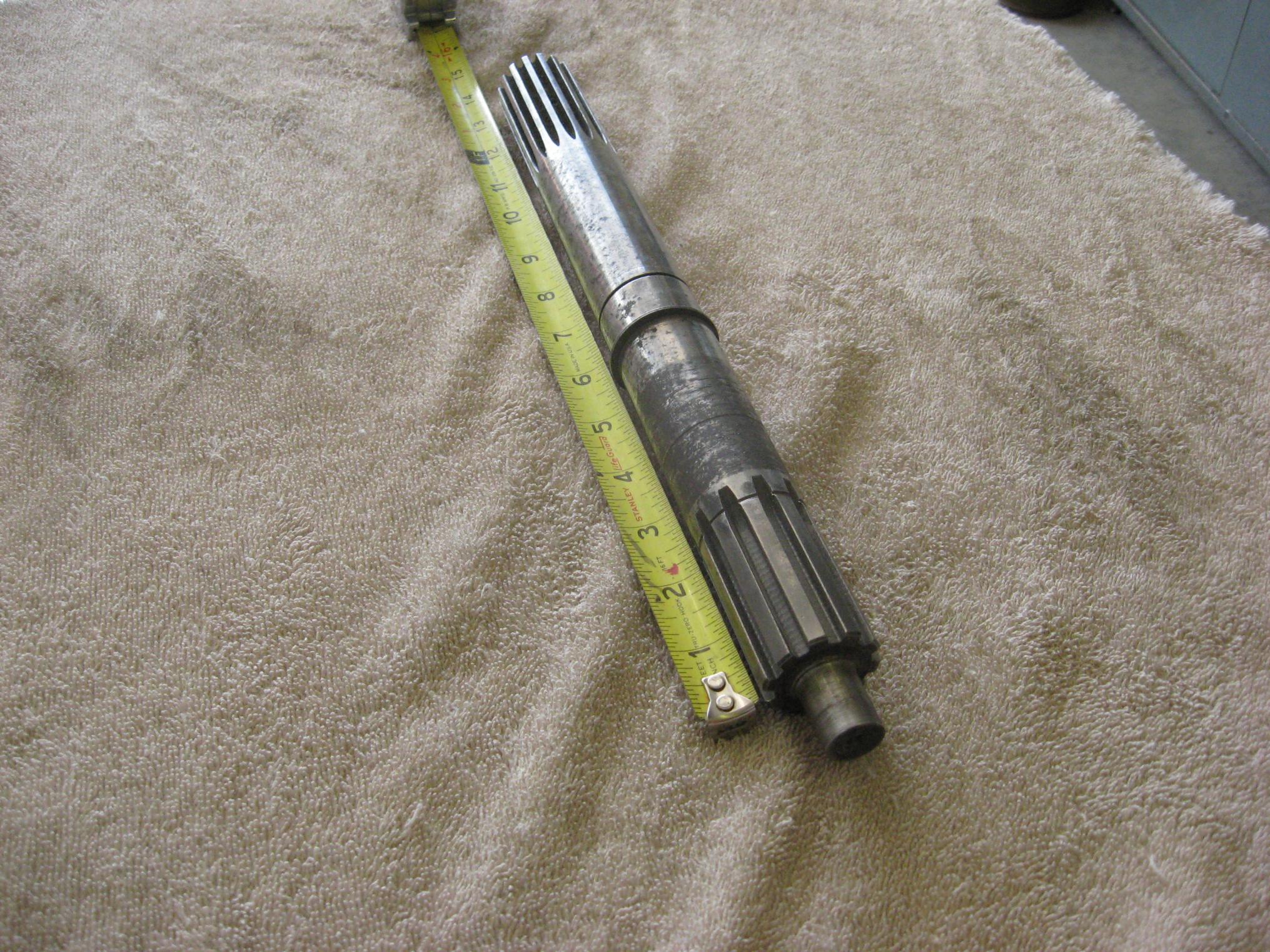

  15. Marty Strode
    Joined: Apr 28, 2011
    Posts: 9,692
    Marty Strode
    It is 13" long,the spline on the rear is 1.3/8 16.

  18. Marty Strode
    Posts: 9,692
    Marty Strode
    You guys go easy on Rocky, BTW this should be easier to read.

  19. Toymaker
    Posts: 3,924
    Toymaker
    from Fresno,CA
    Hahaha, Tom knows me well! Marty hang on to it and we'll talk at BilletProof this weekend. I'm going together with what I have now and will/could make the change this winter. It's about 1/2 way out right now ans I looked with my Borescope and found it broke clean where the shaft goes into the disc. Next post will have pics :D

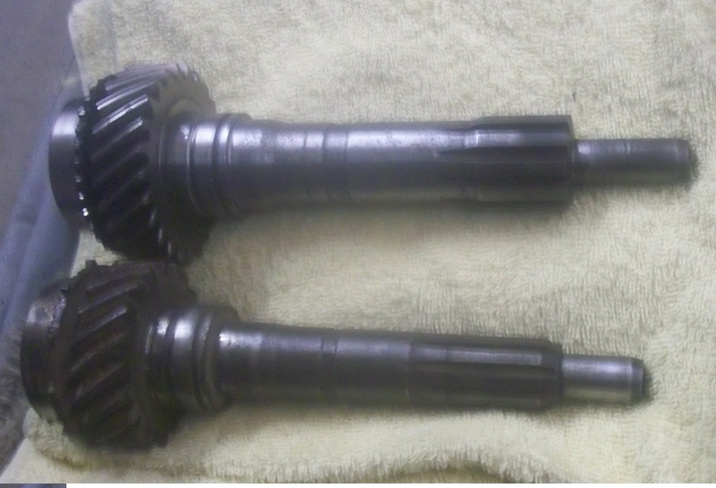

  23. Toymaker
    Posts: 3,924
    Toymaker
    from Fresno,CA
    I could do that and may but ultamately my goal is to hammer it with the tires dry:D
    It's all apart, broke like I thought and while cleaning up the 1 3/8" input I noticed it's longer:(. After taking a nap :rolleyes: and thinking about it I decided I wasn't giving up so I cut the splines with a die grinder for my length, ground off the splines not required (keeping every thing cool) and once I was past the hardened surface I chucked it up and finished it with a Carbide bit. The results are satisfactory as far as I'm concerned, I didn't disturb the hardened surface of the splines or the shaft behind it. Now I have to figure out a throwout brg for the LARGE bearing retainer:confused:
    A recap of the ****** mods so far while I can still remember. A ford 1968 P***/light truck 3.03 case, mid 60's van very short tail housing and main shaft that originally had a fixed yoke with a nut. After determining the splines were common I cut off the threads and made a short slip yoke. The 1 3/8" input is from a 1963 ford (6 cyl p/U I believe) and all the gears have been removed to make it just an in&out box. The shifter top is a T-150 from a jeep and I'm checking on seal bearings so I can get away from filling the case with oil all the way to the bearings. Off to Valley Friction tomorrow to get the larger hubs put in my discs and see what I going to do about the T-O bearing.

  27. Kenneth S
    Joined: Dec 15, 2007
    Posts: 1,526
    Kenneth S
    That could be your problem Rocky is that the stock input shafts are too hard (like the way stock axles are). Recently I cut down a 1 3/4" dia x 10 spline input shaft (that came from B&J racing transmissions) for a Nitro FC, and it seemed to me to cut easier in the lathe than a "stocker" input shaft.
