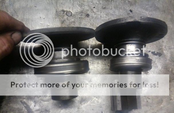

    While waiting for the clutch I machined the T-O brg "Collar" to shorten it .750" to match the GM brg I'd been using. Before modifying the clutch fork I need to go back to the wrecking yard for another look!

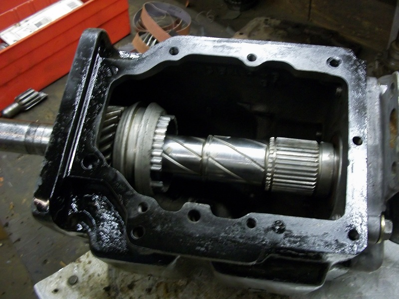

    Picking up where I left off starting with my home made in&out box. The Box is now run dry with sealed input and mainshaft brgs. When the ****** was figured out it was time to fit the T-O brg and figure out a T-O Brg Fork, fitting the T-O Brg was as simple as marking the diaphram spring and grinding each finger an 8th of an inch. I was really fortunate to find a "Fork" at Turners Auto Wrecking, Jerry has a "gaggle" of them and patience paid off with a Ford unit that clipped in place of the GM fork...........SWEET!
    After all this the car went right back together, only needed some minor adjustments, and after only a "static" test we loaded it on the trailer and the Twin performed flawlessly @ Billetproof. The next major test will be at the end of the day on Oct 6th, after making p***es with some water on the tires I'm goona put it to the firewall, drop the hammer and see if I get the results of 1960 I'm looking for :D
