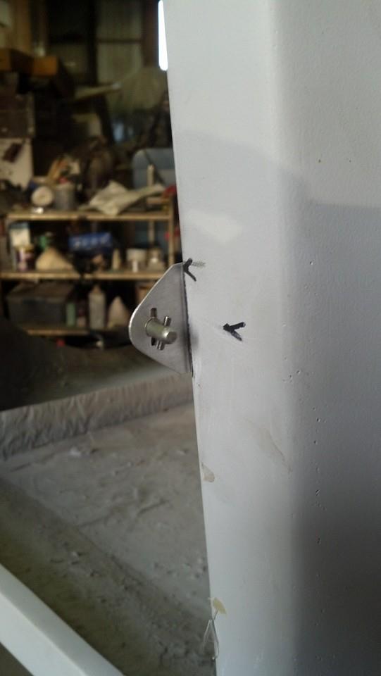

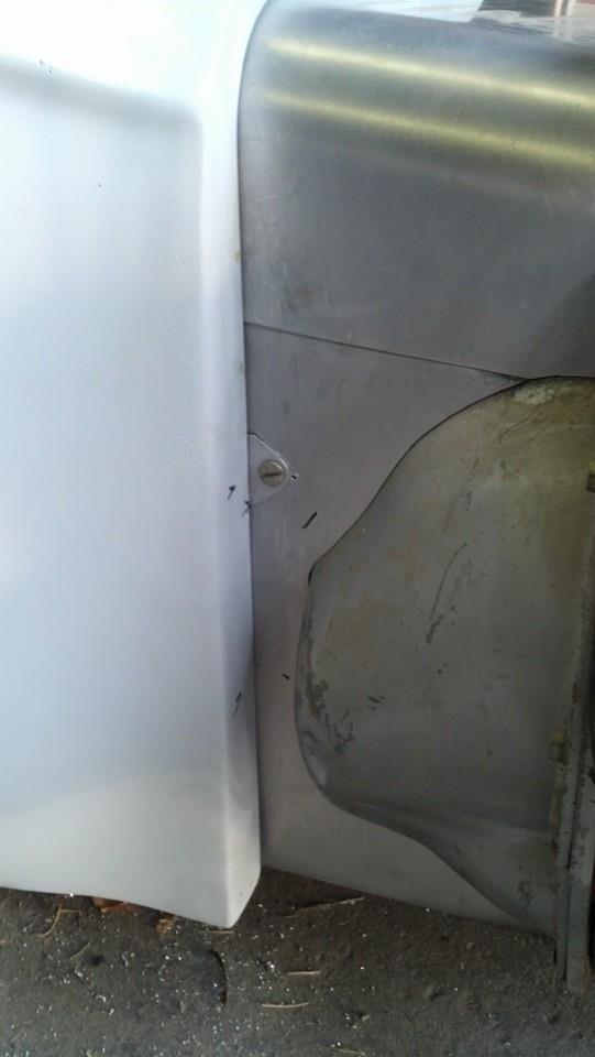

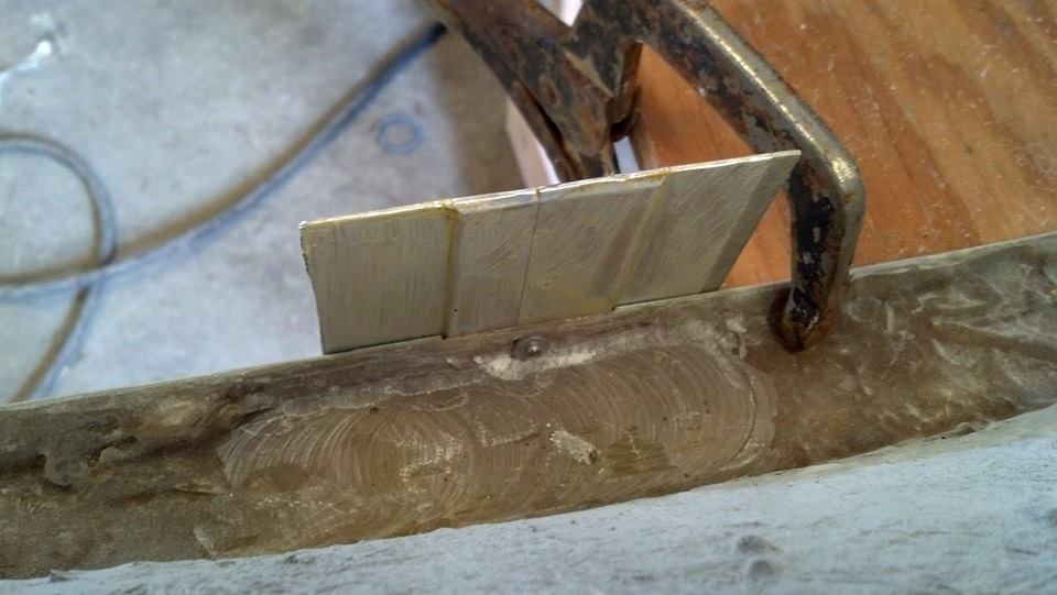

    Got after mounting the TWIN's Roadster body yesterday after a family friend did some major body work, Thank You Cheyenne Brisco! First I had to "File" the opening back to make the tabs flush when completed, then I added the extra piece to give the tab more material around it for strength. Once all the fitting was done I covered the pieces with (I love this tape) aluminum tape to give me a seamless "Mold", and waxed it real good before riveting it into place.
    I've found I like using smaller piece when laying out this type of project and also it seems to me that if you keep stirring the resin after the catalyst is added it will "work" (stay liquid) longer although the heat and humidity got me yesterday when the resin set up before I used it all......no big just a small loss.
    After the gl*** set up I it all came apart as planned and I riveted the tabs back on, they will be removed again for paint then I'll use machine screws for final ***embly. I started the project using "Shake Proof" aircraft fasteners that you see in the photos, the Key Hole you see is so I can remove them completely as they normally stay in place but with the "Fit" of the body they must be removed.
    I know it doesn't look like progress but I'm getting there, now on too the back which I plan on having completed this weekend!

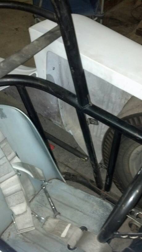

    One step closer to finishing the rear body support.....adding a bumper also.

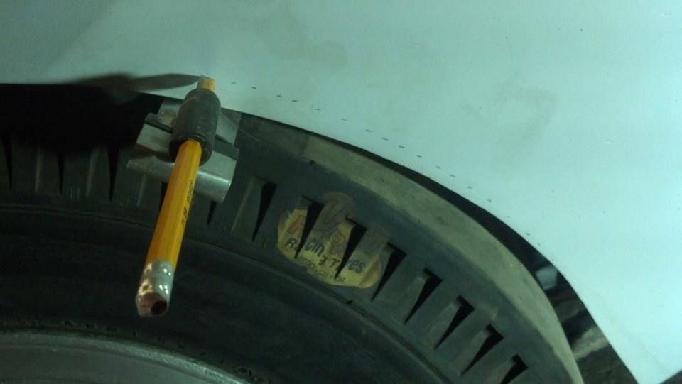

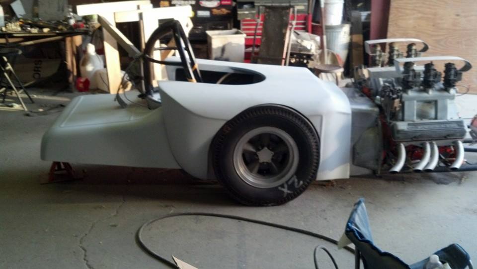

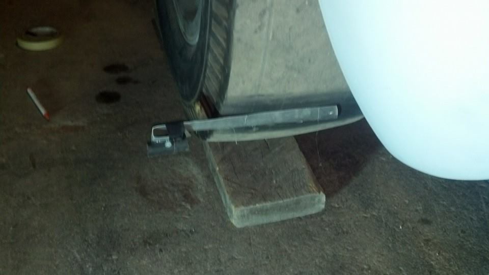

    The wheel wells were marked out with a "widget" I Hot Glued to the tire. Once in place I made "dashes" on the body then "connected the dots" with masking tape to use a guide to make the final cut line with a pencil. Cut it with an air saber and we're getting closer to paint! :D

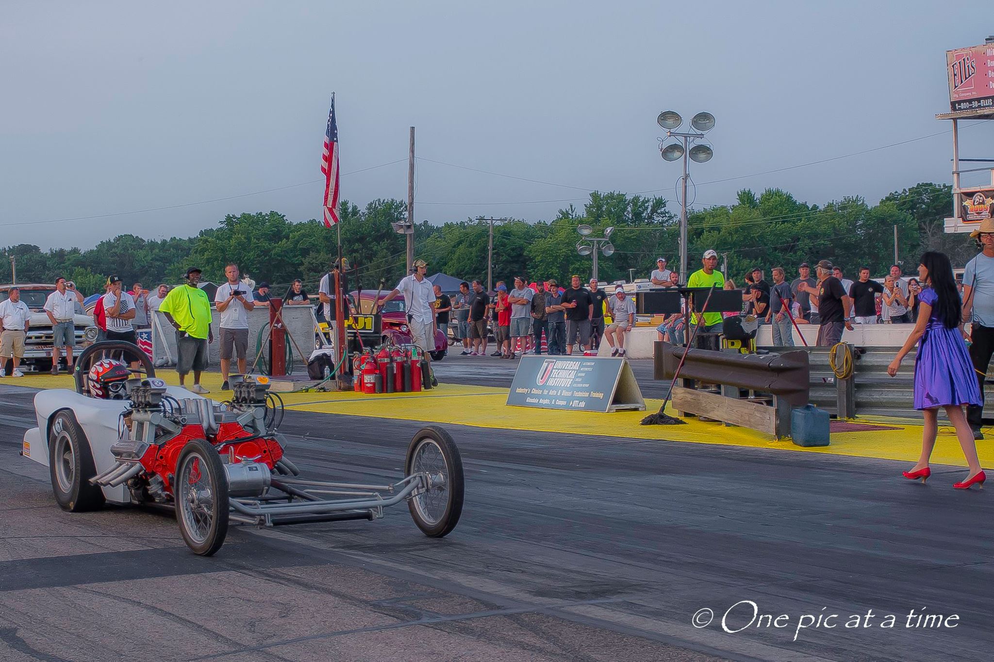

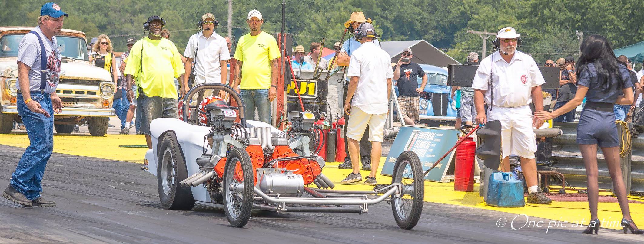

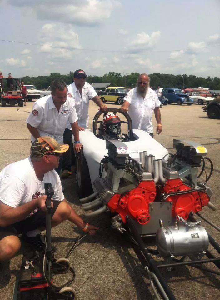

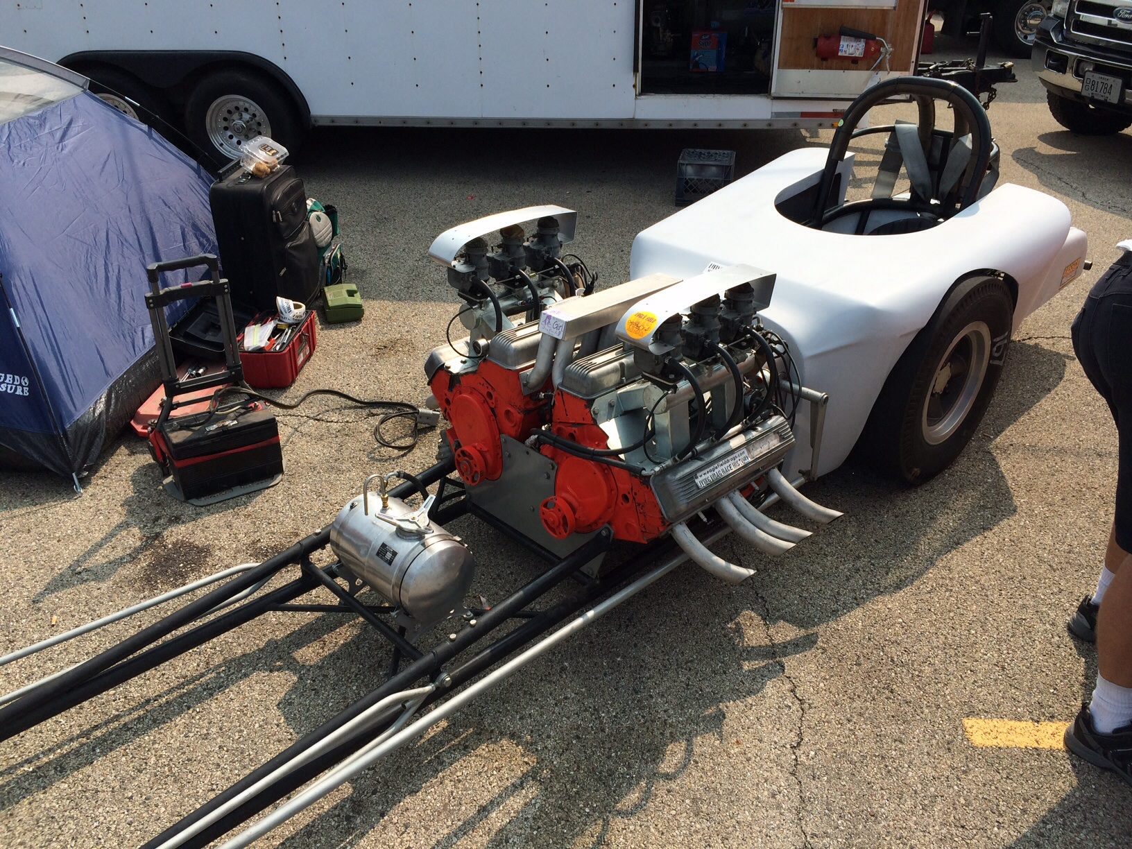

    2014-meltdown-drags-pit-photos007.jpg 2014-meltdown-drags-pit-photos009.jpg 10470865_863853103626418_6875635492218384806_o.jpg 10520908_863846240293771_5042923036954363131_o.jpg 10583911_10203279553022824_6867214046107116606_n.jpg Twin Byron3.jpg Twin Byron.jpg meltdown-drags-2014-gasser-chevy-ford-031.jpg Thank You Ray, we had a great time didn't we and no worries Tim we are not done yet :) . The trip to the Meltdown Drags was long.......2000 miles......but worth every mile! The Meltdown guys put on one hell of a show at the gorgeous Byron Dragways facility, the even provided perfect weather for us Californians :) . We made 3 runs on Saturday, the first time with the Body on and dare I mention a new NOS system which I was a little hesitant at first but after all the thought I put into the system I told my son "if it feels good do it". That is exactly what he did and the car loved it, the future holds a set of 3:70 gears to get the wheel speed up now that we have the power. Anyways here are some photos of the incredible time we had at the Meltdowns and again a huge THANK YOU to the entire Meltdown Crew!

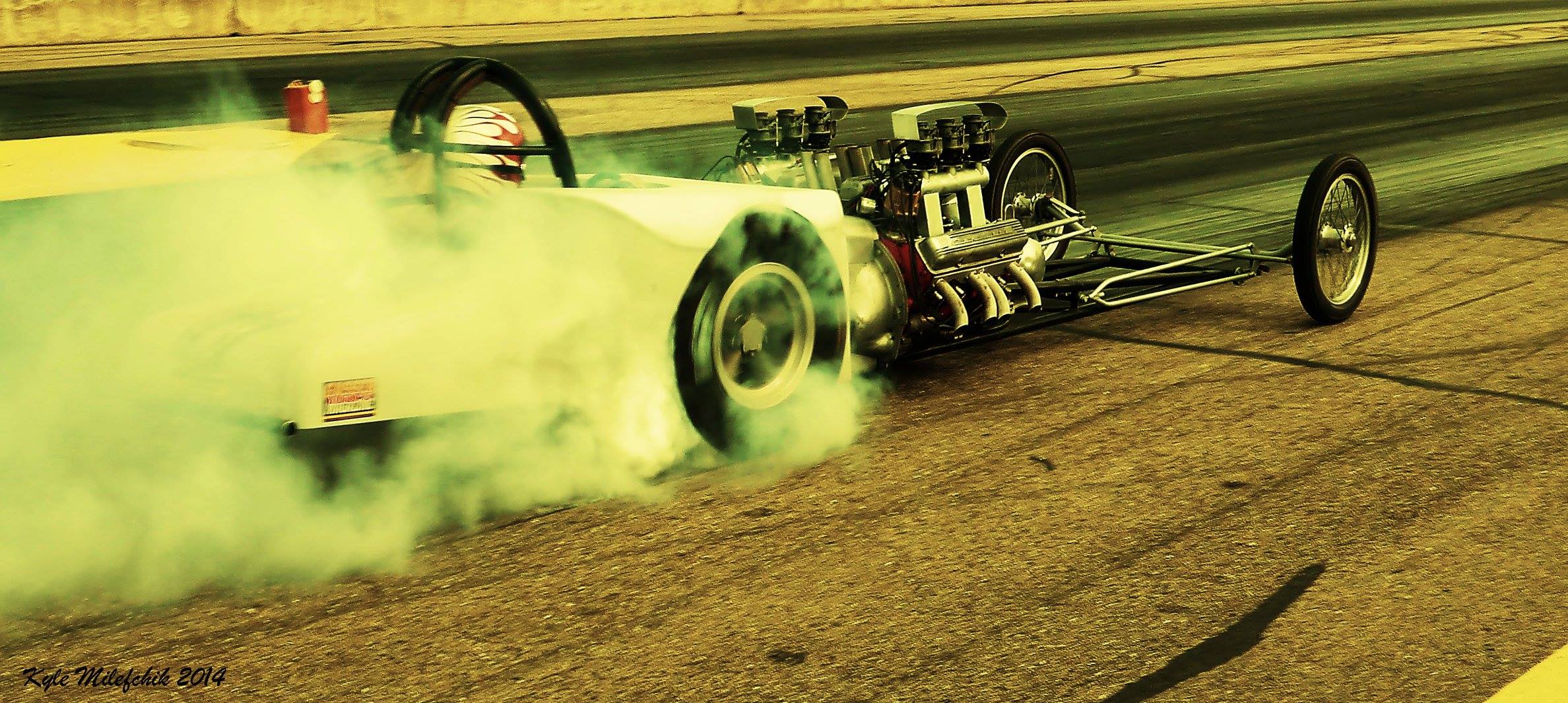

    10459067_1607256209500678_5690454956182138711_o.jpg 10549212_863451586999903_1394264478164019090_o.jpg 10557085_10204042702124887_6651577945356410302_o.jpg 10566138_863783040300091_2021770168_o.jpg 10578696_863784710299924_322354309_o.jpg 10582941_10204042604922457_3325081093387209956_o.jpg meltdown-drags-2014-gasser-chevy-ford-031.jpg Twin Byron2.jpg On track shots!

  28. cowboyinachair
    Joined: Nov 17, 2010
    Posts: 352
    cowboyinachair
    from colorado
    nice need more smoke

    Yes....3:70 gears on in order :D
