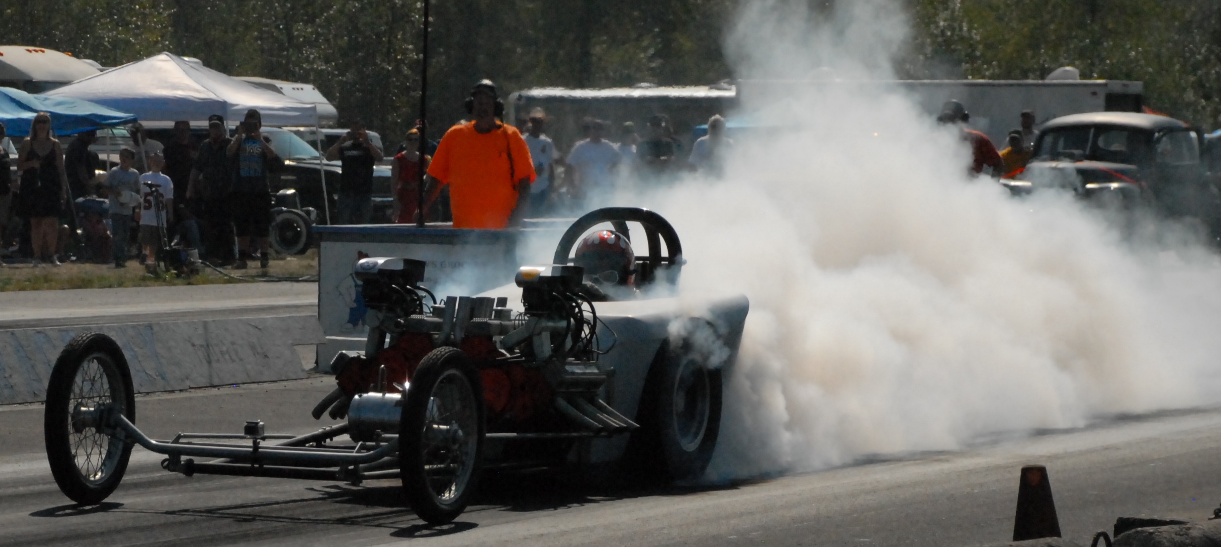

    What a great time @ Riverdale Raceway in Toutle Washington! That is the straightest run of the day :D

  17. loudbang
    Posts: 40,346
    Just like the real old days smoken them up all the way down the track.

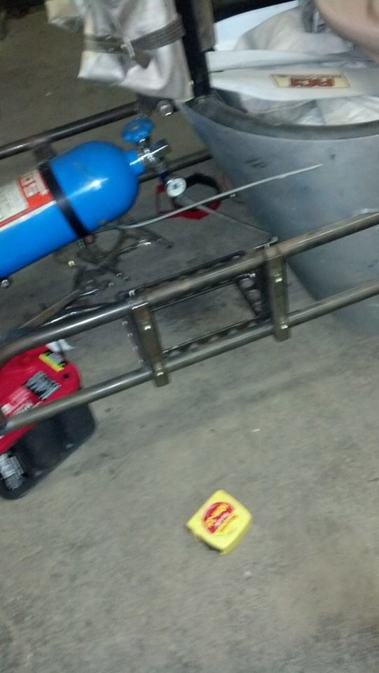

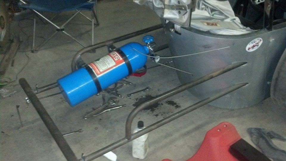

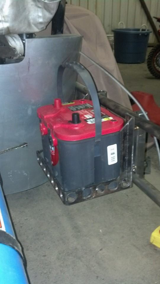

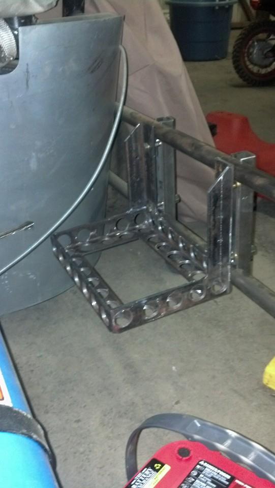

    Latest changes..................the Twin requires 24volt to start, we've been using a jumper battery in series with the one mounted under the rear end that supplies power for the ignition and recently added NOS. To make it easy a second battery will be mounted in the "trunk".....eliminating dragging around the jumper. The additional weight will also help with forward bite while smoking the tire......my hopes anyways :D

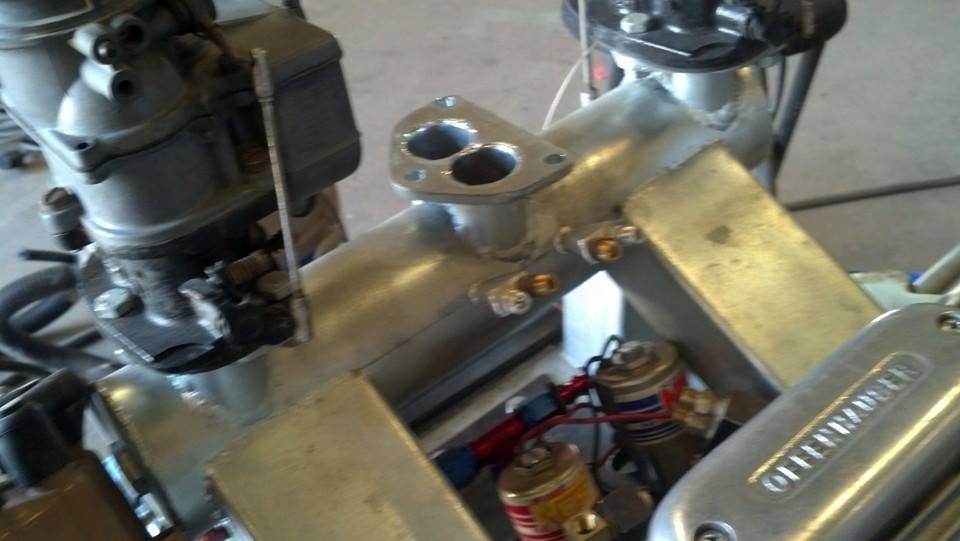

    billetproof 2014.jpg Yes that is a NOS Bottle (Thank You Chris! :) ) you see...................after thinking about engine builds I came to the conclusion that no mater what I did I was only going to have 450 (approx.) CFM on each engine. I'm partial to my intakes and didn't want to change them so I went non-traditional. With the Turtle beck I now have space for Junk in the Trunk! Each log manifold has 2 nozzles in the center spraying outward toward the runners, We started with 100HP ea engine at Byron then cut them back to 75 hp................so far it's worked Great with 6 p***es under our belt.

    How you going to keep them charged or how easy is it to get to them to hook up a charger all the time?
