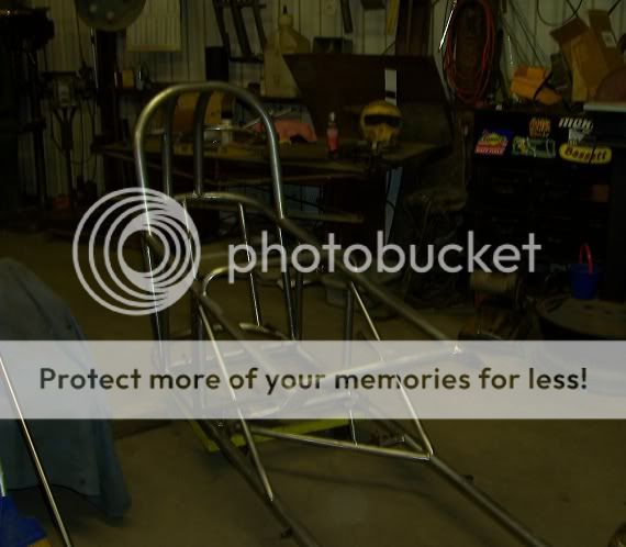

    Time for some progress photos, Eagle Field event is just over 2 months away and I have some Car Show commitments so I finished fitting the Helmet, Kidney and hoop upright bars.
    Lining all the bars up was the biggest obsticle, nothing worse than looking at it and they are not simetrical, I started with a Tape measure, than used a level but ultimately went with eyeballing it :D

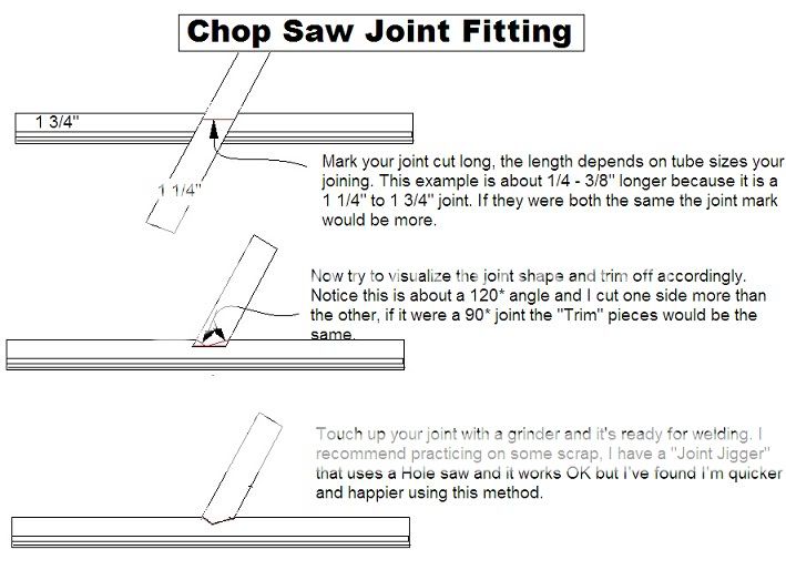

    I have a hole saw joint cutter but I've learned to use the chop saw with success and I'm happy with the results. Here is a brief description of my method.

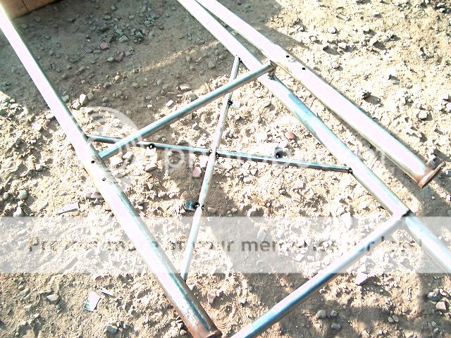

    My friend Roseville Carl sent me these "T" clamps and I copied the mounts he made for his Digger. Tanks gonna be the icing on the cake, I may have to rename the car the Lembke and Phillips Twin :D
    That's all for tonight, tomorrow I hope to have all the bars welded in and primer the beast!

    Looks good rocky , I like the tank straps carl made , Now I know how I'm gonna do mine Tim

    BrerHair
    Cool tube cutting there Rocky. Never seen that. Cut it a hair long and grind to fit!

    now get yourself a piece of 1/16 rubber and cut a 1/2 wide strip to put between the clamp and tank Roc.................

    He's pretty crafty for a guy that thinks the world is Flat!:D
    You'll be able to get the cuts so close that very little grinding is required

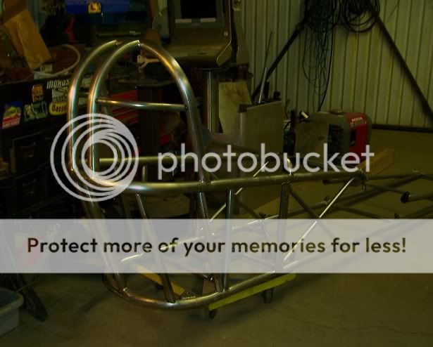

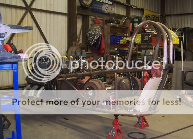

    I finished the helmet bars with the tube between the uprights, then I was struggling with what to mount the Fuel Tank to and had been wanting to ad a diagonal so I combined the 2.
    Here is the ch***is in better light.....
    We're rolling along NOW! :D

    Hey Rocky, what diameter tube did you use for the helmet bars?
  13. GaryB
    Joined: Dec 19, 2008
    Posts: 3,529
    GaryB
    from Reno,nv
    lookin good Rocky,your gettin rite after it
  14. Toymaker
    Joined: Mar 26, 2006
    Posts: 3,924
    Toymaker
    from Fresno,CA
    1" X .120" wall

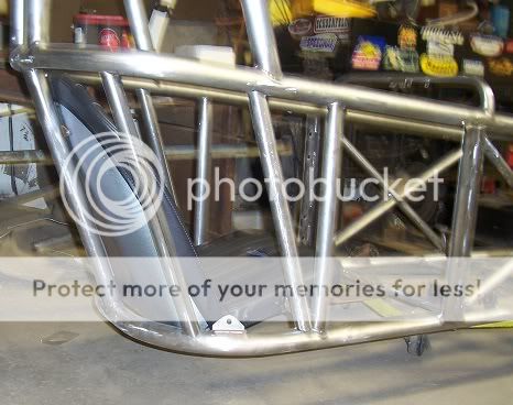

    Remember the old seat that was 1/2 Military and 1/2 folding chair? I "Electro Plated" it and had my friends at Cal Fast upholster and it looks perfect! Sorry about the quality of photos but here it is.............
    BEFORE
    AFTER
    Working on finishing the body and mounting it then we weld everthing and paint it;)

    fancy dancy seat there fella

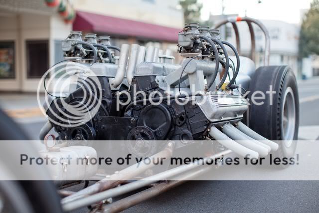

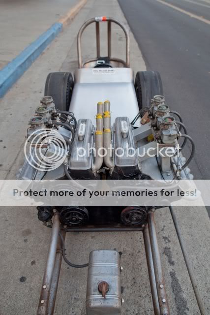

    Here's some photos my friends at hotrodcoalition.com took in downtown Fresno, thank you Anthony!
    Drivers view..........
    Nice overhead............
    Some detail that told me it was time to clean it up :D
