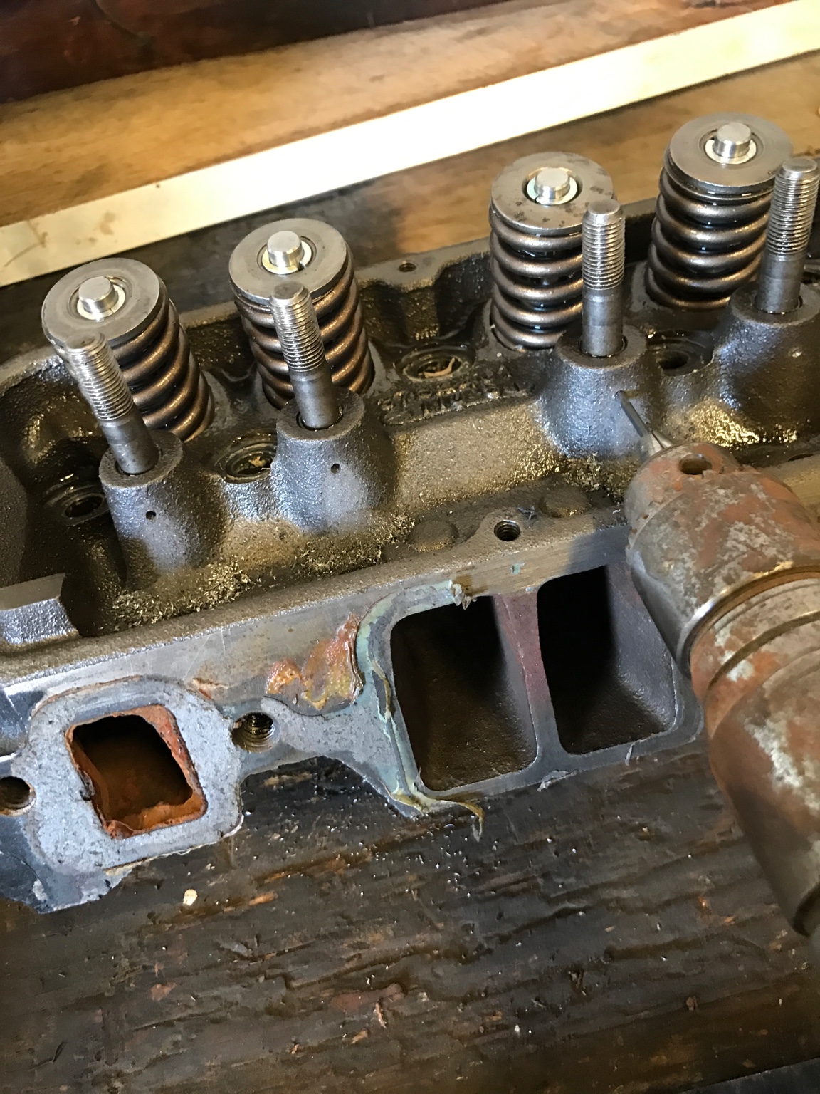

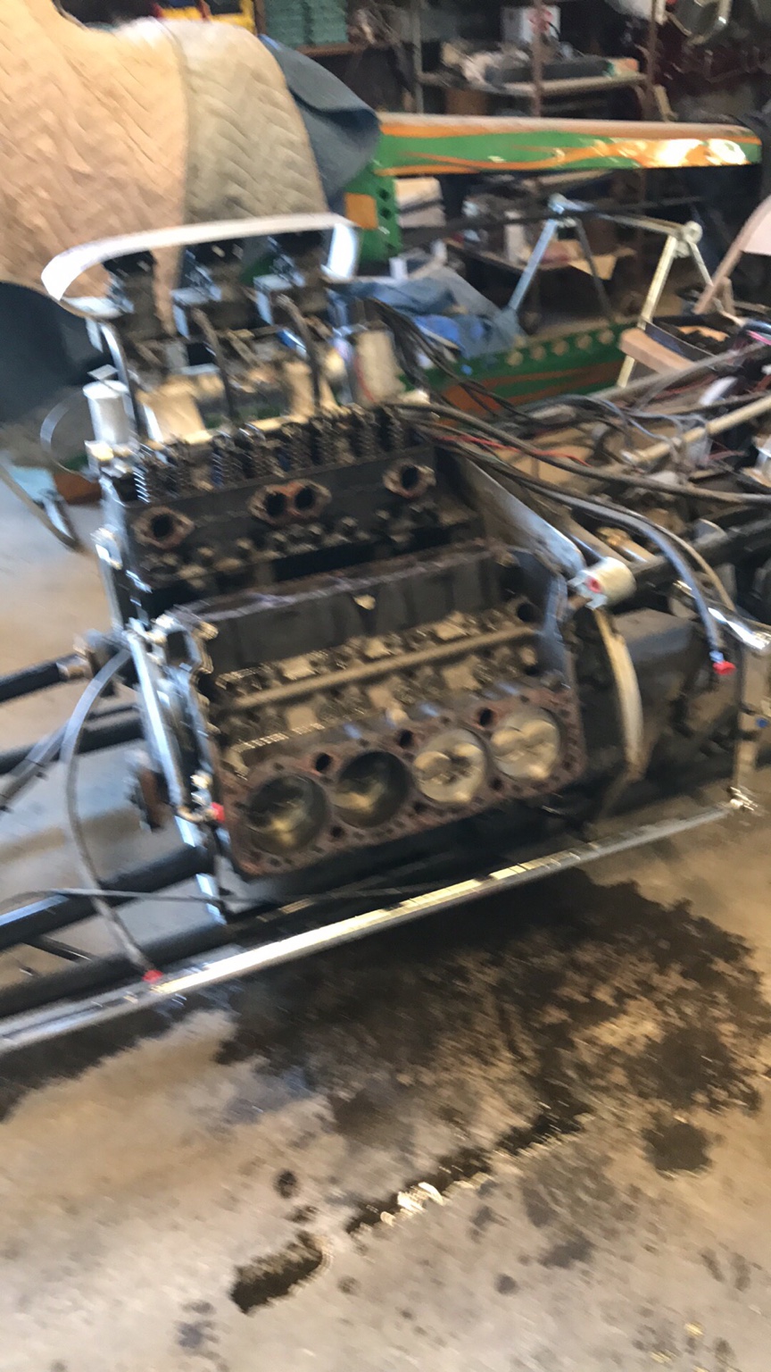

    You gotta' pin the studs Rocky. Isky used to sell the pins, and loan a drill and reamer. Screw in studs are good, but a lot more work, and expense.
    loudbang and Toymaker like this.

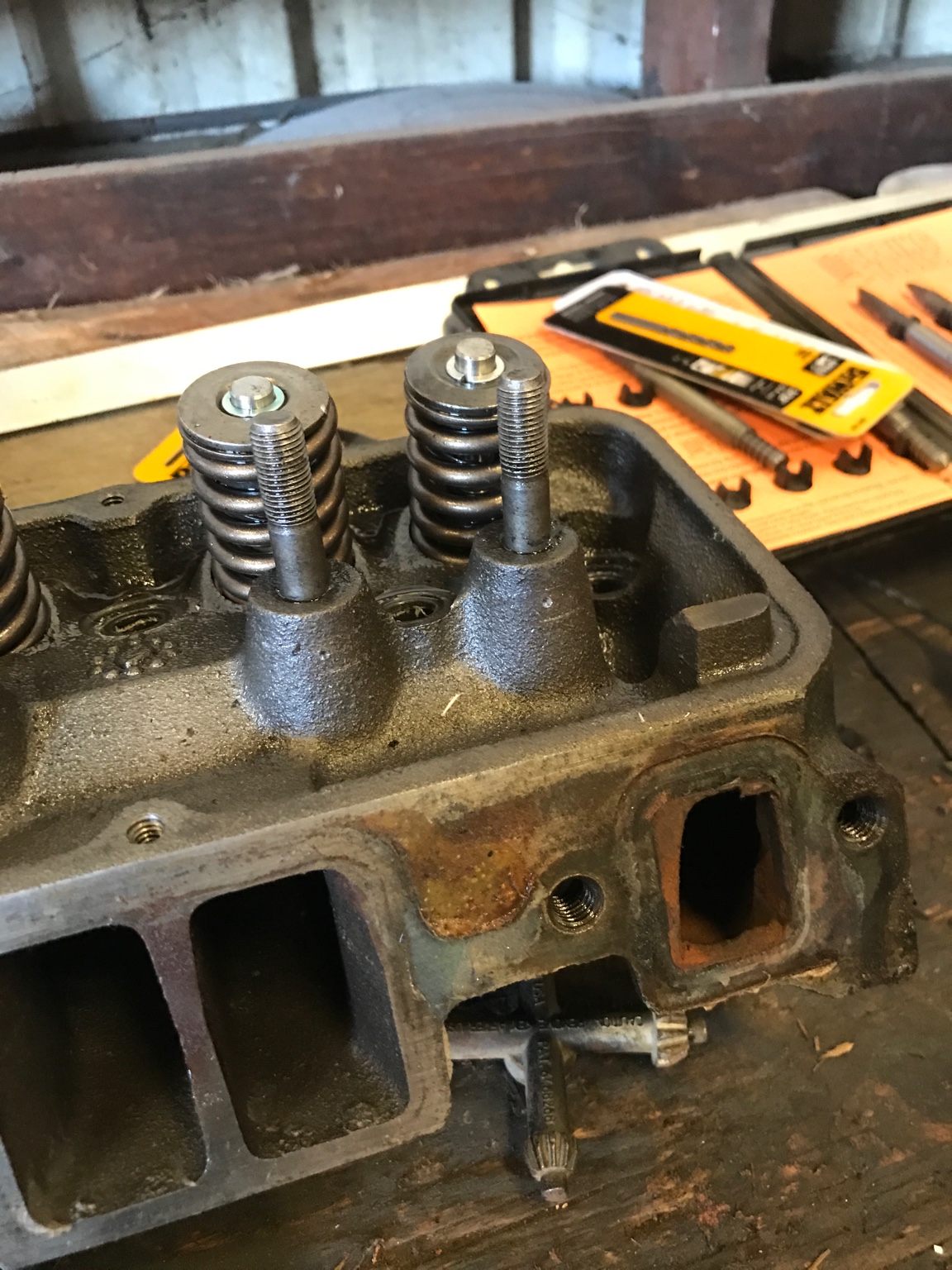

    Drilling Rocker Studs, using 3/32 Spiral pins.....found one box left in Grainger's system[emoji6]The Twin was built using History!

    Less than a minute per stud[emoji6]

    I'm tellin' 'ya Rocky, nothing wrong with the old ways!

    How well and easy is the pinning of studs? Will it work as well on Ally heads.
    Toymaker likes this.
  15. Dean Lowe
    Joined: May 20, 2008
    Posts: 22,042
    Dean Lowe
    The fact that Rocky did it so quickly, with hand tools, should tell you it's pretty easy. It works in any heads with pressed in studs.

    I've done it only one time before on my 302 Ford that runs a .525 lift solid lifter cam and have had no trouble[emoji6] Mr Gasket sells a kit but it uses 5/32 pins.....I more comfortable with 3/32 Spiral pins, leaves more stud material.
