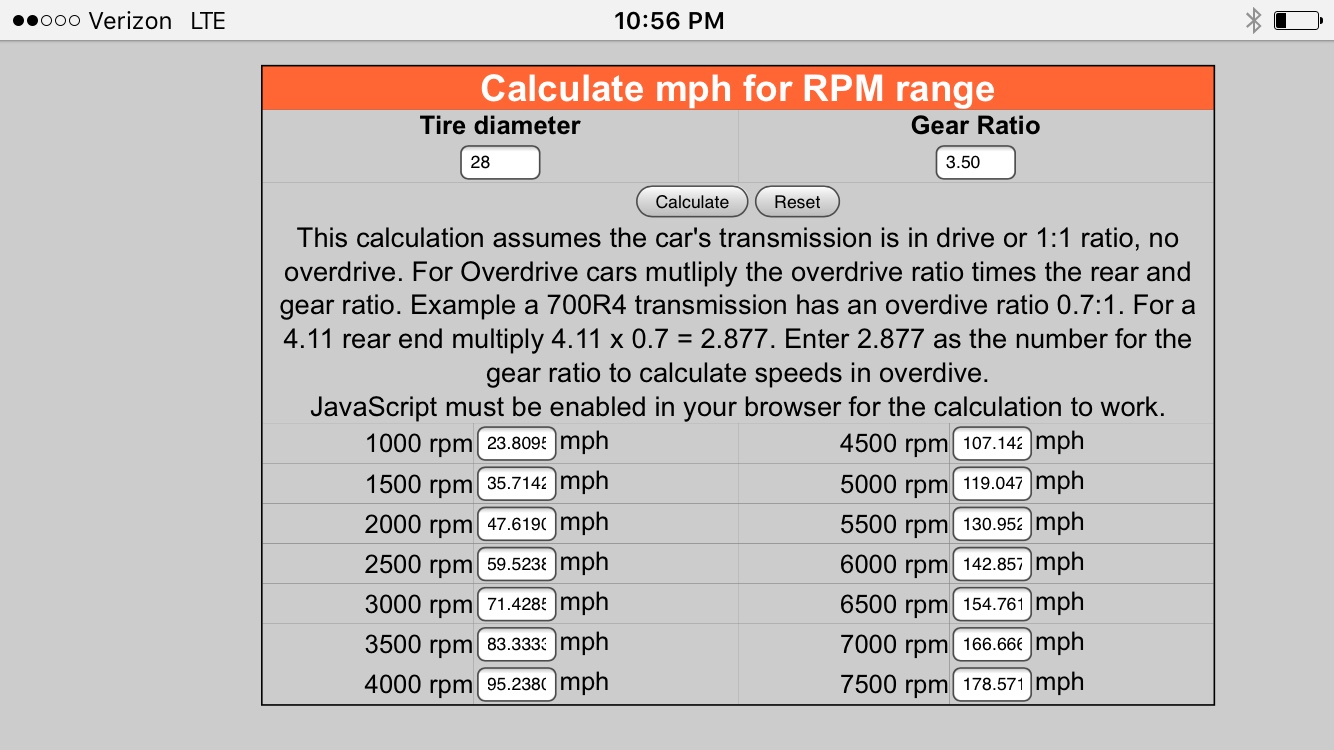

    Great times at the Meltdown! Didn't smoke the tires but got some numbers to calculate info I've been wondering about.[​IMG][​IMG][​IMG]
