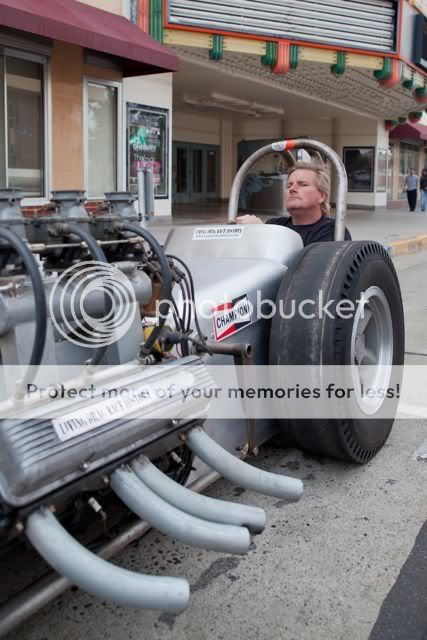

    I'm no Tom Hanna but I'm pretty happy with the TWINS Body progress. Down to the last of my aluminum which a friend gave me off a trailer that had been damaged. Just made it :D

    damn that looks good roc

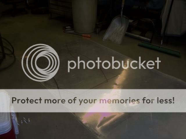

    So what did you do for patterns? Posterboard patterns?

    I love that drivers view - you should duplicate that with a dragstrip background. Maybe at the HAMB this year? :cool:
    Such a killer build!

    You may not be Tom Hanna, but you are building one fine looking digger! Almost too bad that all of that aluminum will be covered up with the bucket. :p

    Everthing 'cept the rear was done with measurements and bent 1 shot, the rear I made a cardboard pattern, cut the piece big and trimmed to fit.

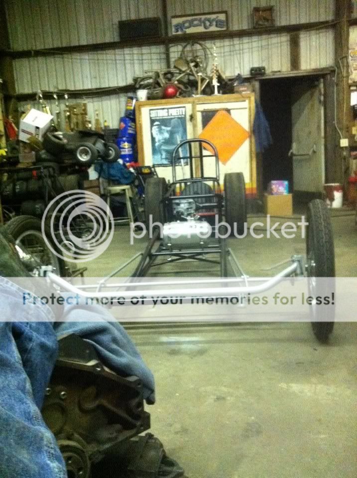

    Thanks Chris! The ch***is is fully welded and the body is done less some removal of paint and stickers (the aluminum was off a Nascar trailer my friend pulled at one time) that need to come off. After some paint and pick up the rear end housing that's getting powder coated I can start putting the pieces together. This week I'll start on the 350 that I'm putting in place of the 307 that resided in the LH side.

    This week/weekend has been good. I painted the ch***is with rattle cans and @ .99 (lowes) it only cost $8 :D and I can touch it up.
    My son jokes with me that I finally had something powder coated, the rearend housing cost $45, it looks *****'n and should resist the wear and tear of getting in and out.
    After installing the rearend housing I had to fit the side panels.........
    With that all done I put all the pieces together and added my (painted);) aluminum drums.
    Mounted the battery and ***embled the front end and we have a roller!

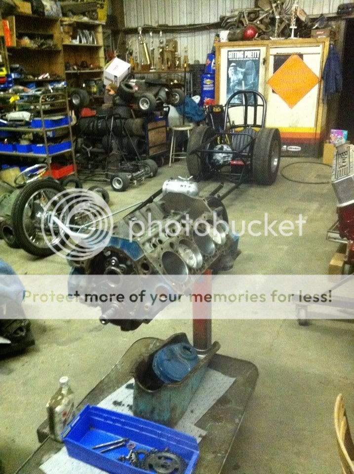

    Now I have to get the engines ready. When I pulled the heads off the 307 I found the EX valves had been "Kissin" the pistons, luckily no damage to the camshaft. I never thought that .480 lift would interfer but I'll be checking the 350 when I ***emble it:eek: The goal is to have it together by next weekend for a local car show so I'll have more regularly! Rocky

    Here is the 350 Stormy Byrd gave me (fresh rebuild:eek:) that is replacing the 307..........I'm getting excited!
