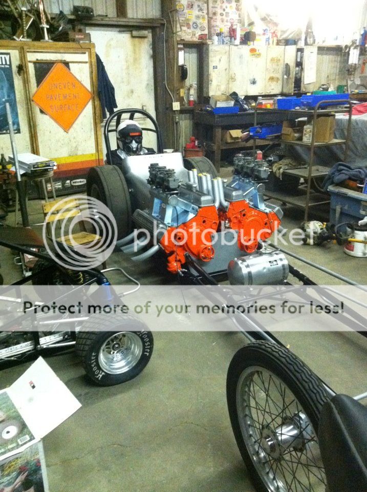

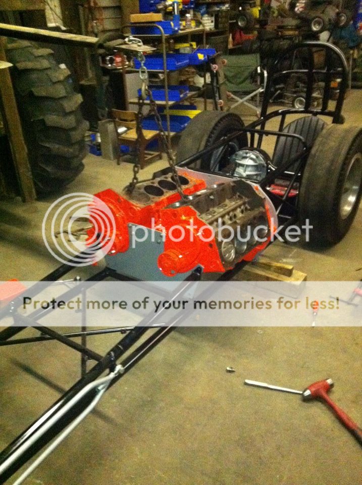

    Engines and Engine Plates are painted and put together, Chevy orange awt to set it off nicely!
    Then the business end, had to position the replacement 350 on the LH side and after seeing some marks on the rig gears that showed me it was too tight I moved them apart. New clutch is really nice, too bad it's covered up:D

  8. nexxussian
    Joined: Mar 14, 2007
    Posts: 3,237
    nexxussian
    Looks *****in. :)
    What's all the stuff on the floor in the foreground of the pic of the "business end"?
  9. Toymaker
    Joined: Mar 26, 2006
    Posts: 3,924
    Toymaker
    from Fresno,CA
    Tim, I can remove some .015 shims for wear but I'll have to remove the bellhousing for that. Thank you for your offer though.
    HaHaha, you noticed the "Beer Can" shims I ran between the flywheels to get the engines further apart before reaming the dowel holes in the LH block.

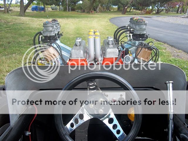

    rockey,
    after looking at your intake the inner runners are shorter then the outeres so I figured you may have had a lean problem on one side? I was just wondering after you tore down the engine and did an inspection did you find the intake manifolds evenly distributed the fuel/air mix or did you find any indications of lean conditions on different cylinders? just curious
    Paul
  15. vrod64
    Joined: Jul 8, 2008
    Posts: 630
    vrod64
    from Katy,Texas
    Looks great Roc.
  16. If you are thinking running in SCTA You need to come out and spend some time at Elmo with us this year, hell come on over to Bonneville with us in Aug. I've got room for one more crew member on Jake. ;) It'll be a blast!
  17. Toymaker
    Posts: 3,924
    Toymaker
    from Fresno,CA
    All the cylinders were real rich, so at this point it's hard to tell. The runners are equal although the logs are tilted, here is the measurements I came up ith when I made it.

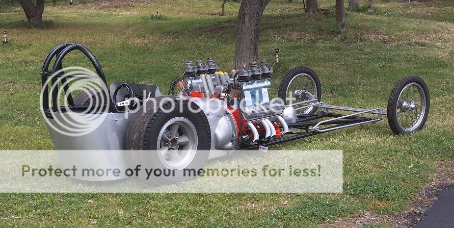

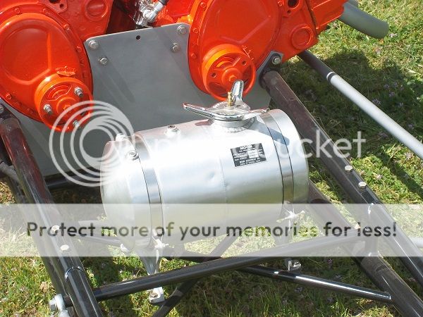

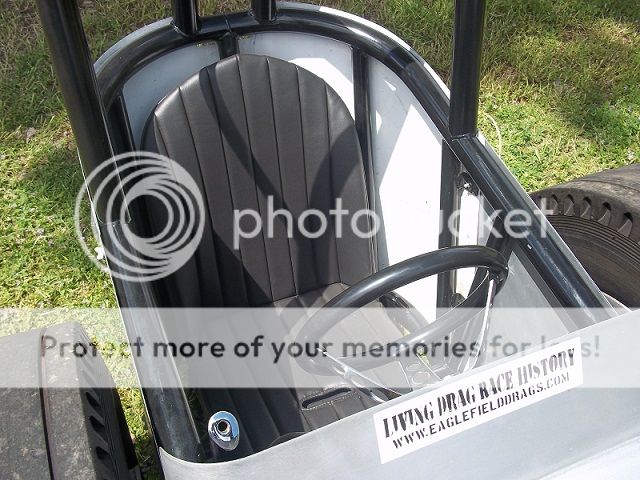

    I had plans on attending one of the biggest car shows around today but the weather had me worried and I didn't want to take the TWIN out in the rain. After I was sure of good weather I pulled the TWIn out of the shop to take a few photos. After the photos I fired it up and had some ignition issues, cleaned up the points, added a ballast resistor, set the dwell and timing and man all I can say is its sounds SOOOOOO much better with two 350's! I cannot wait to get the clutch pedal dialed in and drop the hammer on it!! :D
    The plugs miss by this much!
    Chromed the Brake Handle!
    5 Spokes are forever!
    Thought I'd never have a MOON Tank, especially with the Tr-Bar cap!
    I admit it aint real ***y but it is how I think I would of built it in late 59!
