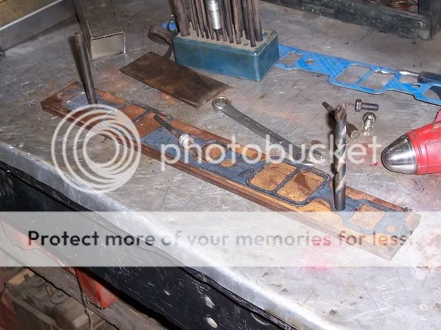

    You probably know this already but you are going to have to weld up the side of the carb to log tubes or else you will get a vacuum leak at the base of the log. Eaiser to do it now then later. I would go with silicon/bronze and not only up the tube but around the bottom of the base for support. Otherwise lookin good!

    I'm gonna have to keep up with Carl:D Tonight I started on the intake flanges with 1/4" x 2 1/2" Steel Plate and transfered the holes from an intake gasket......
    Drilled out the pilots and checked the fit..............
    You can see the corners of the intake ports thru the holes........
    My first 2 runner tubes came out a little short but no problem, more where that came from. The material is 3" x 2" by about .065 wall and I don't plan on dividing the runners at this time, much like the old Crietz intakes. If it's a problem I can add a divider in the runners later..........
