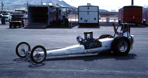

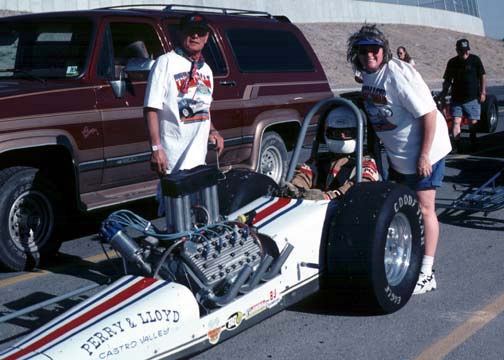

    Hi Toymaker-----My wife Kathy and I have run the "Perry & Lloyd" Flathead Fuel Dragster since 1985. I dont know how to post a photo on this thread, but if you Google Perry & Lloyd Flathead dragster there are a few photos. The car is currently NHRA certified, and we hope to run the Dragfest at Bakersfield for our next event. I tried to send you a message earlier, but I guess it got lost. What I wanted to say, was use a 9" posi rear, it will make your life better moving the car around the shop and in the pits. Tony Lloyd

  24. 38FLATTIE
    Joined: Oct 26, 2008
    Posts: 4,349
    38FLATTIE
    from Colorado
    Tony, here's a couple I posted for Ya!

    Thank you 38-Flattie, for posting the pics. There is a real good photo, taken by Robt. Brooks of our car at the Std-1320 Invitational at Inyokern Dragstrip in 2005. Tony Lloyd
