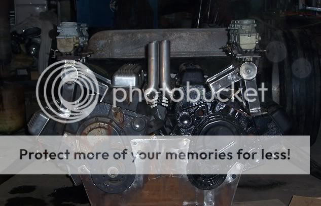

    Thanks Mike! I have both the Intakes tacked together and all the carb pieces sorted out, still a long way to go but making progress.

  18. i found the best way to get the flow and the pressure to stay at 2.5 psi is to use a a return line and install a holley regulator on it
  19. Looks great Rocky! What are you gonna cover the valley with? I ***ume you have a plate made or duct tape?
    Don, I too have all sorts of pressure problems using 94's on my FED, I use one Holley type regulator, set it at 3 psi and the next thing you know it's at 8 or 9. I've just learned to live with it by fethering the throttle when pulling to the line and when it's wide open fuel doesn't seem to be a problem. Never thought of two regulators.
