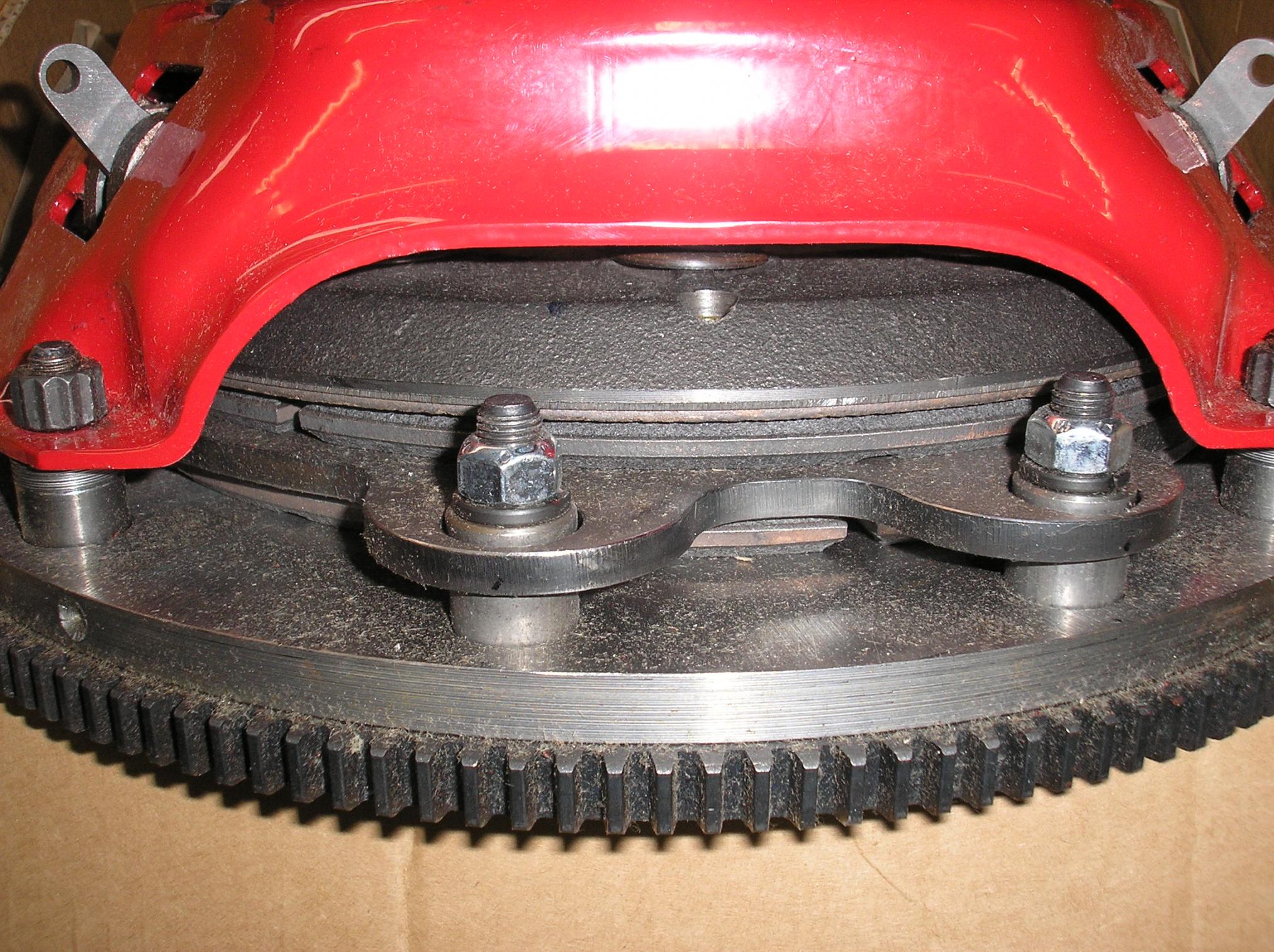

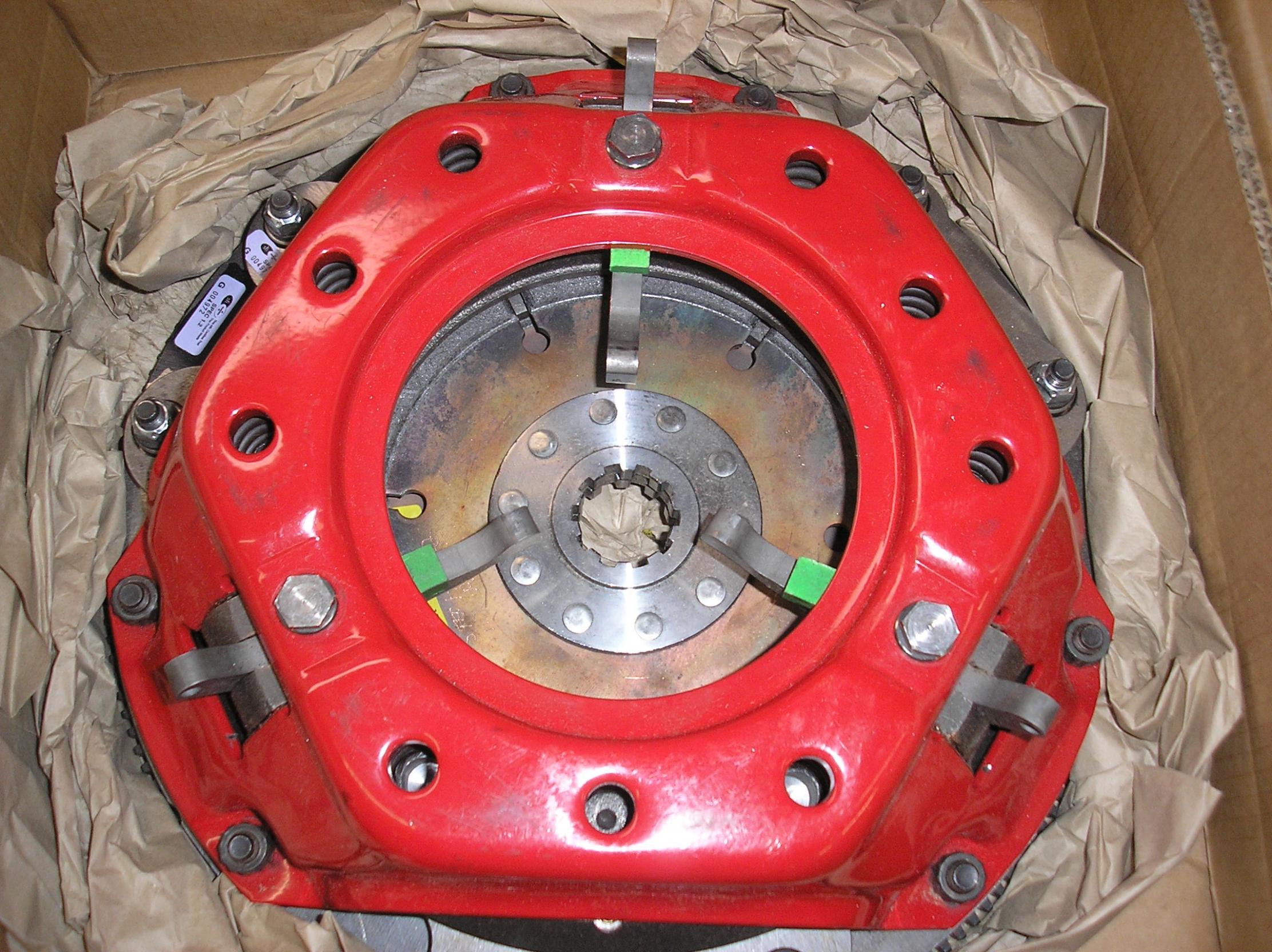

    Hi Toymaker....Progress is really looking good. The one and only time I drove the FH/J twin was on a clutch test day, at Sacramento. The clutch man said that we couldn't make enough power with Flatheads, to hurt his single disc clutch. Needless to say I drove through that clutch, and to make sure, I kept my foot in it till half track, I didn't want to actually blow pieces of clutch all over the place, and hurt the new car (or ME). But I did make a statement to him. I wanted a twin disc Sintered Bronze flywheel & Hat, steel floater, & Iron discs. Be careful, even if you just want to smoke the tires, you WILL need a good twin disc clutch. You may call Brenden Murry, Performance Motorsports, San Jose, 408/266-3324, pager 408/977-5533, who may have an old Schaffer twin disc (1-floater) for a chevy. Be safe, you are gonna make a helluva lot of power. One injured spectator, would end this super fun way to play with our hot-rods. Brenden, will probably have a used hi-gear shaft, and coupler to connect to your 9" for not much money. He is not a crook, and easy to work with. He is also a long time Nostalgia racer. Tony Lloyd

    Thanks Tony, I was planning on talking to Brenden at Turlock if he still goes. The car will have Blowproof Bellhousings with SFI Steel Flywheels and I'm pretty sure that an 11" clutch cover with a Ceramic disc should hold it and I'll test it before the event. Eagle Field has the traction of a parking lot:D, something I have no plans of changing.

    When I built the Ghost I spent alot of time on the phone with clutch people. NONE of them wanted to, or could do the old school 2 disc floater plate, long style clutch deal.
    The most helpful was a Crower tech guy.
    Everyone wanted to sell me a billett piece for like $2300. WRONG
    Finally called McCloed. I already had a billett steel flywheel. So sent them my flywheel and they machined it to accept their floater stands, Bolts etc. This is the old way, long style clutch pressure plate. With sintered iron discs. Mine is set up as a lock up clutch. It is the ONLY SFI sticker on my whole car. But in my opinion the most important.

    That's good info King, I've been talking to Elmer Snyder who ran Top Gas back in the day, he ran as quick as 7.60 with a single disc Ceramic material clutch. I have been cosidering using a very short Ford 3 speed box I have that would eliminate the cost of a "Candlestick" and give me some gear options and reverse but I dunno yet.
