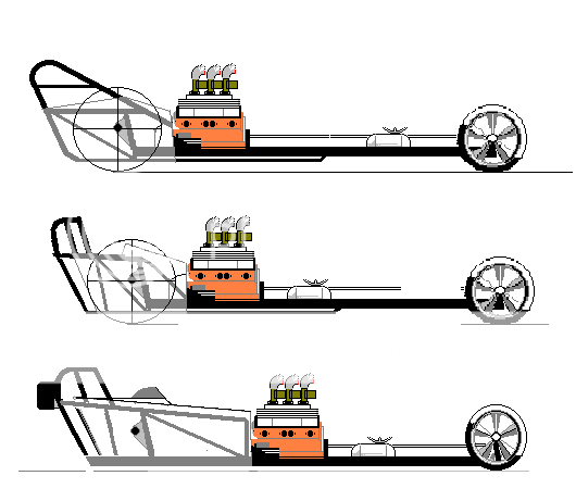

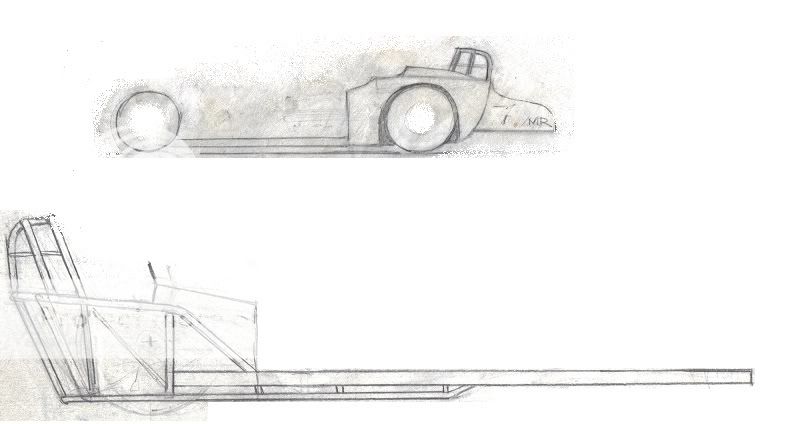

    Thanks for the feed back guys, I got the fever bad! A couple of drawings, one off my desk pad at work:D:D

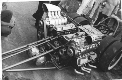

    Ivo's 4 engine car's oil pans.
    Issues to consider is how to keep the gears lubricated and since the contact pattern of the gear teeth is small, any track or tires with "BITE" will rip the teeth off do to the load.

  8. Very cool Rocky! I'll be watching this thread. I was thinking a couple of years back about a twin but inline sixes, I like Y-Blocks but two 223s would be neat. Maybe after the LSR Uni is done we can get one togeter and run you at Eagle. :D

    Dean, the Fiat would be awesome however I really prefer the Modified Roadster look, and damn if I didn't miss one right here on the HAMB, and it was FREE! I think a T body would help cover the "Wideness" (if that's a word) of the drivers compartment. As far as lubricating the ring gears I'm gonna give it a go dry, maybe with some high tac grease like a chain lube as the engines won't run very long at any given time, if there is a problem I'll look into somesort of coating. "O" and don't worry about bite, Eagle Field don't have any:D
