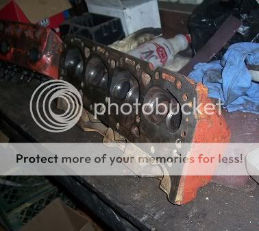

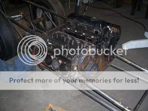

    Kinda got stalled after the March Meet, even robbed some parts from the Twin but were getting back on track. I had to remove the small chamber heads off one of the engines for our other Digger so I drug some "461's" out from under the bench, cleaned them up and cut the guides down for Positive seals. I found I'm going to have to make an oil return line off the heads to help get the oil out of the valve covers and the positive seals will help with oil control or lack of:D

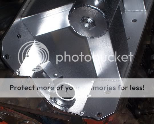

    With Eagle Field closing in I've had to change my goals to have the car running with the Strombergs so my first step is to finish the intakes. With the runners, mounting and logs all attached I cut out the valley cover out of 10g metal and tach'd it to the intakes while they were bolted to a mock up engine using gaskets. Next I'll quickly braze the seam to seal it up, then work on the distributor mounting.

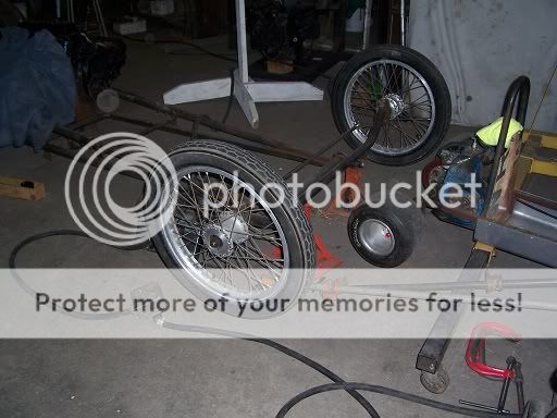

    With our HAMB Dragster in the hands of my Good Friend Joe Roseberry and needing it's front wheels and tires we bought a set of 17" for our Logghe Car and I put the 18" on the Twin. I think they represent the era perfectly.
    Plans are to get it running real soon and post some YouTube videos! Rocky

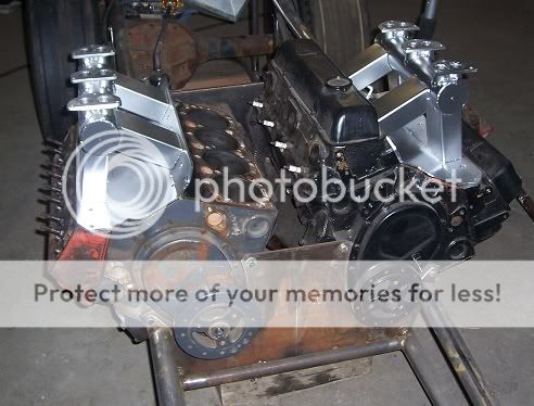

    After a long weekend of "Match Porting" steel runners, shaping the ends, and fabbing distributor mounting the intakes are done!!!!
    A big Thanks to Carl who helped out on this project making the task easier. I took alot of photos but I can't believe I forgot the memory card:( These suckers were alot of work and I'm glad they are where they belong! Rocky
