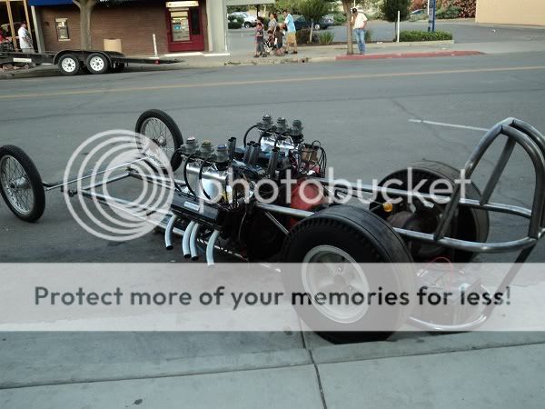

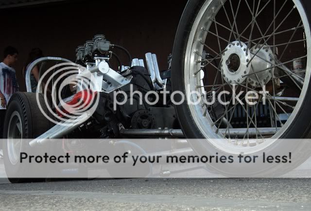

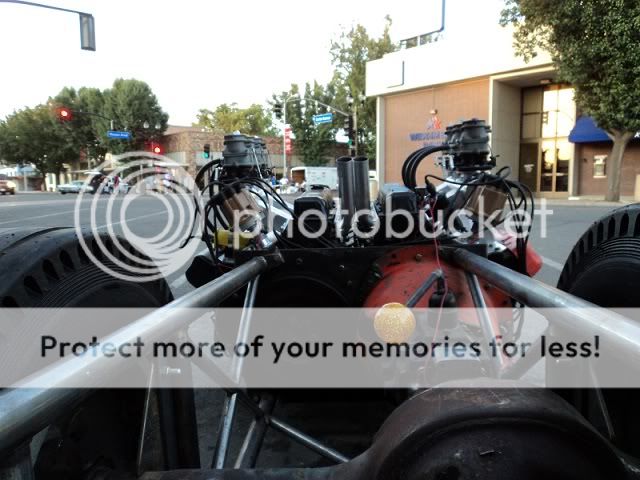

    Thanks Guys, here is some stills from Dos Palos.

    Congratulations! Sounds good. I expected to hear some whining from the meshed flywheels...but really didn't.

    and the stills look good also, man is it neat Roc

    The ring gears add a whole extra harmonic to it.

    This is too trick. That jewel fired first crank.
    How hard was it to get all those Strombergs tuned in?

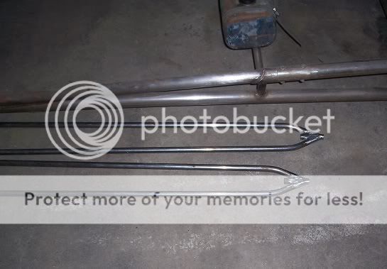

    Man, my friends Skip, carl and Tim are all hammering away and I haven't been gett'n anything done! I Finally purchased the SFI Steel flywheels I needed, removed the ring gears and now need to make a trip to have the Machine Shop machine them to accept 2 Ring Gears. Once that is done I'll have Lee TIG the gears to the Flywheels, put short welds evenly spaced. A good friend of mine gave me a new McLeod Cover and Sintered Iron Disc to run and I think it will hold as I plan on "Blowing the Tires Away" and releaving stess on the clutch, we'll see:D
    I also started on the "Hair Pins" for the Front end , give me something to do while waiting on $$$$$$
    Meanwhile she just sits and waits for attention, I'm taking her to Gustine this weekend then i can take her all apart to finish the Bellhousings, Flywheels, Oil Pans, Ch***is, order axles, get the "Pumpkin" ready, Brakes, Steering, on and on and on:D October 8th will be here quick! Rocky

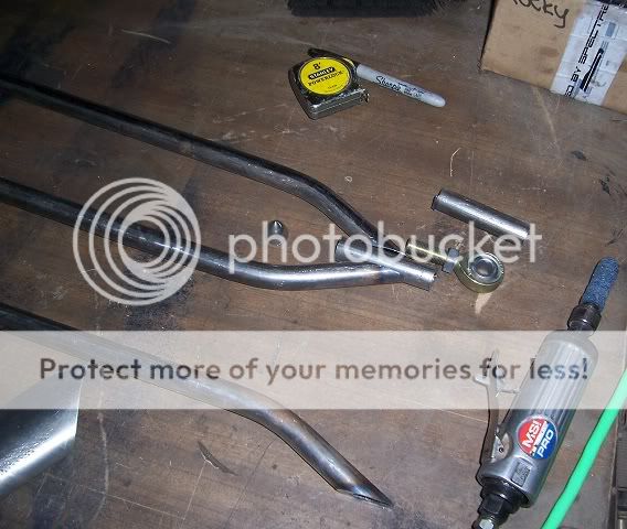

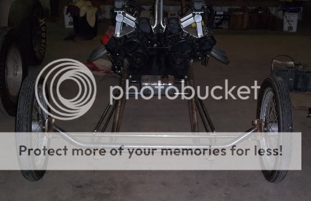

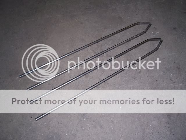

    "Hair Pins" and brackets are done and waiting for my son to weld them up, I couldn't wait and welded the Hairpins with the mig but Lee will Tig the rest.
    The rear mount is a "Stub" that goes thru the upright and into the x-member.
    I really happy with the look, a Radius Rod would of worked but the Hair Pins are the look it needed. Although not an issue with my as there is no front suspension, the "Torsion" arms would have to be slotted for the bolt that that holds them to the axle to eliminate binding.
    Blew the rearend apart, took the measurements and ordered the axles today as October 8th is getting close.
