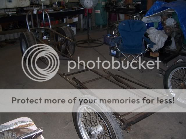

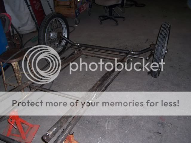

    The Labor Day weekend has been great and gives me a good feeling about making a p*** or 2 at the Eagle Field Hot Rod Gathering October 8th.
    The Dual Ring Gears were a little bit of a pain but I finally got them on with the teeth aligned.............
    This photo shows how wide the teeth are now..........
    My son Lee Tig welded (equally spaced) the Ring Gears to the new Steel Flywheels............
    Here he is in action.........
    Fitting the LH Bellhousing................
    Flywheels Installed, bellhousings fitted and awaiting aome 1/4" steel Plate to fimish them..........
    My 4:11 9" Drop Out a friend from Eagle Field gave me, looks good but in need of a good cleaning, new pinion Seal, and install a Mini Spool before it will be ready.............
    Lee finishing all the Ch***is and Front End welding, I drilled & tapped the King Pin set screw holes, greased and ***embled the spindles, and just waiting for my clutch disc to be returned with the 1 1/16" hub so I can install the clutch before setting the engines back in.................

    The Turtle Deck was mounted when I bought the body and needs to be removed, raised and reattached. I just hope I can get the body mounted before Oct 8th. Time will tell, see ya soon!
