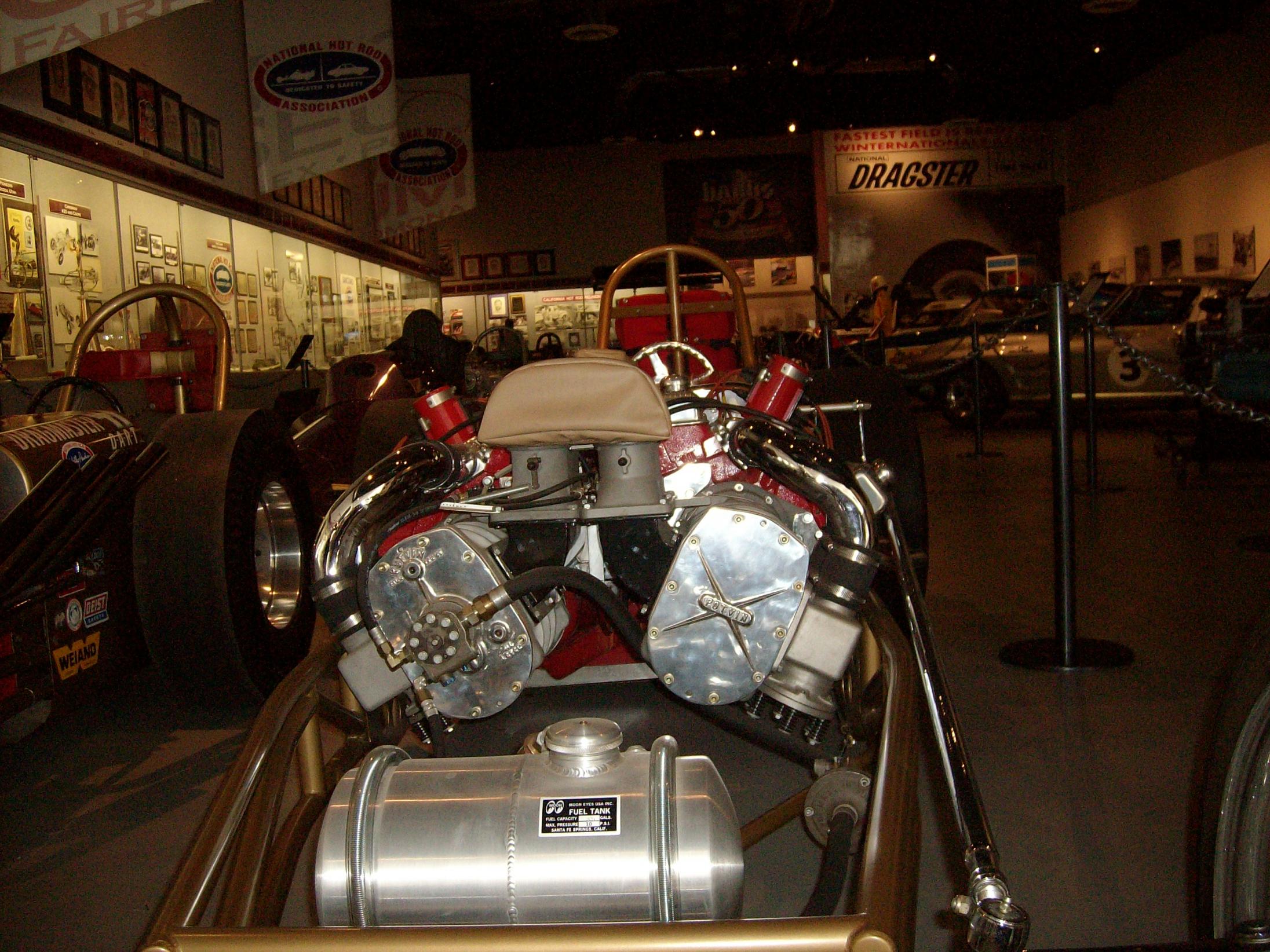

    Here's the body I missed, "O" well it is cut out for the tires more than I needed and I'm looking at another one this weekend.
    Heres some of my inspiration

    Here are a few shots of the Dragmaster car I snapped yesterday. Maybe you can get some ideas or inspiration from them.

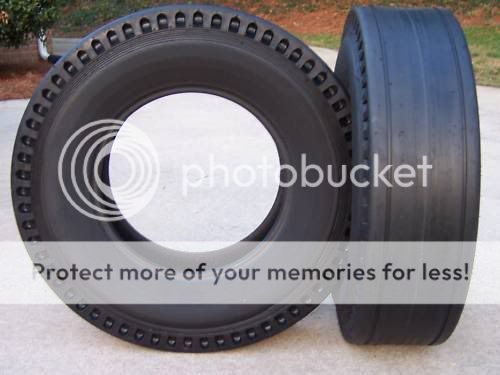

    Rich that is pretty cool but with my finances I need to learn some gl*** basics. Charlie I had thought about the vinyl cover but figured the 'gl*** would add some strenght to the body. Today a friend told me about "Starched" fibergl***, said he could get me what I need for free, anybody know about this stuff? Found some wheels and tires and they are on there way! Was going to go with Hurst tires but found these and snapped them up
    and from the beginning I've wanted 5 Spokes.
    Well out to th shop and work on the engine plate patterns.
  29. Katuna
    Joined: Feb 25, 2005
    Posts: 1,822
    Katuna
    from Clovis,Ca.
    Never heard of starched gl***, do tell. Something I had thought about too to address the body rigidity was to make a aluminum tonneau insert and cover it with vinyl. 4 to 6 dzus fasteners and it would add some strength but be easy to pop out for work access.
    Whos tires (besides "yours")?

    Towel City.
