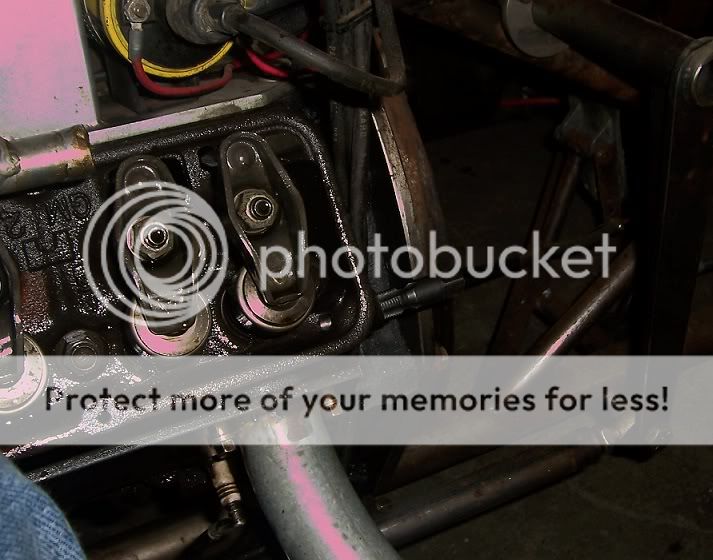

    I did recently put some Corvette Valve Covers on it and drilled the outer heads for oil return. I noticed that with the engines running the RH engine has noticible crankcase vacuum at an idle, no oil flows out when it's running. but when you shut it off the oil pours out. The "Slave" engine has pressure, making me think that as the slave fires (10 DEG later) it unloads the RH or primary engine, I dunno and it don't matter cause we're going to RAISE HELL with it Anyways:D! I'm one Corvette cover (actually 2 with one being cracked/welded and some of the fins being removed) from having that part of the build finished......anyone have one they'd part with reasonably?
    A quick note on how I removed the Corvette script (it was already drilled for smaller breathers) from my center covers. After much thought and not having the funds to take them to a machine shop I shrpened an Air Hammer Chisel and "Shaved" the scripts off.
    I wanna thank my friends Paul Scott and Joe Hickenbottom for the covers I have, Thanks Guys! Rocky

    Could you explain a little more in depth the oiling problem you are having? Nothing is ever simple, but this seems to be fascinating. Would the problem still be evident if both engines were supercharged?

    It's not really a problem, the engines lay over so much that the valve train oil (Hydraulic Cams) builds up to the valve guides before it makes the original oil return holes. I ran it like that (and without breathers, wasn't finished) and that's why I believe it smoked so bad on startups so I'm incorporating some oil returns to eliminate the build up. The vacuum (I believe) is from the main engine being ***isted by the slave engine (firing 10 degrees later) reducing the pressure on top of the piston, eliminating "blowby". I've only seen this at an idle and It doesn't bother me enough to check at race speeds:D. I would love to see what effects Superchargers would Have:cool:
