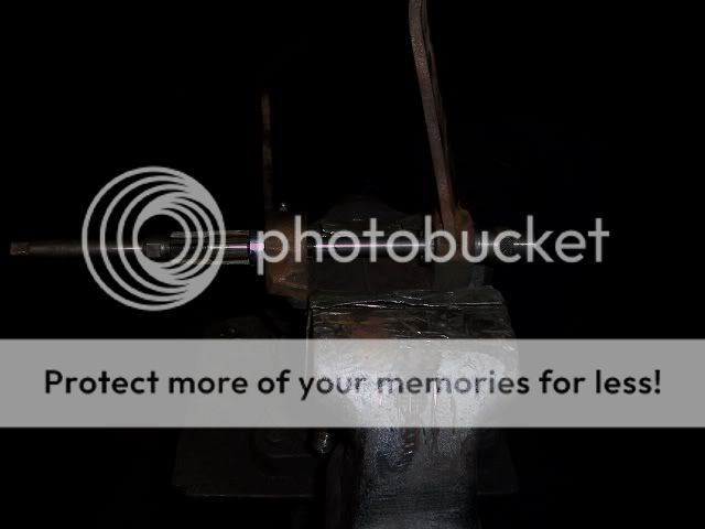

    First I made a "roller/bender" for the belly pan using the same dia material of the frame. The bender is 35" long and consists of the tube, angle iron to hold the sheet, and a handle. I'm bending .035 and the bender won't bend much more than the 35" length without help. Here's a photo of the bender and a second one will be made for the cowl using a larger tube. Once the bender was made I took a piece of s****, measured to a point and marked it, then positioning the bender on the mark I bent it 90* to see how much I would lose in a bend. With the 1 3/4 I lost 1 1/8" so with that in mind I bent up the belly pan and started t******* around the bellhousings.

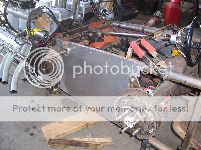

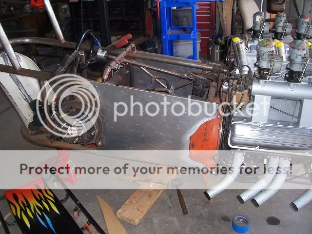

    Thanks Guys! Today I had to get after it and get the body somewhat done, I mean I have some cool aircraft fasteners and the windscreen isn't perfect and I need to redo the back but it has the early vibe I was shooting for.
    Starting where I left off was the belly pan, I trimmed and fit and trimmed and fit some more to deal with the bellhousings then riveted it (told you I was in hurry mode:D)to the frame.
    Next I made a cardboard pattern for the back and cut the piece out. This piece of Aluminum is thinner and a harder material that I'll have to relace as I want to roll the edges.
    Now back to my benders, this one is made from 3" pipe and gave me the radius I wanted. The body is a simple and like I think they would of been in the early 60's before the Great Hanna style bodies.
    I'm fast forwarding to the semi finished look with some improvements and fit and finish to be done when I take it all apart.

  10. Can you describe or show some more photos of the benders?

    Rich, I'll do some drawings and try to describe better soon. Rocky
