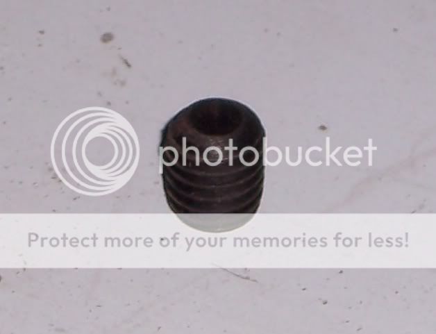

    Thanks Tim, I just couldn't bring myself to putting some steel wheels no it! Man it's cold out there, but the show must go on:D After a little thought of transfering the bolt pattern to a tempate I decided to use Set Screws put in the block backwards....
    So after cutting out a piece of s**** aluminum, removing the dowels and positioning the set screws just above the block surface I positioned my template and placed a flat punch on the template over the set set screws and struck it with a hammer...........
    The method worked great and although probably not perfectly centered this will get me to my next step of making a "Master Pattern" out of steel with holes deep enough to use a transfer punch.....
