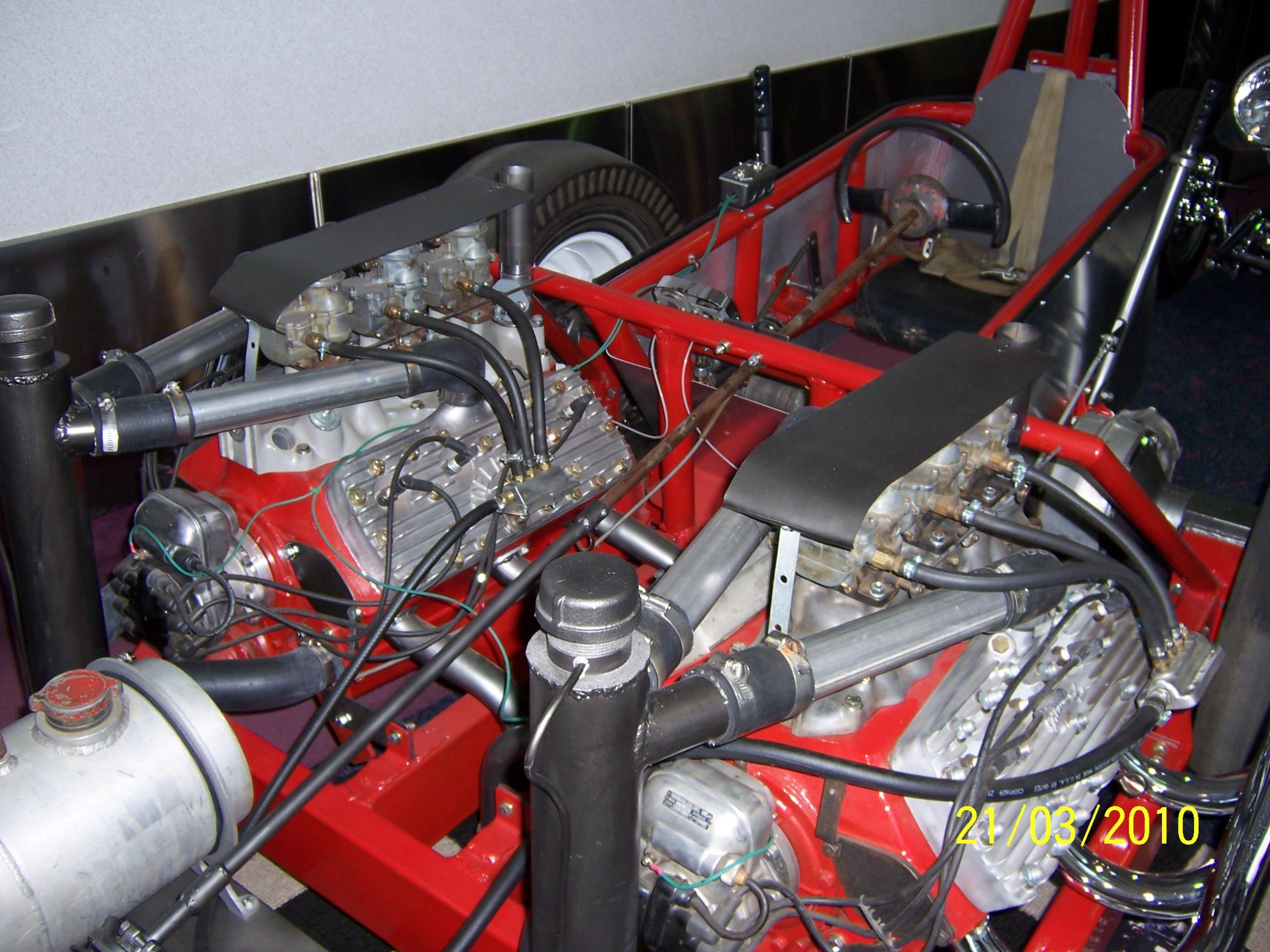

    More inspiration!!!
  5. yep, that's a benchmark, keep at it sir, sure you guys can make this happen, and with the soul to make it kick ****....;):D

    Here's one for you Carl. This was at the Fresno Autorama this year.

    On the 4 engine car the front tires did 95% of the smoke and the headers down the middle kept the smoke out of the ****pit and gave him tunnel visability.
    There are some youtube vids With Tommy talking about his mutiple engine cars. This was down at the roadster show about 3 years ago for the "Americas Car Collection" museum.and he does discuss firing order.
