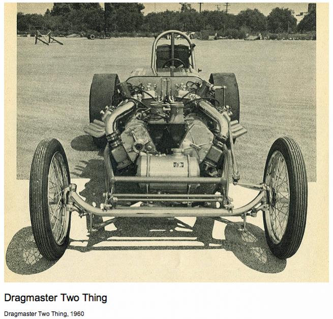

    you should give Dode Martin a shout ( fallbrook, ca.) if you need any pointers him and jim nelson are the originators of dragmaster .. Dode finished a second "two thing" last year for cackle and for the nhra museum .. ill bet he might be able to point you in a really good direction. He knows alot about everything dragracing and you will be talking to a legend.Im trying to get them out to eagle field to race thay have alot of cars.
  8. notrod13
    Joined: Dec 13, 2005
    Posts: 995
    notrod13
    from long beach
    and heres a pic

    Thanks notrod, I saw their car and it's awesome!

    Fantastic. Can you show us a pic?
  13. Royalshifter
    Joined: May 29, 2005
    Posts: 16,297
    Royalshifter
    Moderator
    Ha ha great shot of me and my grandson....Caleb.:)
