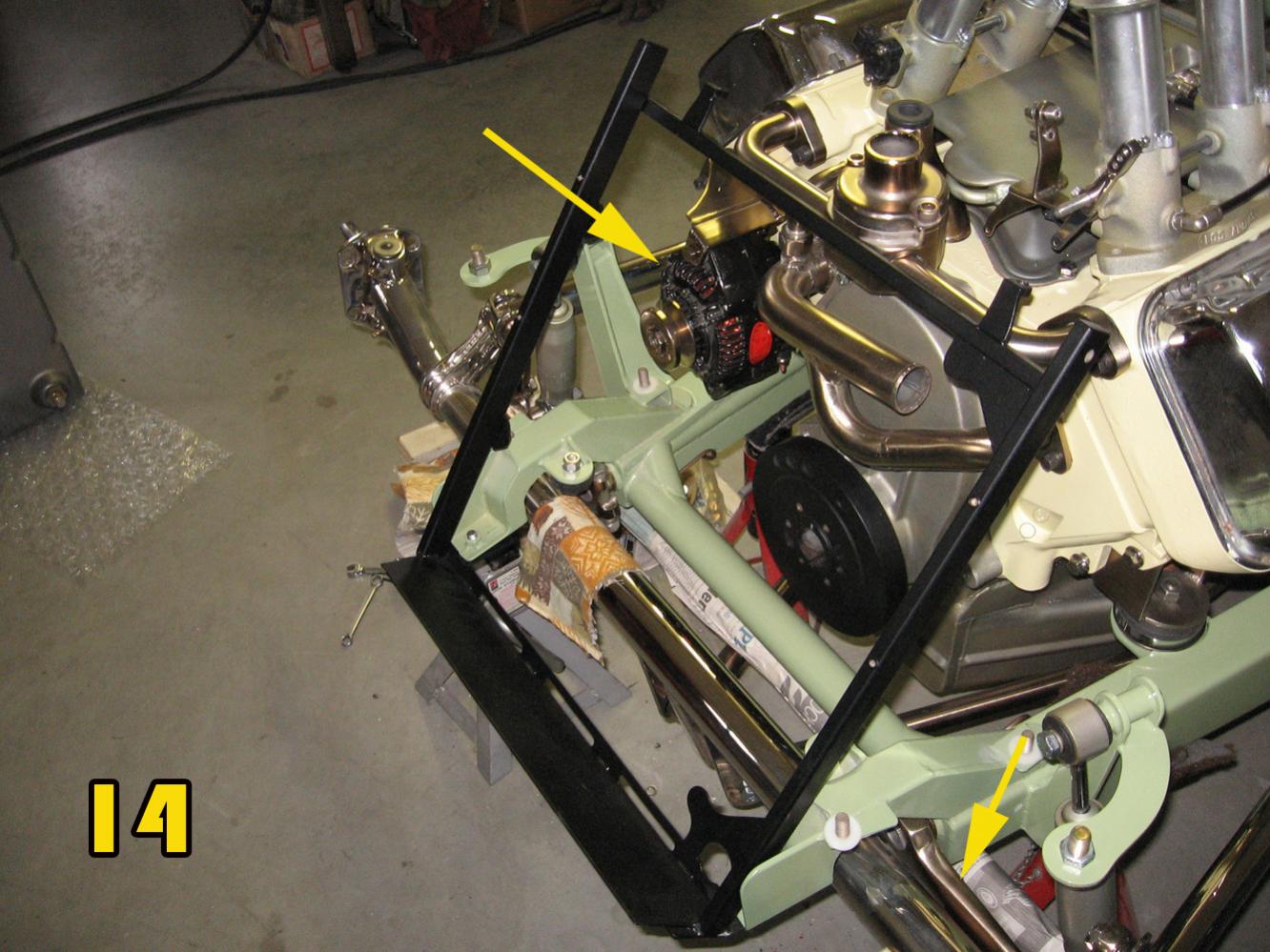

    Here you see the radiator bracket, which shows the tilt angle needed to fit the radiator into the nose. Much of the metal plumbing can also be seen. The cooling system tubing will be described more fully below. The only engine accessory that is belt driven is the alternator (arrow). The crankshaft vibration dampener is a rebuilt vintage part, but a Mopar small block dampener will work provided the keyway is widened and a new TDC index is engraved.
    The right hand arrow shows a good view of the driver’s side front torsion bar arm, which is tucked behind the tube axle. The timing chain cover is an early cast aluminum part. PAW sells a nice cast timing cover for Chryslers/Dodges Hemis; note that early Dodge and Chrysler Hemi timing covers interchange (except extended block 331 Chryslers). The PAW part is clearanced for use with a SB Chevy style water pump. My track roadster is equipped with an electric water pump, as you will see in Figures 17 and 18.

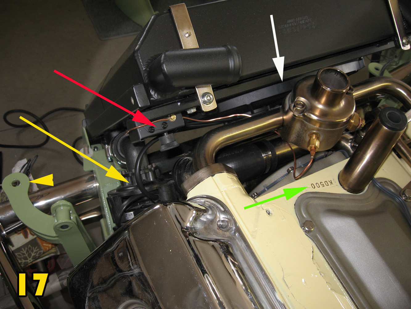

    This is a wide view of the radiator and front of the engine, lots of goodies in this photo. The OEM electric water pump can be partially seen (yellow arrow), as can a temperature control module, which regulates the water pump operating cycle (red arrow).
    In 1956 Dodge first produced the D500 Hemi at 315 ci, in a street version and in a racing version. I know this is going to hurt the feelings of some SBC fans, but a STOCK 2 door D500 Dodge was faster in a quarter mile than a STOCK FI ’56 Corvette, at least according to the road tests of that era. In the hands of Lee Petty the D500 Dodges were very successful in NASCAR [correction, my error, Corvettes did not have FI until 1957; the hi po version ah 2x4bbls]. The engine in my roadster is a 1957 engine (325 ci), these motors were designated by numbers beginning with KD500 (green arrow). I’ll probably do a more complete description of the engine later. Briefly this motor was painstakingly blueprinted. For all practical purposes the engine is set up using Dodge Factory specifications. The compression ratio is the same as the factory spec at 9.25:1. The pistons are new Ross cast alum pieces, which were chosen for their good expansion characteristics in street engines. I found a NOS cam blank and had Chris Nelson in Utah grind a factory KD500 hydraulic (1957) cam profile. If it was good enough for the California Highway Patrol, it’s good enough for me. This combination is good for about 5000 rpm with excellent manifold vacuum and gobs of torque; but not much of a screamer. The early Dodge Hemis, unlike the Chryslers and DeSotos, are undersquare with a smaller bore than stroke. It may not rev very high but it will pull like a freight train.
    This photo gives a good view of the headlight perch (arrowhead). Also, one can see a bit of the electric radiator fan housing (white arrow??) . Jack Presse gets full credit for stuffing lots of gyzmos in a small space; especially considering there is not a standard part in the whole muckin’ fess.
