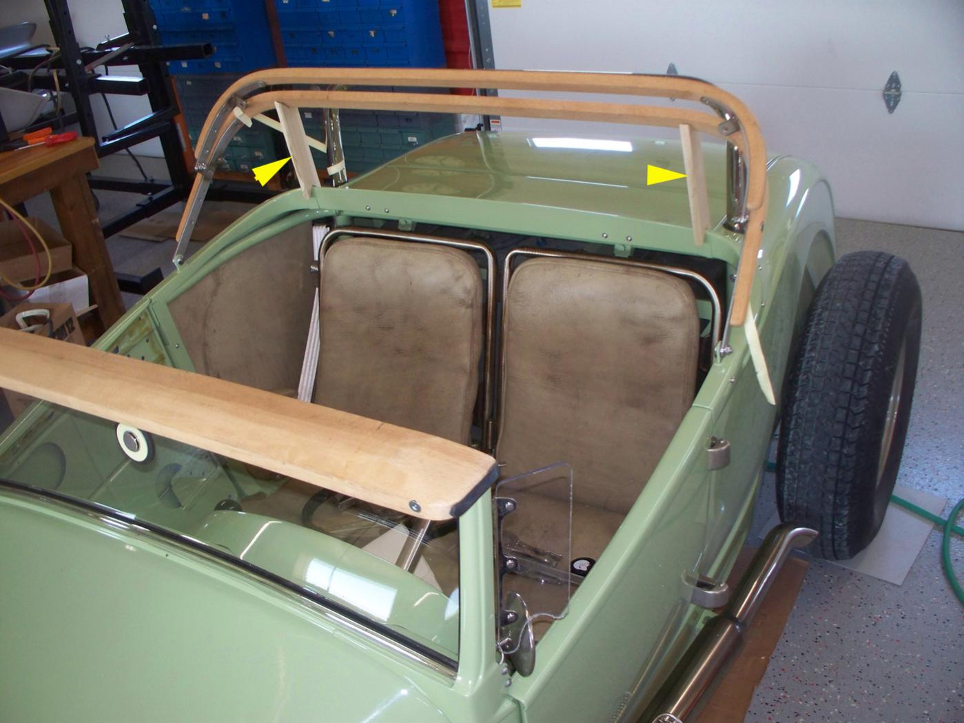

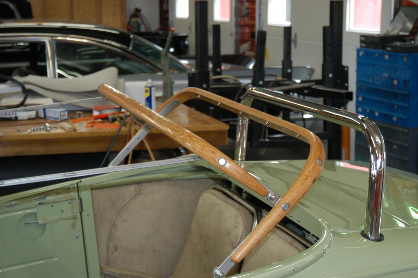

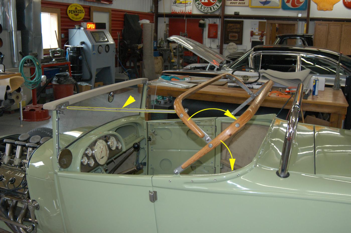

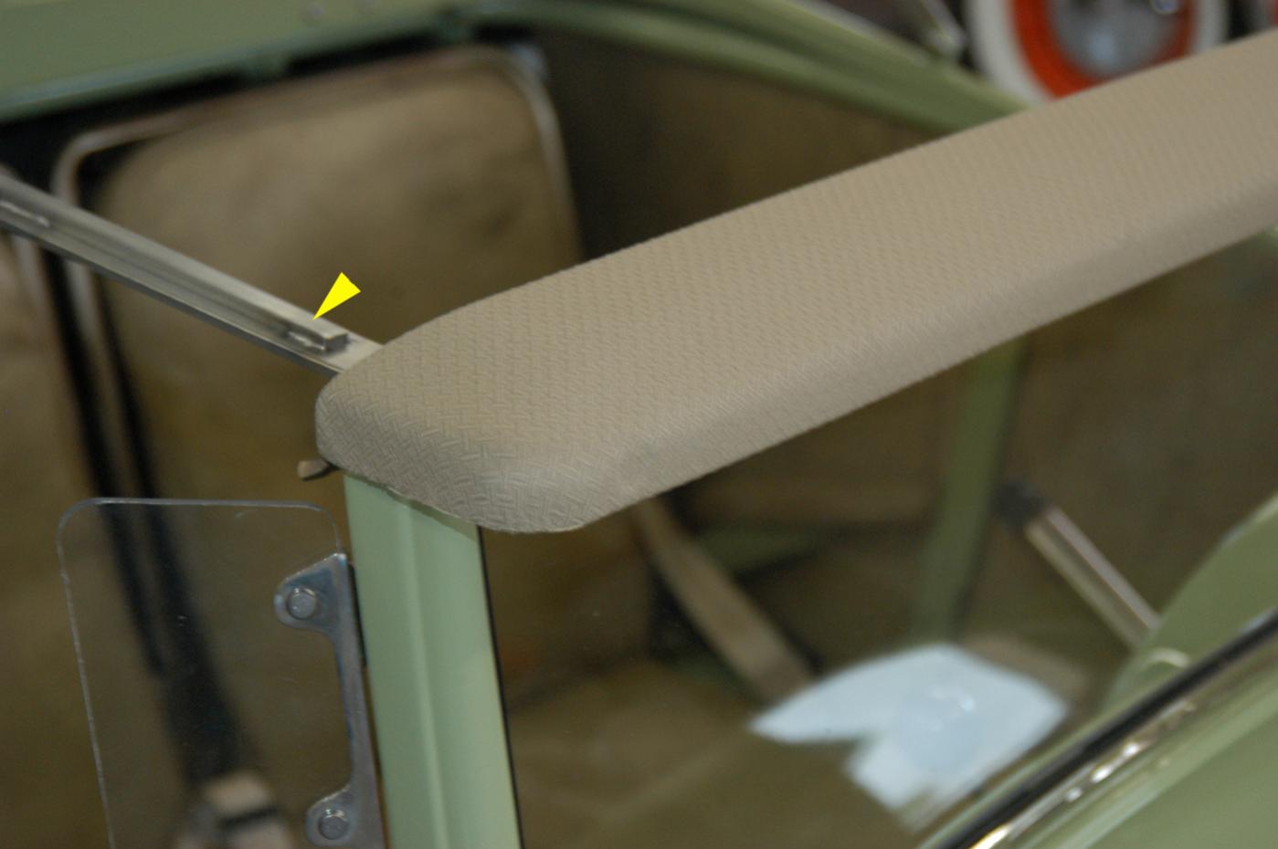

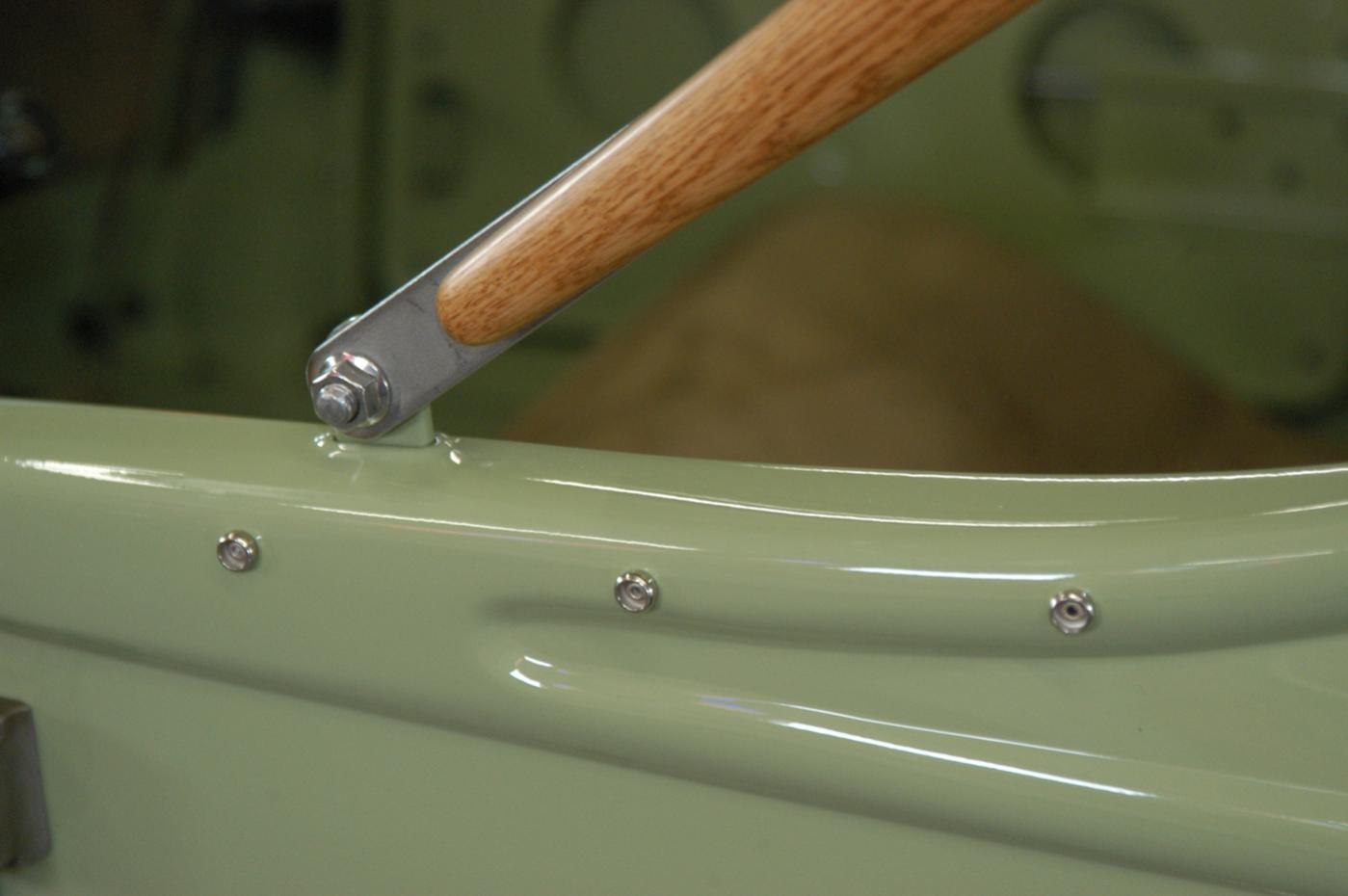

  25. Gang,
    I drove out to Don Kite’s shop yesterday. To her credit Don’s wife, Michelle, took some great photos of the build process last week and I took some photos yesterday.
    In a recent post I mentioned that Don had to tweak the bows and hardware to compensate for the fact that the body sheet metal is not symmetrical from side-to-side. After lots of trial-and-error Don was able to get the various elements pretty close to symmetrical, within about 3/8th.
    Don then established the height of the top by positioning the rear bow. To do this he made some wood spacers as seen in Photos One and Two (arrowheads). To establish the final position of the second bow Don had to adjust the length of the stainless steel stretcher that connects the first and second bows. The stretcher is shown in Photo Three (arrowhead). From a design standpoint fixing the position of the middle and rear bows also establishes the angle of the rear bow with respect to the upper body edge, and more importantly, the angle between the middle bow and the back bow (arrows, Photo Three). These angles have a big impact on whether the top looks “old-timey” or resembles a more swoopy “hot rod” top. In this case we all agreed that we wanted an old-timey appearance.
    Once he had these angles and dimensions Don took the stainless steel parts to Dick Easterwood’s shop up the road. Dick filled and re-drilled some bolt-holes in the stainless hardware. Dick also wielded a gusset or reinforcement to stiffen the two stretchers, which connect the front and middle bows (arrows, Photos Four and Five). Meanwhile, Don had stained, sanded, and varnished the middle and rear oak bows. The front bow (pine) was covered with a water-repellant fabric (Photo Four). The oak finish is beautiful, too bad the bows will be mostly hidden (Photos Five, Six and Seven). Photo Six shows details of the snaps for the top canvas, we all agreed that less is more so Don chose to rivet stainless steel snaps to the body. Snaps that attach via rivets do not have a flange, see the close-up photo. We all fretted over making holes in the paint/body and adding hardware to the Maserodi; however the roadster is pretty conservative in terms of do-dads and widgets. In my opinion the small stainless snaps do not look too fussy; what do you HAMBers think?
    I have more photos Michelle took showing steps in making a mock-up of the cloth top; I’ll post those images later.
    I’ve said it before, and I’ll say it again — the best part of this 16 year effort is having the opportunity to look over the shoulder of master craftsmen at work. I have been extremely fortunate at finding just the right expert for the job at every turn. My hat’s off to Don, for his meticulous craftsmanship, with many thanks to Michelle for capturing the images of Don’s work.
    Charlie
    Aka trakrodstr
