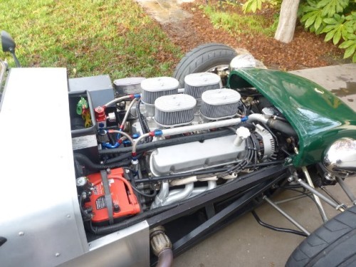

    I'm not sure if I have posted this before here, but this is a picture of a Weber based EFI conversion that looks pretty low to me.
    The locost super 7 is not a traditional rod, but he totally scratch built it and it is hot rod ingenuity all the way.
    I'm posting it as an example of a successful EFI conversion.
    He did the conversion and it is talked about in his thread here.
    http://www.locostusa.com/forums/viewtopic.php?f=35&t=1586
    He uses a megasquirt management system I believe.
    It runs very well.
    http://www.youtube.com/watch?v=ZhNUG3t3NRU&feature=related
