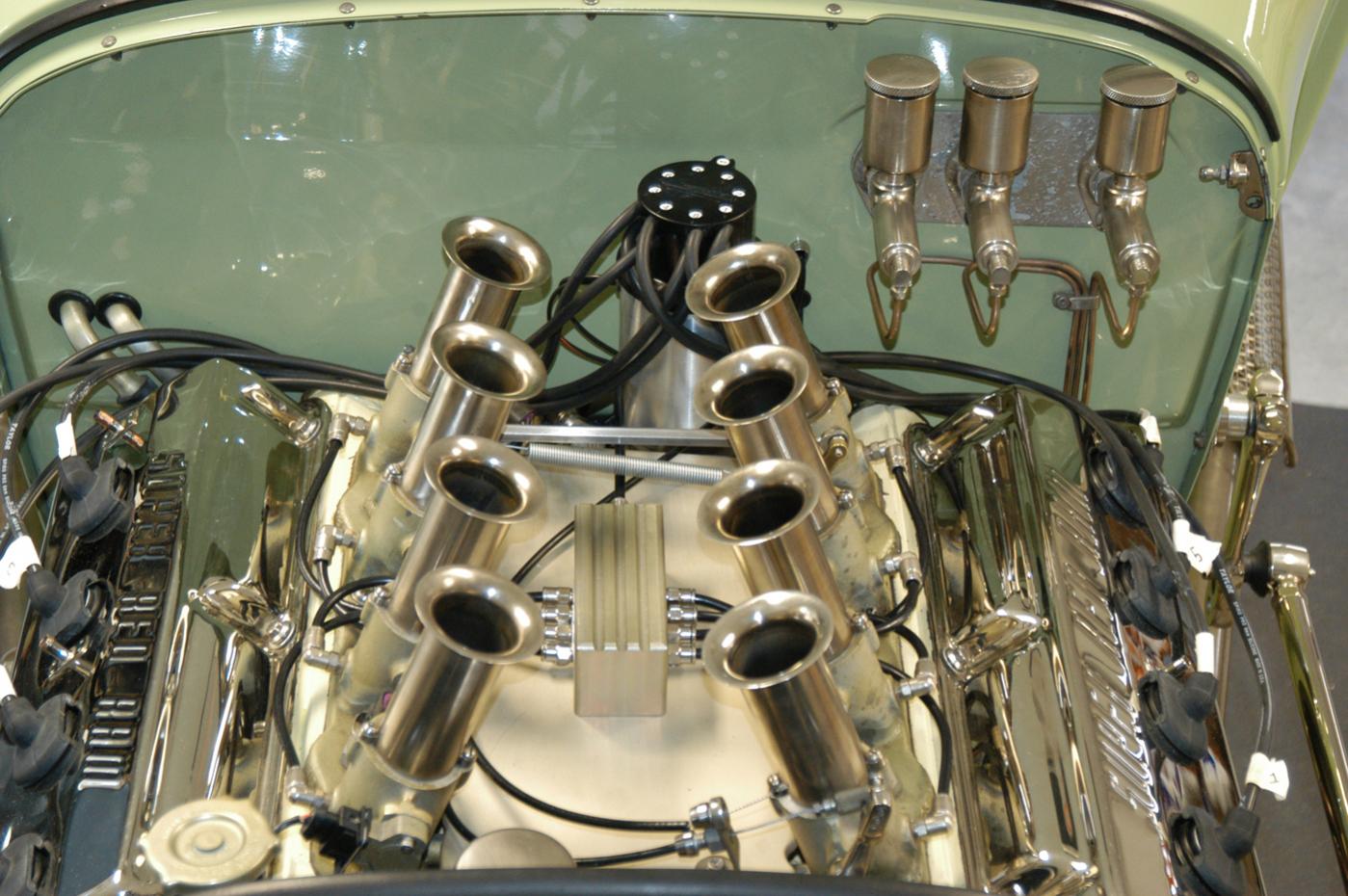

  13. Here is how the engine bay appeared when we stated the Hemi last night.
    I think the new vacuum plenum looks great especially with the neat old vintage look of the Vertex "mag".
    trakrodstr

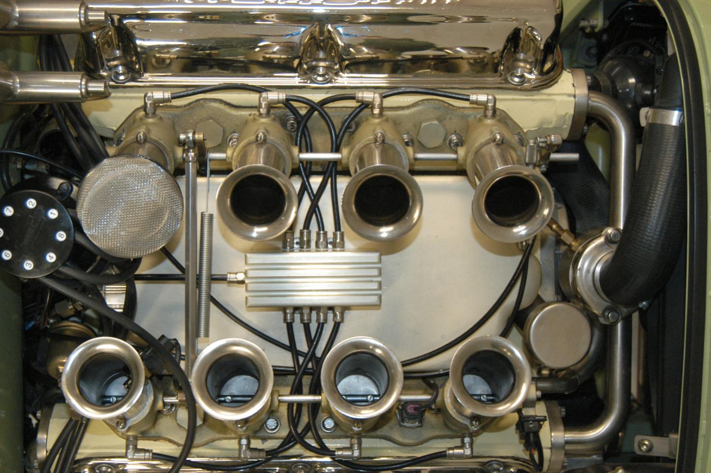

  18. Brett came by to do some more engine management tweeking. We were able to get the ignition timing and the distributor dialed in just right.
    The good news kind of stops there. We were not getting a meaningful vacuum signal so we inspected all the lines and so forth. Nothing obviously wrong. So we are back to trouble shooting the vacuum circuit. Brett did not have his vacuum gauge with him, so we called it a night.
    The obvious possibilities are a faulty manifold absolute pressure (MAP) sensor, a BAD vacuum leak, or an intake/exhaust valve not closing. With respect to the latter possibility, remember that I changed to a new set of non-adjustable pushrods. Before installation, I checked the length of the new pushrods and the length was what I ordered. I doubt the problem is a overly long pushrod, but we will check the compression to be sure.
    Brett has a vacuum pump so we will be able to isolate the vacuum circuit and see if there is a bad leak somewhere.
    Two steps forward and one step back.
    I have attached one more photo from today to keep the karma on the good side...
    Stay tuned.
