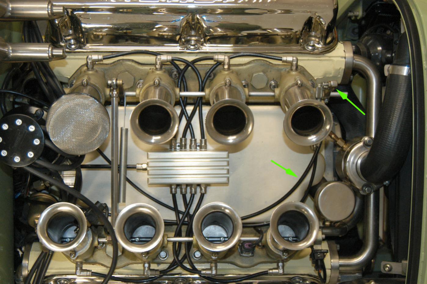

  8. deto
    Joined: Jun 26, 2010
    Posts: 2,619
    deto
    I have a question. Whats the deal with the fuel distribution block? Are those fuel lines and nozzles actually plumbed into the plenum? Or are you sourcing your vaccuum signal from them.
  9. deto,
    The plenum you see on “top” of the valley plate is a phoney ”fuel block” with phoney “fuel” lines that are plumbed to the original Hilborn fuel inlet bungs. In my EFI system they are, as you suggest, a source of a vacuum signal.
    If you go back a few pages in the thread you can see the whole enchilada, layer-by-layer, and the electronic nozzles that are hidden by the valley plate.

  10. deto
    Posts: 2,619
    deto
    ok. So this alone isnt enough to provide a common plenum between the runners?
  11. deto,
    Yes in my estimation it is a common plenum. From a physics standpoint the "fuel block" and all the hoses are part of a common plenum. If you were an oxygen molecule you could "go" anywhere in the system, there are no blockades. Of course it is not likely that there is very much "flow" in the system. My guess, based on no data, is that the vacuum pressure (manifold absolute pressure) is vibrating slightly with the pulsations of the cylinders, but the cavity in the "fuel block" kind of acts like a dampener. The relatively small caliber of the hoses also likely dampens the vacuum oscillations.
    We hope that the resulting 12-14 inches of Hg will provide sufficient vacuum signal for the CPU to do its magic. I am beginning to think this all might work out in the end.
