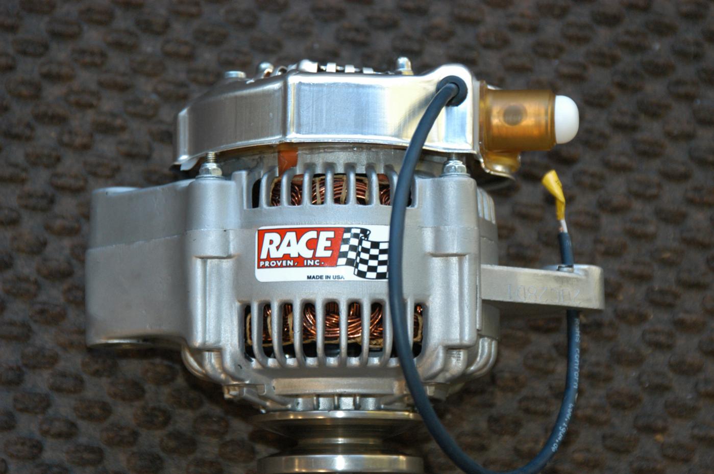

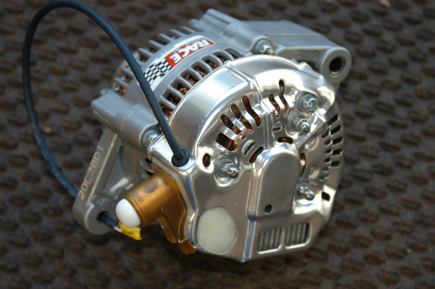

  7. Here are two photos of the newly upgraded Denso alternator as performed by RaceProven.com. My first impression is that I see lots more copper windings. The black powder coat is gone, as well as over spray inside the housing. The terminals are in Dodge Truck lingo "Job Rated"; with big robust terminals that are packaged in race car quality housings and insulators. The unit is now a two lead hookup. The cowling on the back has plug of silicone rubber filling one opening visible in the lower left of the second photo. Altogether a nice looking piece of equipment.
    The modifications to the rear cowling are designed to improve airflow and circulation over the rectifier diodes and heat sink.
    The fit in the TR engine compartment is so tight that the acorn nuts securing the back cowling are too long (tall) and will have to be replaced in order to hang the alternator back on the engine.

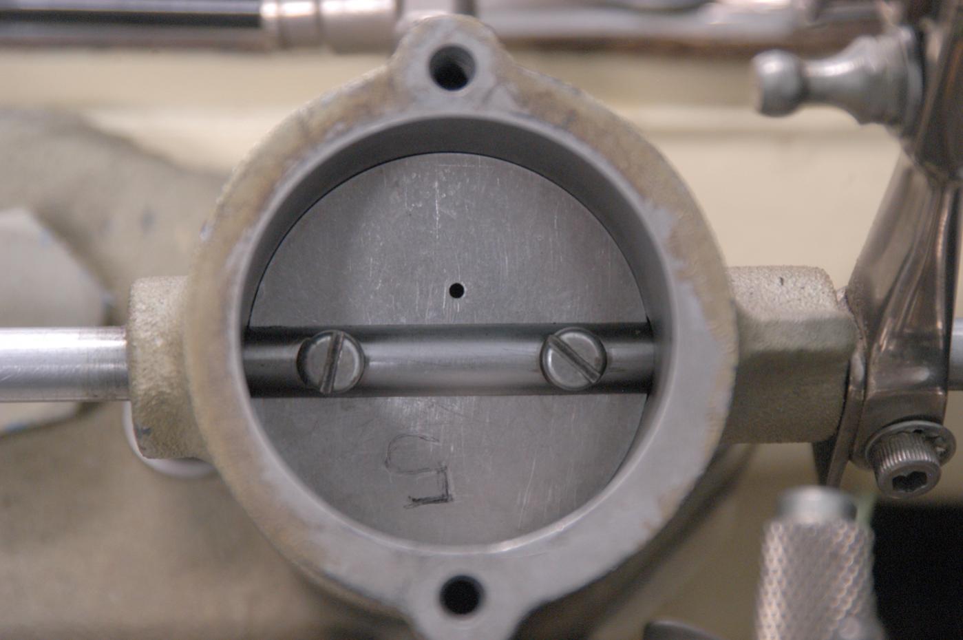

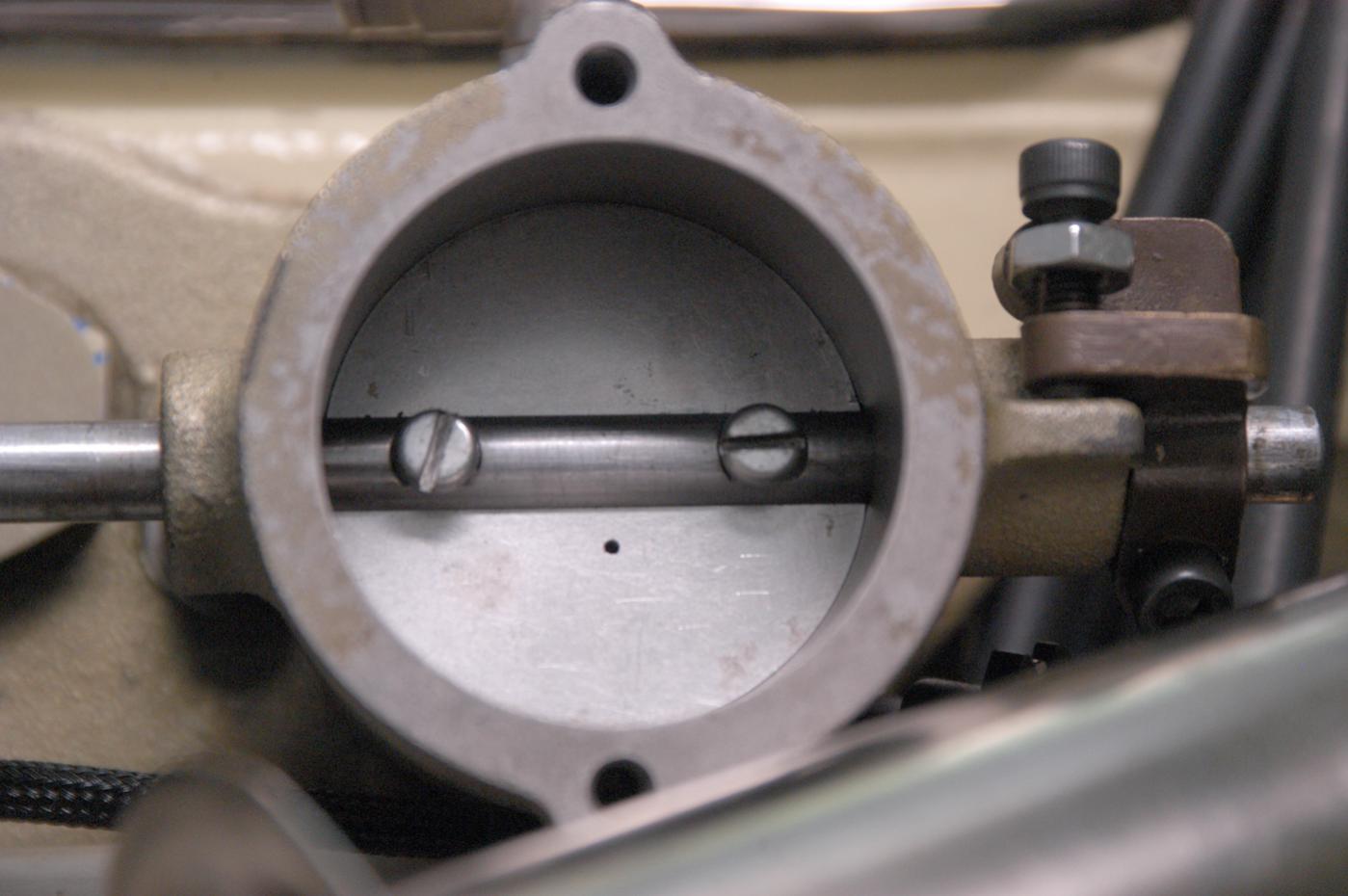

  12. As I stated to LB+1 above, Brett and I made good progress last night. To set the stage, all our efforts were focused on IDLE conditions only. After we installed and checked out the new alternator we let the Hemi warm up to full operating temp, which, at idle, is about 190 F<style><!-- /* Style Definitions */ p.MsoNormal, li.MsoNormal, div.MsoNormal {mso-style-parent:""; margin:0in; margin-bottom:.0001pt; mso-pagination:widow-orphan; font-size:12.0pt; font-family:Times;} @page Section1 {size:8.5in 11.0in; margin:1.0in 1.25in 1.0in 1.25in; mso-header-margin:.5in; mso-footer-margin:.5in; mso-paper-source:0;} div.Section1 {page:Section1;} --> </style> °. The electric fan was cycling on an off approximately every 4 or 5 minutes. The idle adjustment was set so that the throttle plates were "cracked" open about 0.005 in.
    Once the temperatures stabilized Brett measured the temp of the exhaust pipes about one inch from the flange trying to target the middle of the pipe. Here is what we found:
    Driver bank temperatures from front to rear: 180° 900° 500° 200°
    P***enger bank temperatures from front to rear: 190° 500° 525° 180°
    At this point the engine was idling at 1000 RPM the first and fourth throttle plate on each bank had a 0.040 in. orifice (four plates). The “middle” four throttle plates were untouched.
    Brett and I slowly began a process of enlarging the orifices one at a time until we observed significant changes in temperature for example at least 200°F. As we moved through the various trials we kept readujusting the idle trying to keep it around 750 RPM. Each time we were able to significantly increase the exhaust pipe temperature the idle speed would increase. Eventually, we had to set the idle adjusters at zero opening.
    We moved from one throttle plate to the next starting at the forward driver’s side stack. The process took about 2 hours. We were also monitoring the O2 sensors during this time and a couple of times Brett would slightly modify the IDLE rich/lean mixture (air/fuel ratio) trying to get the average for each bank at about 13.5:1. Eventually we had to call it a night but here are the last exhaust pipe values we recorded at idle.
    Driver bank temperatures from front to rear: 350° 520° 400° 350°
    P***enger bank temperatures from front to rear: 340° 500° 500° 360°
    At this point the engine was idling at a steady 750 RPM. The first plate on the driver side had been opened up to a 0.070 in. orifice; the fourth plate on the driver side was at 0.048 in. The forward plate on the p***enger side was at 0.065 in., while the rear plate was 0.048 in.
    We decided to give it a rest. The exhaust pipe temps are far closer in magnitude and we are pretty sure that further “improvements” will result in a faster idle, which we don't want. As the old cast Hilborn system now stands…there is NO idle opening dialed in. In other words, the throttle linkage springs are pulling the throttle plates completely “closed” with no opening or “cracking” of the throttle plates dialed in. See the accompanying photos and notice that this is as "closed" as the Hilborn plates get.
    You might wonder…huh? What gives? The answer is that these old aluminum castings and throttle plates were never designed for street use and they leak slightly around each throttle plate (disk); and some air is most likely also ****ed in around the throttle shafts. In any case, the temperature values are well with in the acceptable range and Brett set the air:fuel mixture a bit rich (13.5:1) for safety.
    So all-in-all a VERY satisfying night of work, both Brett and I were smiling as we wrapped up the evening.
    The next step will be to put the wheels back on, get the TR off the jack-stands and take it out on the road. Oh yeah and a fresh tank of gasoline (see I’m listening LB+1).
    Each time we checked, the new RaceProven alternator was keeping up with the power demands at idle, including when the radiator fan switched on.
    So far, so good; Brett is in his busy season so it may be a week or more before we take the Maserodi on the road.
    Stay tuned… Photos show the four throttle plates at the end of the process. The pin vise and the "final" three bits are also shown.
