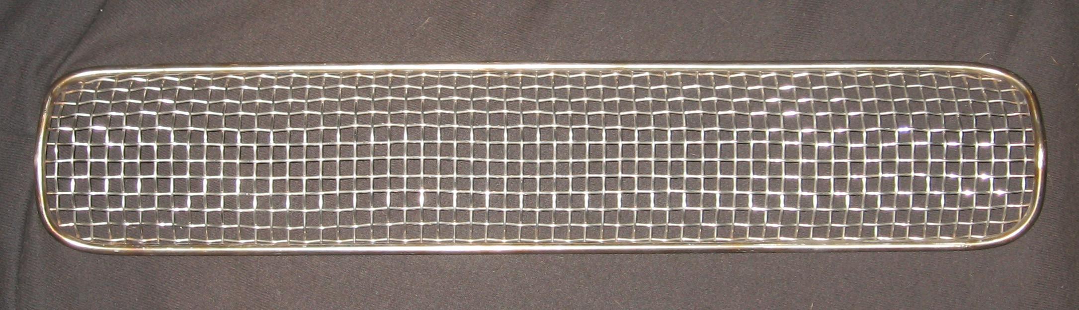

  8. OK gang, here are some more photos. The first batch shows a bit more interior detail, although there is not a great deal that is new. One photo shows the leather on the interior of the passenger compartment (inside of the quarter panel). The steering wheel has been coated, but is missing the badge in hub area. The hole in the rear deck is the opening for the roll bar.
  9. Until these photos I had not seen the gauges mounted in the cowling complete with paint and nickel plating. It was fun to finally see them in their real habitat. The shot from the passenger side shows that the glovebox is big enough to be really useful. The shot from behind the car shows that the top of the windshield has a slight curve (upward). Jack did this is so that the top of the windshield appears straight when viewed from the front. Otherwise the upward curve of the cowling would create an optical illusion making the top of the windshield appear to curve downward. Cool. Note that the rearview mirror is mounted to the driver’s side windshield stanchion. Again there is an open hole in the rear deck for the roll bar. The final photo shows the steering wheel in place with the correct finish and fasteners. Switch panels are mounted below the dashboard.
  10. Here are some more detail shots. The first photo shows a good view of the passenger side front wheel assembly. The finish of the custom-made brake drum contrasts well with the painted backing plate. This photo also shows the headlight assembly. The buckets are painted stainless steel; as mentioned earlier, these are old Perlux fog lamps as used on 18-wheelers. The lights have been converted to halogen lamps.
    The side view of the engine allows a clear view of the bright nickel valve covers and the bronzed ignition wire covers. The drag link is wrapped with newspaper, but the pitman arm can be seen clearly, Jack fabricated it from a torsion bar lever arm. Note that there are three positions whereby the drag link can articulate with the pitman arm, thus allowing subtle adjustment of the steering ratio.
    The next photo also shows a view of the engine area, the exhaust pipe beyond the clamp will be covered by a heat shield to protect the passenger's leg from burning. The shield clamps to a bracket on the frame, a photo of the heat shield is included here. The shield is fabricated from woven stainless steel cloth, .035 inch wire on 1/4 inch centers.
    The close-up photo shows a good view of the rear view mirror and its mounting bracket. The mount is designed to allow one to move the mirror outboard of the windshield stanchion, which would provide a better view to the rear, but would not be as unobtrusive.
    The last photo shows a different view of the mirror area. Note the “door knob” or release. This is a cut down door knob from a late 20s Dodge Bros passenger car, I won a set of 4 on Ebay about 10 years ago.
