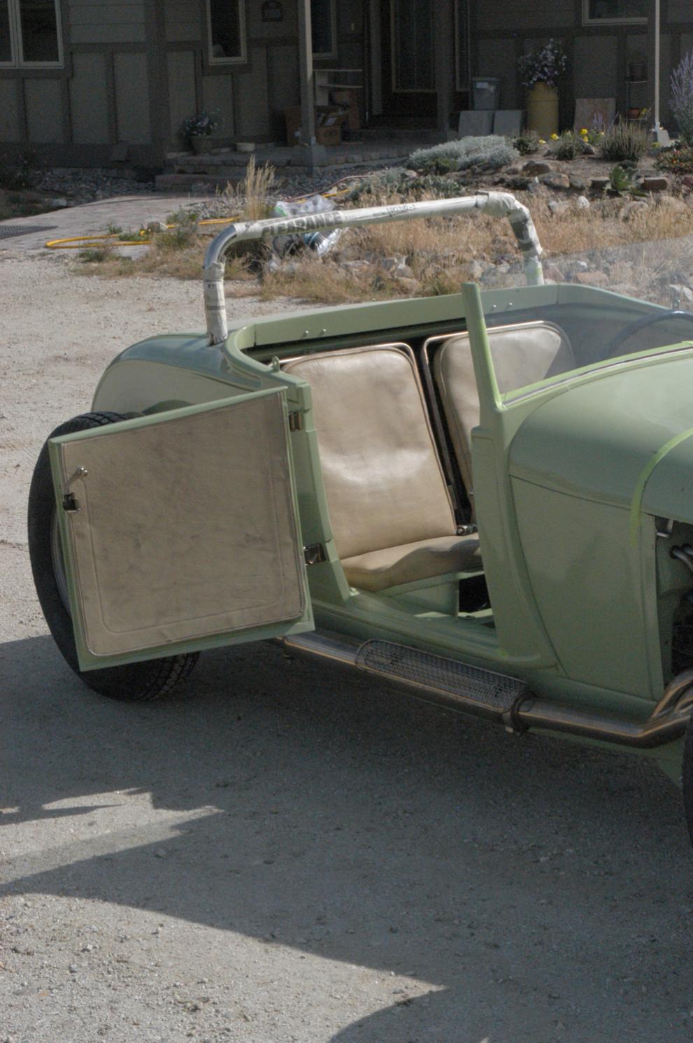

    The next photo shows that the suicide hinges allow the door to open really widely, with such small doors this is a real bonus. Any HAMBer considering building a stock-sized Model A should think carefully about ingress and egress, if they plan to drive their rod.
    This image also shows the roll bar clearly. Sorry about the newspaper, but Jack doesn't want to deliver a dinged-up roadster. The seat riser and height of the bottom seat cushion is visible. Also, note the wire cloth heat shield on the exhaust pipe/muffler.
