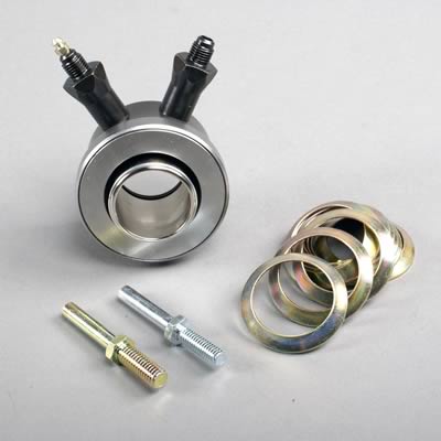

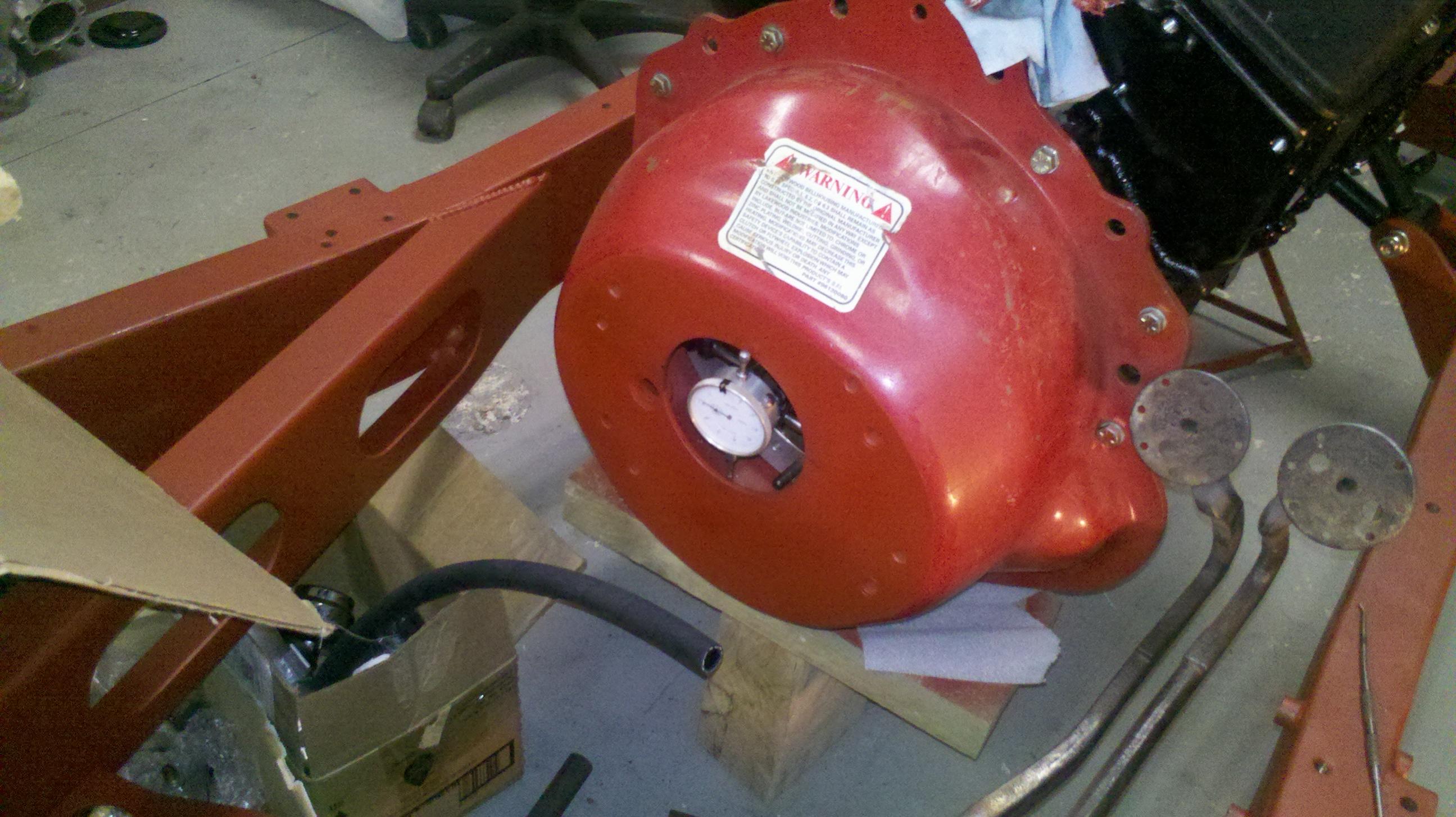

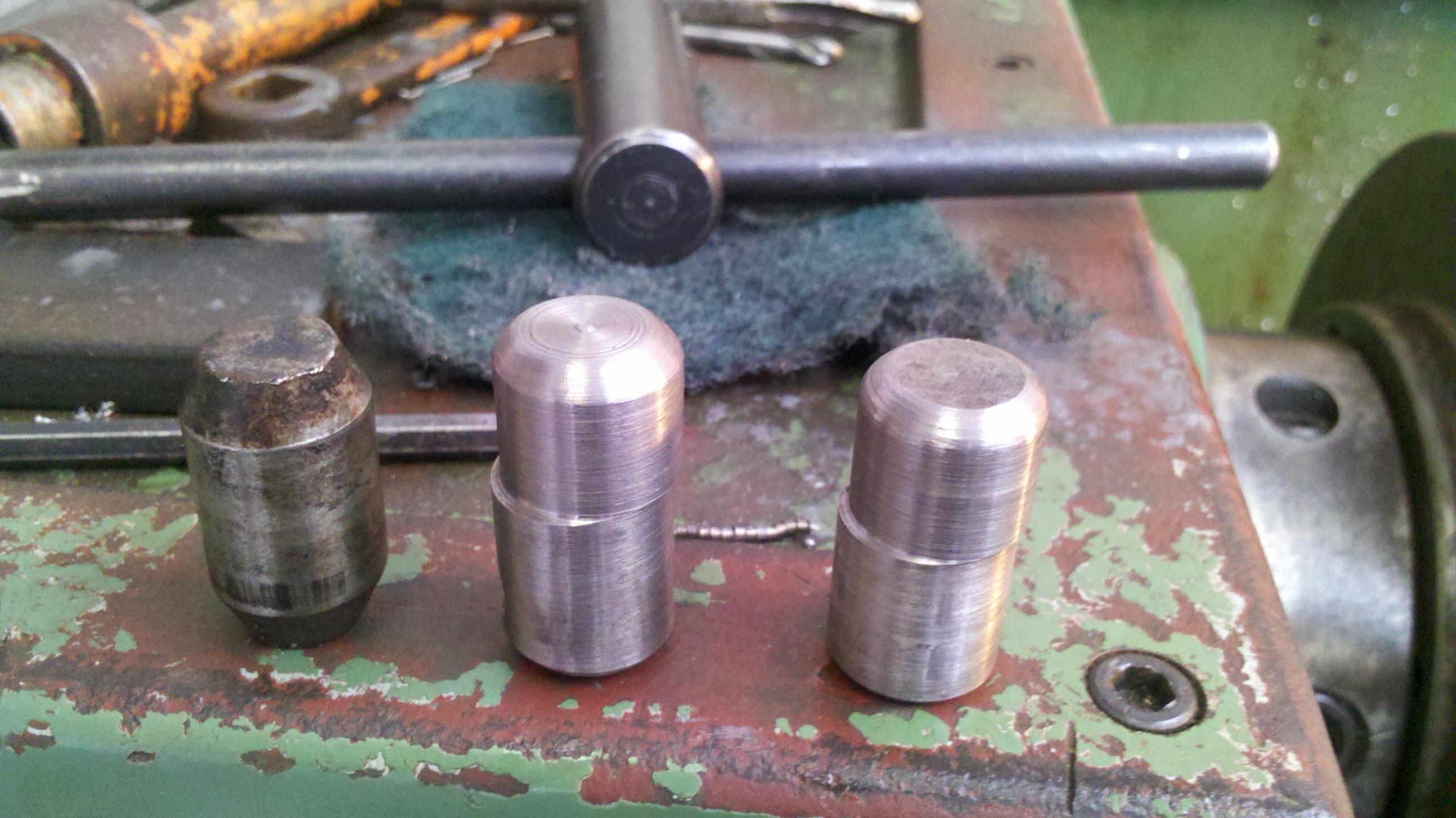

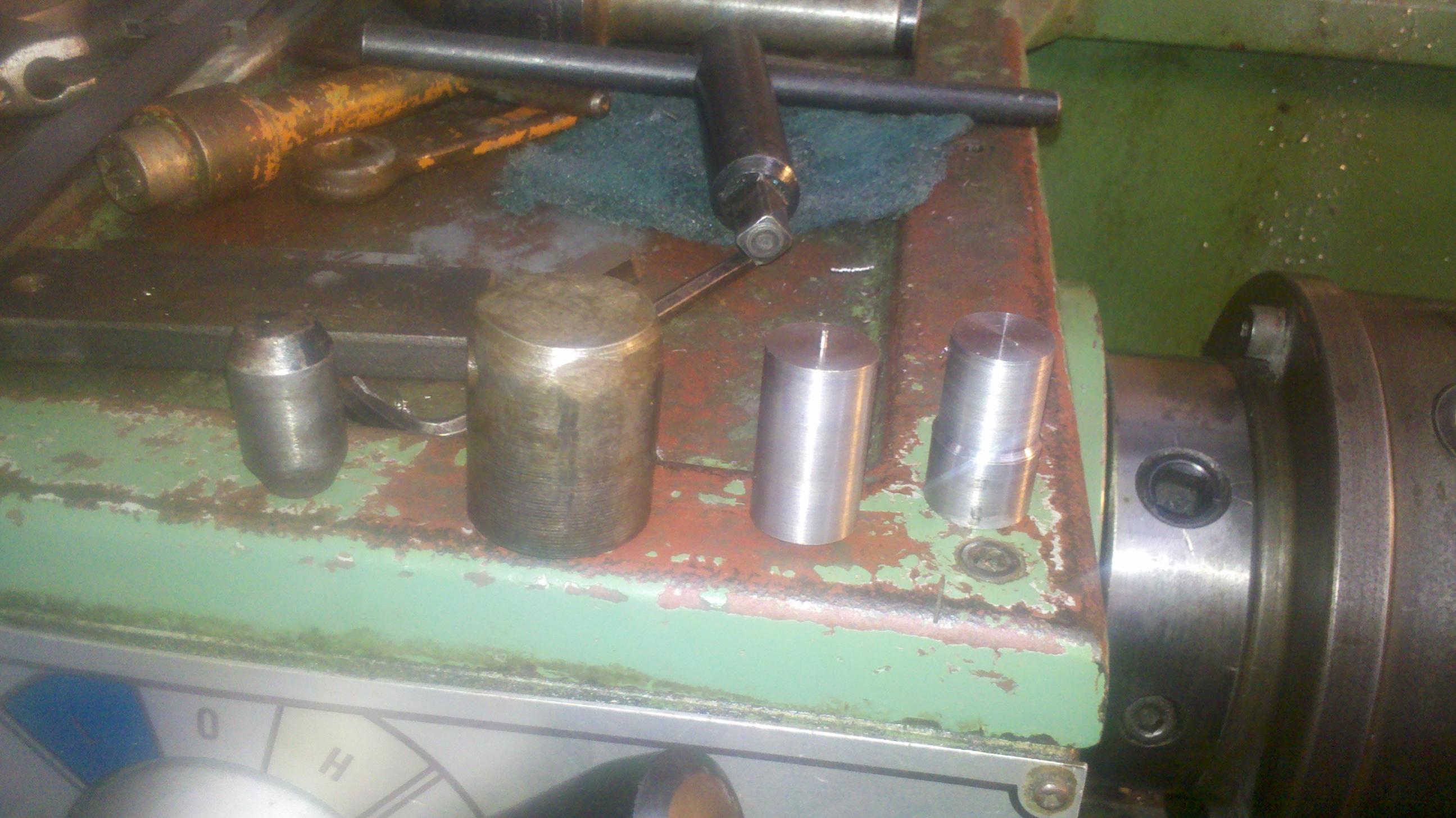

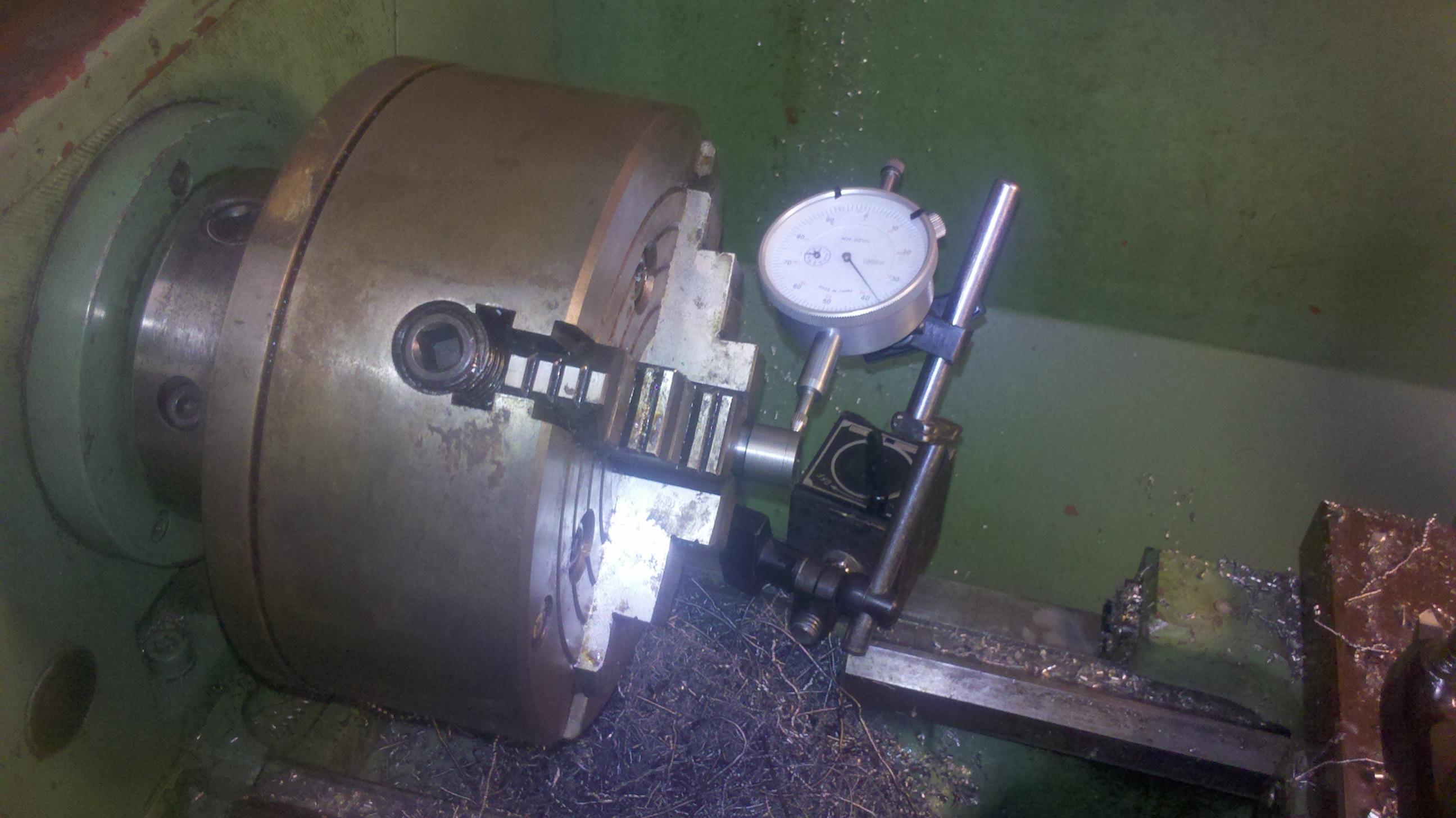

    Been toiling away getting the trans all trued up ready to mount, ran into a little snag - the scattershield clocked up within tolerance east/west but 30 odd thou out the other way - solution - make a pair of offset dowels and correct it... man is it good having a lathe handy, there are so many times you just need a little spacer or want to flush off a cut. Had to scoot down the road and pick through a fellow petrol heads buggery bin to find a suitable piece of hard steel - pin from a digger bucket - that'll do it! All sorted and sits perfect, well - within 0.0025" anyway, which is within spec. Now I've found another small hurdle - the Quartermaster release bearing doesn't fit with a twin plate clutch - shiiiiit! ah well "problems are only solutions waiting to be found" some wise arse cracks as he finishes your last beer and disappears into the sunset with no idea or solution.... while I ponder a solution I'm going to assemble the front end......

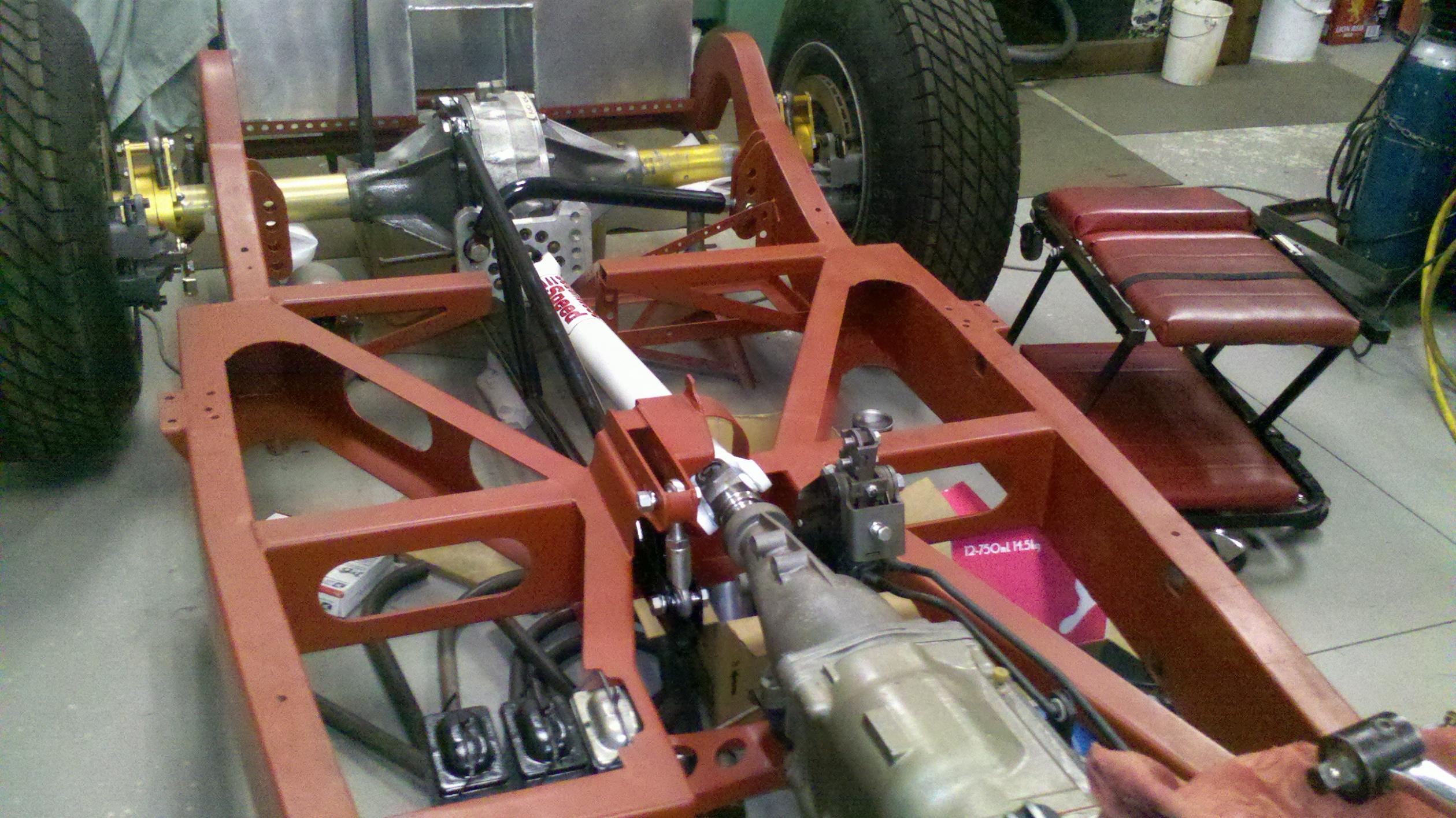

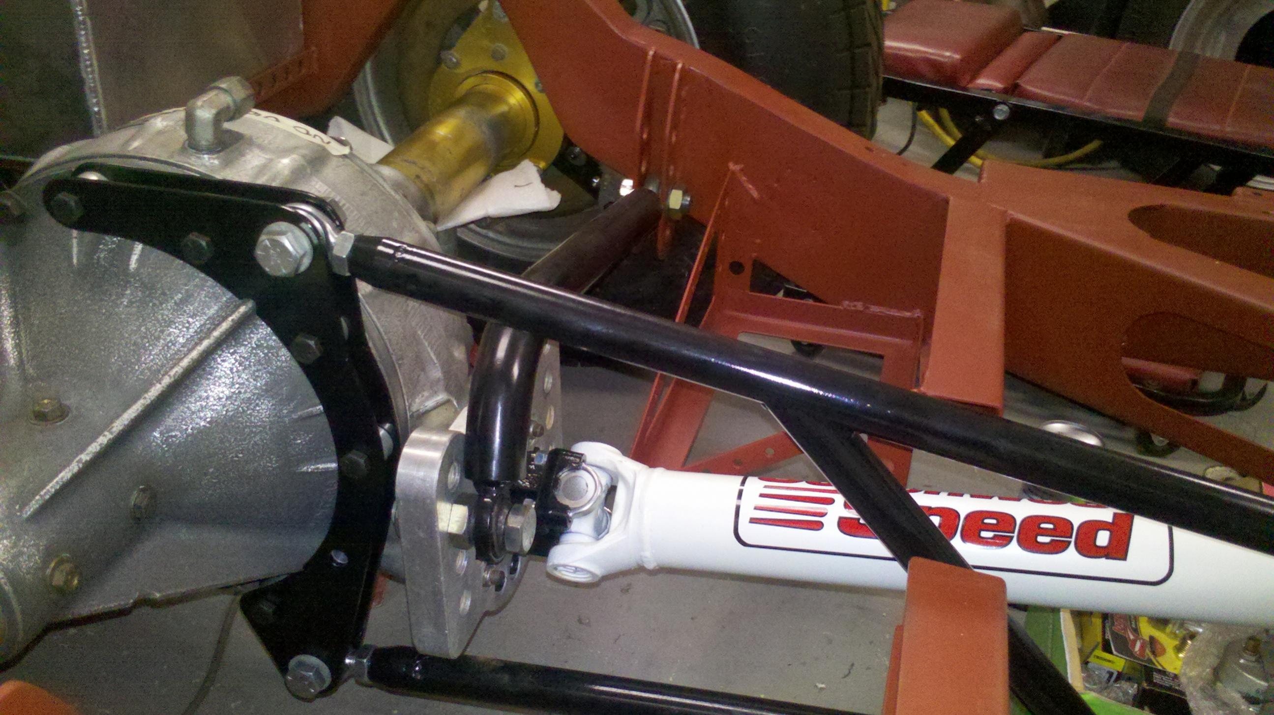

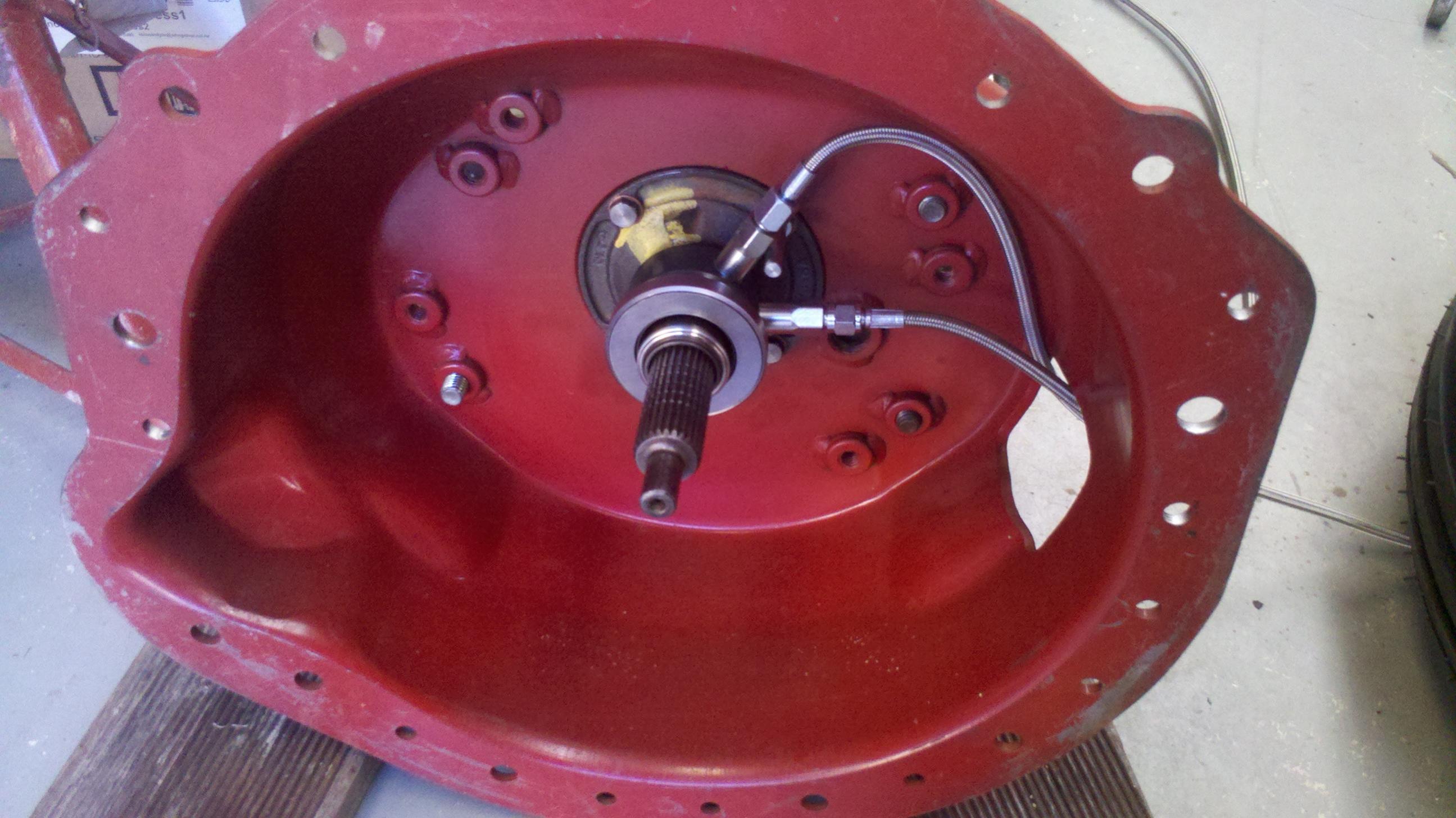

    Got a bit more done, found a solution to the throw out bearing - Howe part # 82870 is the magic fix, and I found one in a speed shop within a days frieght. So now I have the gearbox all mounted up, driveshaft in place - which was ordered a year ago with measurements from a mock up. A good feeling when something actually fits perfect from your theoretical measurement from the past... In the pics you can see the torque arm which is correct length for the cars wheelbase and wieght distribution and can be altered to suit track conditions, also see the "J Bar" for diff location which can also be adjusted to control side bite or rear roll centre.

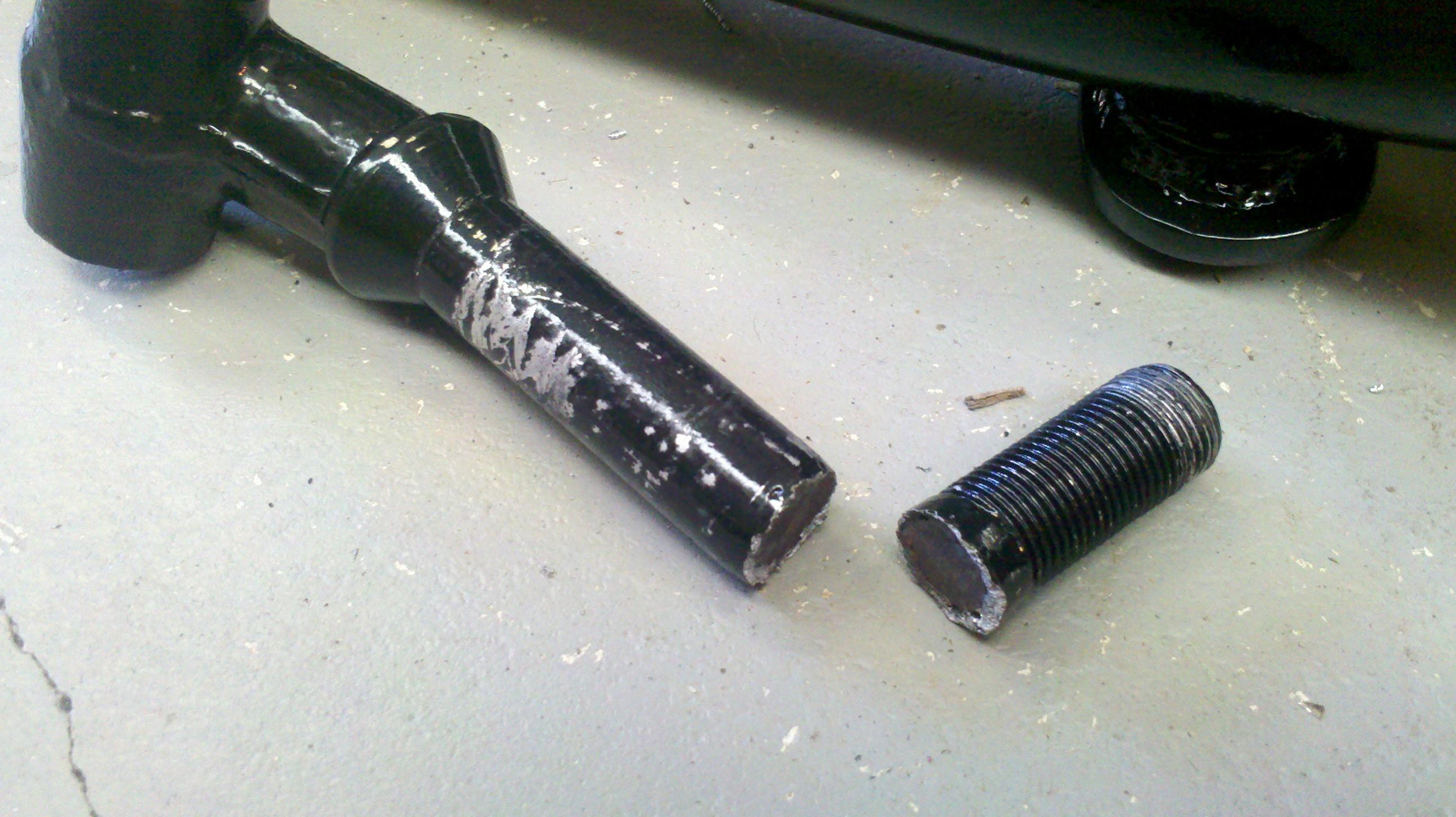

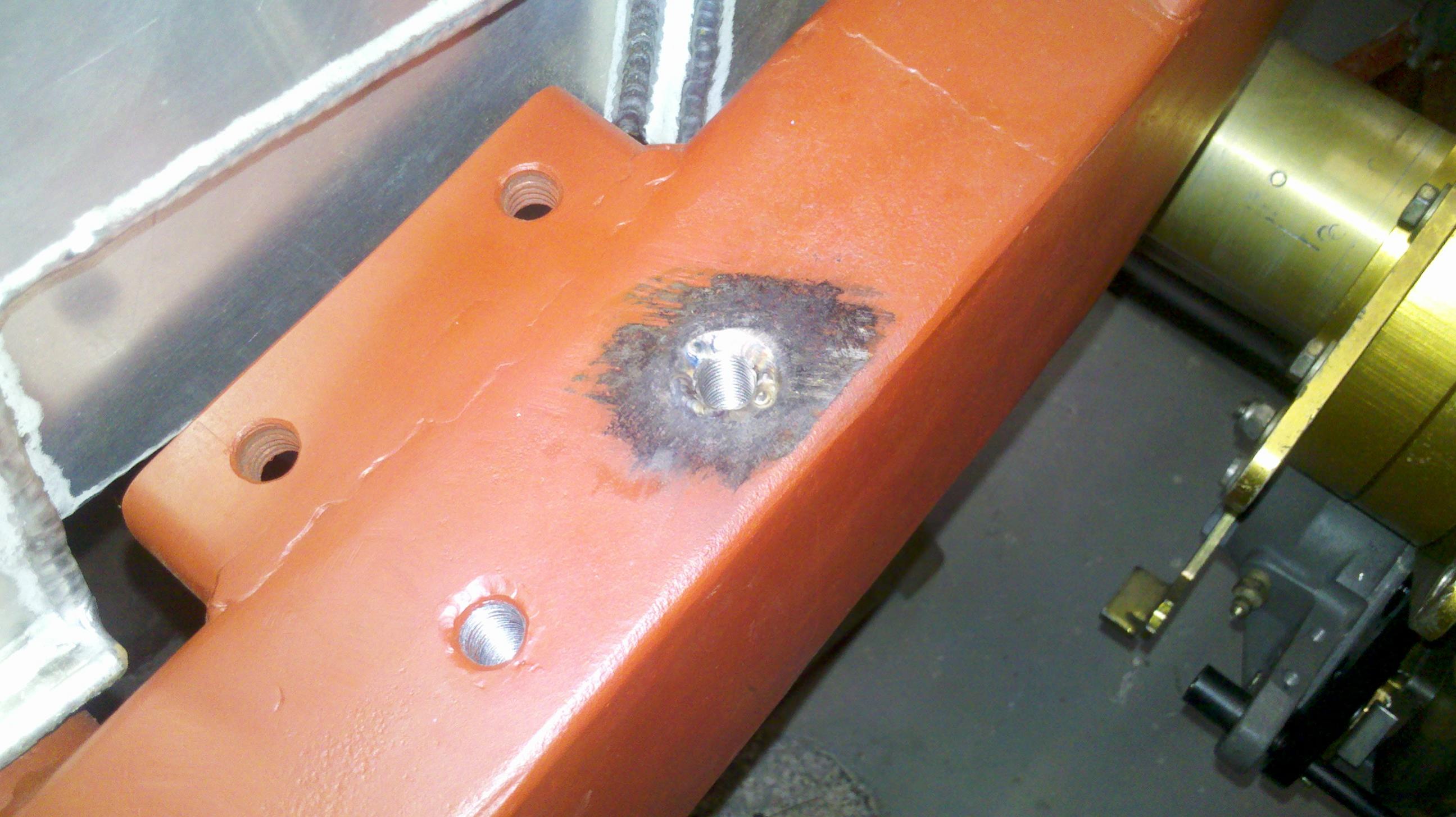

    Started to assemble front end, got axle soft mounted in the vice, put bat wings in place, heaved on the 15/16" spanner to wind up the tapers to hold those things in place and PING! the perch nut flies one way the washer another and I'm thinking W T F is goin on here... well after I pick up the peices it becomes evident some body further back in history for some reason WELDED studs to the perches???? Man am I glad it happened in the shop, check this out

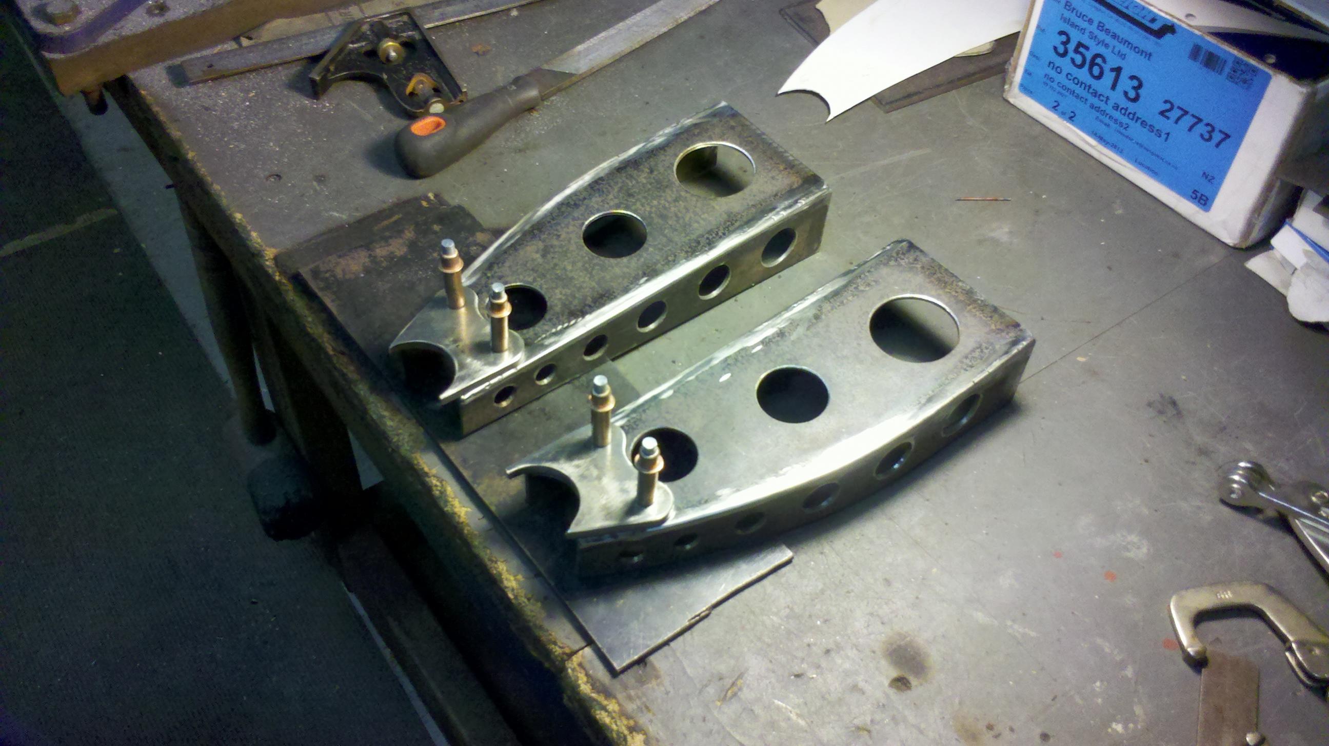

    While the body is off the chassis there are a few jobs that will be easier to do now rather than later. Like set the pedals in the right static position, attach return springs, and make adjustable pedal stops. Results show below...

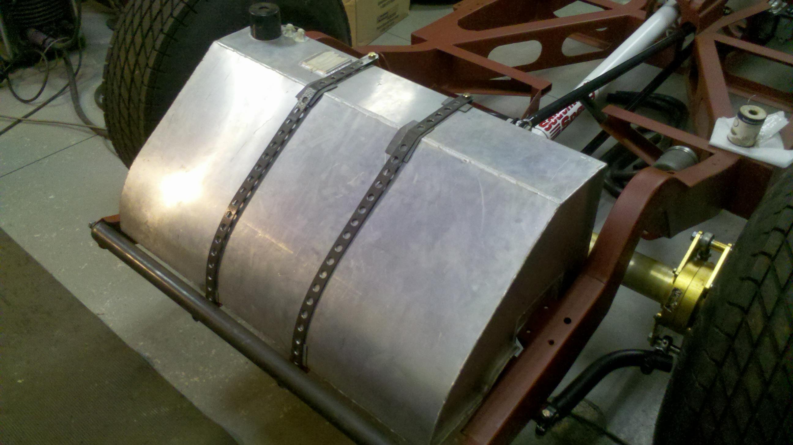

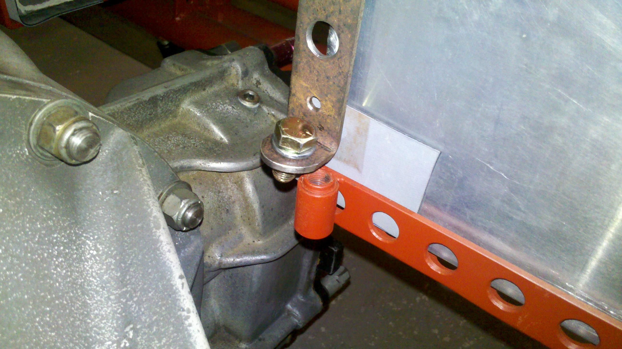

    Finished fabricating the fuel tank straps, lots of marking & drilling to get the race car look - and make them lighter... the straps are made from 1" x 1/8" corten steel with 1/2" lightening holes at 1" centres.

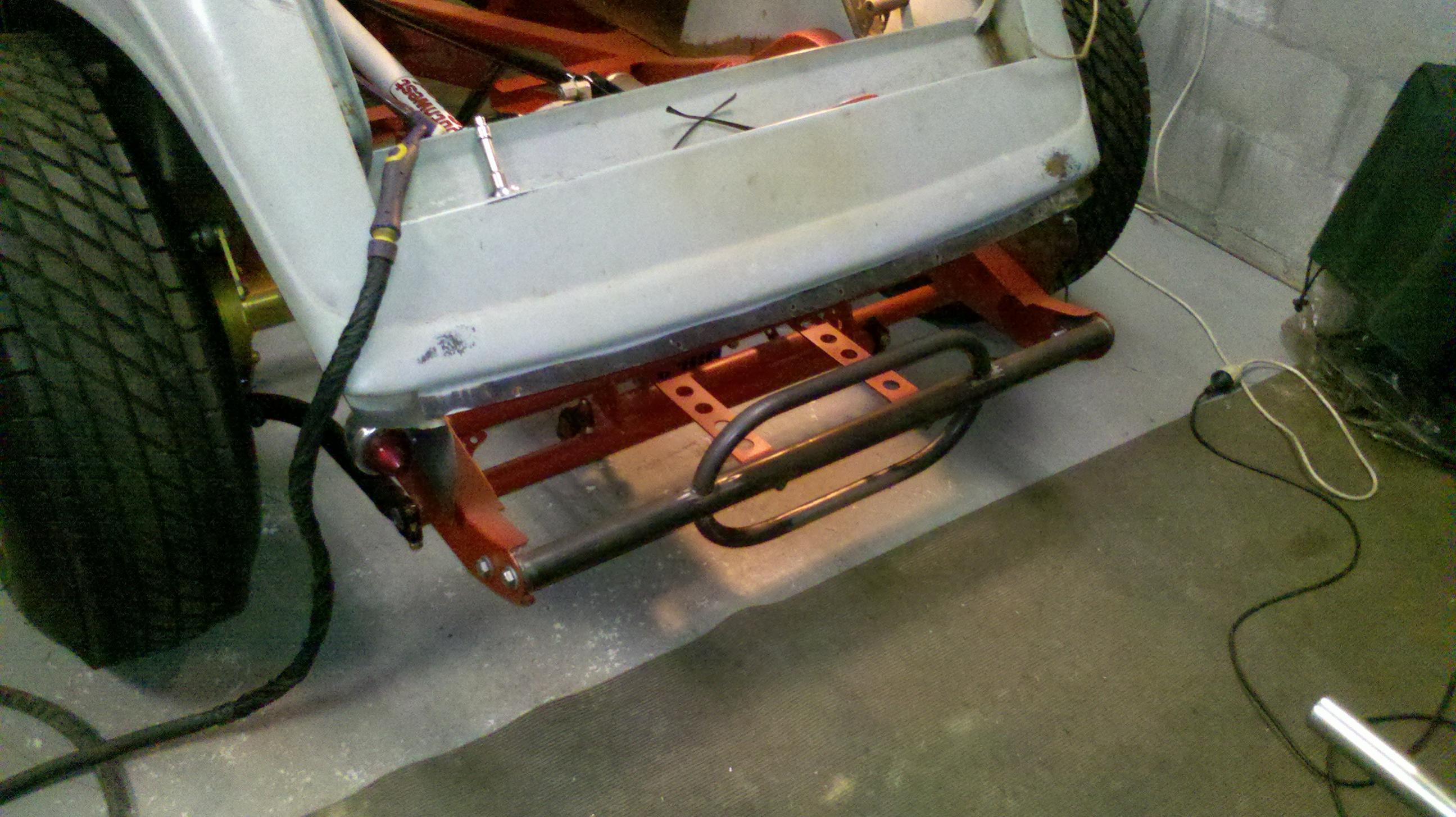

    Made a rear bumper nerf bar, finished bottom fuel tank mounts, put the last of the threaded sleeves through the chassis rails...

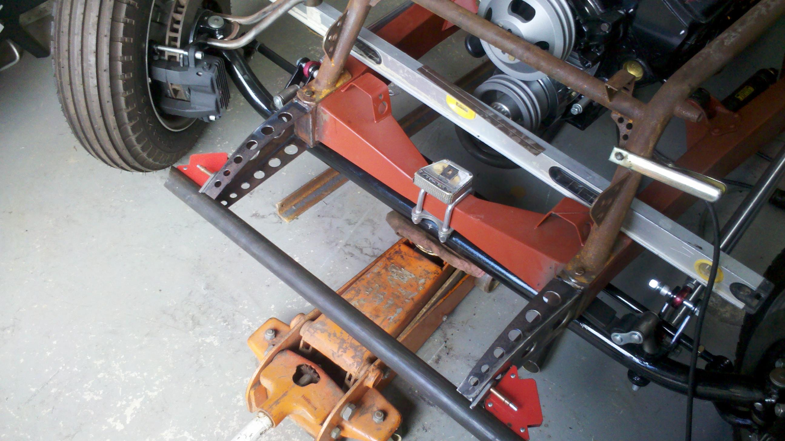

    Front bumper and nerf

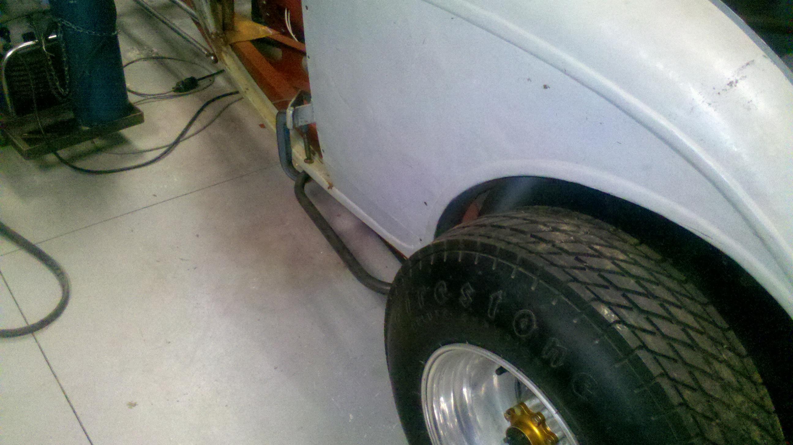

    mocked up side nerf

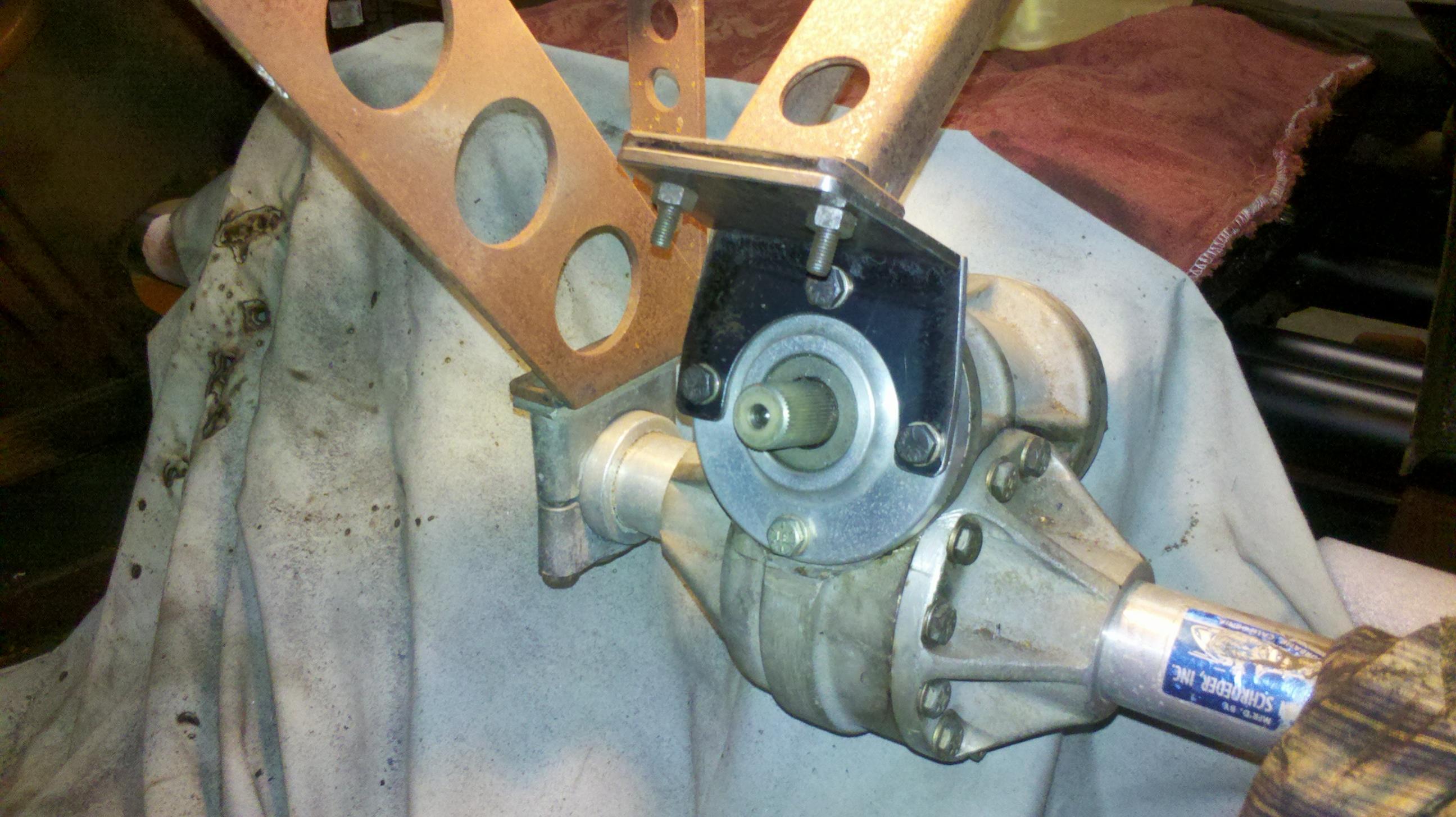

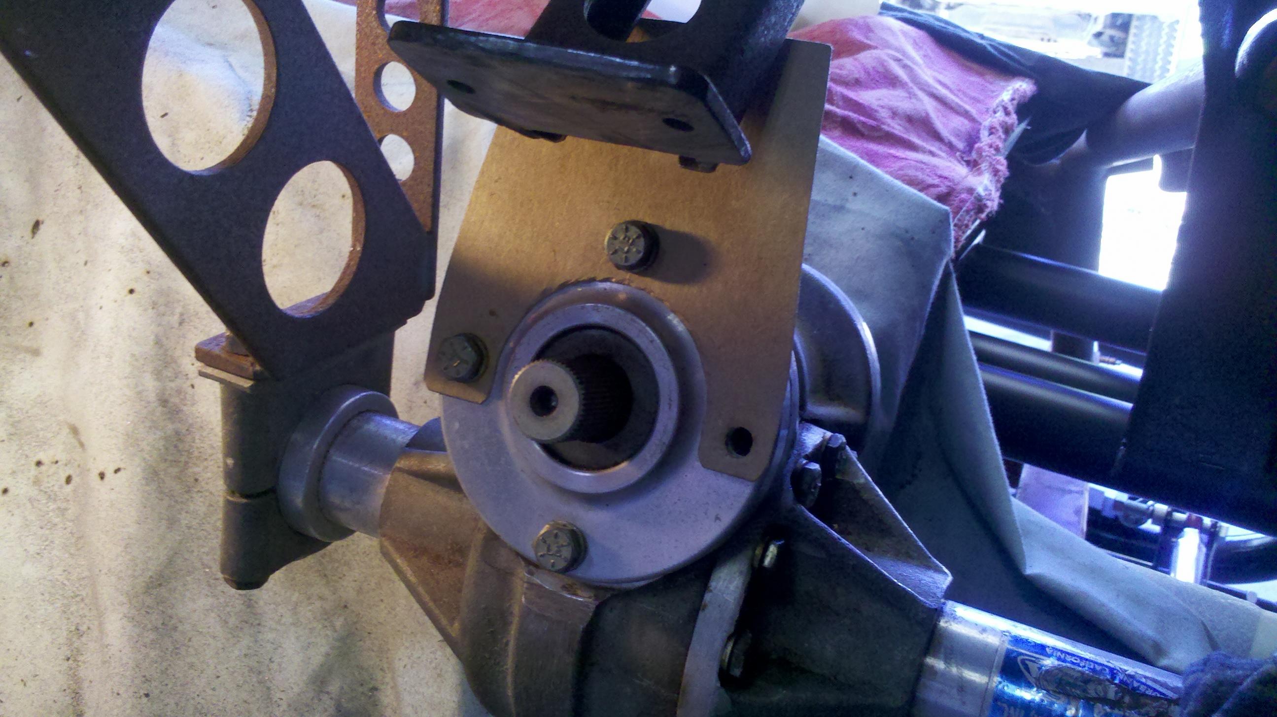

    Made a modification to the steering - I needed to slow down the 8:1 ratio of the steering box, so I've fitted a Howe 2:1 reducer out of a dirt late model. Pic's below show new mount to locate box from rotating under load.
