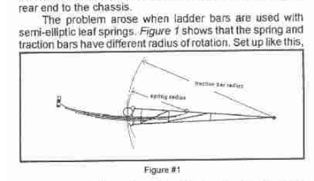

    If it still has parallel leafs, you'll still be trying to pivot the rear axle on 2 different arcs.

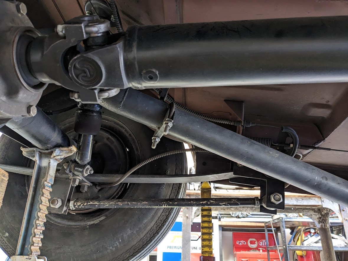

    I have some home made traction bars similar to Cal Tracs and the bellcrank doesn't show from the side so they kinda look like Traction Masters. They hit with a very short urethane snubber so they aren't harsh on the street and there's no bolt to remove.

    I made some also...work like cal tracs, look like traction masters. Pretty simple to do, just make the front plates L shaped instead of triangles.

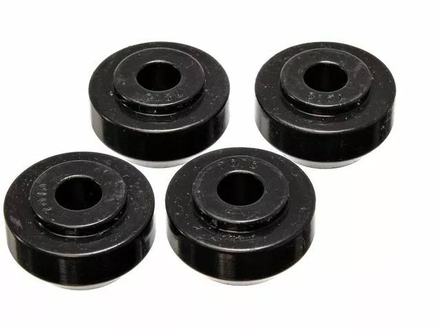

    You must let the traction bar move fore and aft freely while preventing it from moving up and down to prevent spring wrap. I do it two ways. One is to weld a 1/2" pipe in the front of the ladder bar. That pipe stabs into a MII rubber trailing arm bushing allowing the ladder slide fore and aft but not up and down and rotate inside the rubber and not bind the leaf springs. Just need to weld up a cup to contain the rubber.
    Second is to make a shackle for the front of the ladder letting the ladder swing freely fore and aft while again, restricting up and down spring wrap.

    I don’t think I’m completely explaining myself well. I am not worried about the front rear intersecting arcs being an issue. A slider or the shackle easily fixes that. What I am talking about is the fact that when the body rolls in a corner, one side of the traction bar must go up while the other one goes down. This is impossible if both of them are fixed securely at the rear to the axle.
    Picture, a rear end with the traction bars attached, but outside of the car. If you lift one traction bar, the other one necessarily lifts. Same thing happens when it is installed in the car.
    In a four bar system, both ends of all four bars are free to move independently, which allows one side of the axle to lift without the other side having to lift. That is what I’m trying to cure.
