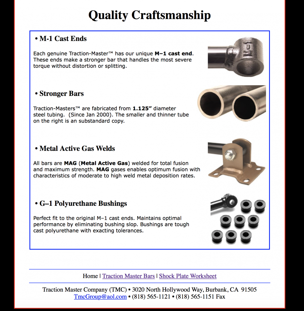

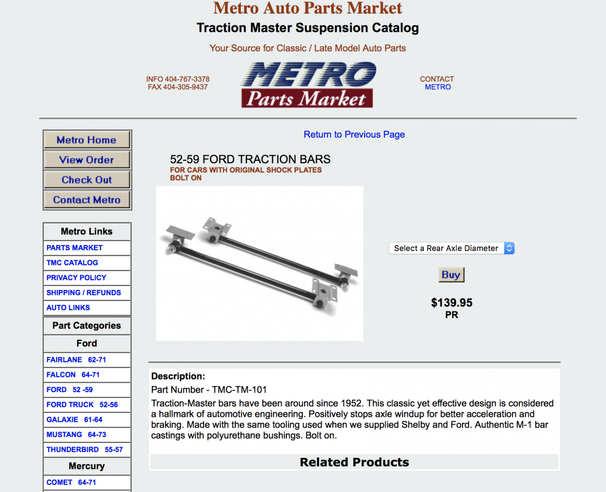

    Been looking at these... not sure if they are like the originals.... I have always heard the front tabs need to be welded on the frame...... Anyone have any 1st. hand experience with these... Looking and thinking about my 57 Ford.

    Jeff, the bars in your photo are almost identical to what's been on my 55 T-bird for many years. They do bolt to the spring/shock plates at the rear, but the forward mounts are bolt-on. The front mounts, could be either bolt-on/welded to the frame. My bars and brackets were chrome, but I had them powder-coated 20% gloss black. They are Tractionmaster bars and pretty much the same as those used on Shelby GT350 Mustangs. My father was the 2nd owner, and the car has been in the family for approximately 50 years.

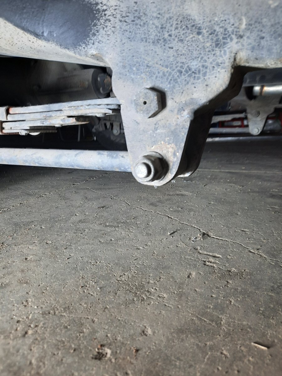

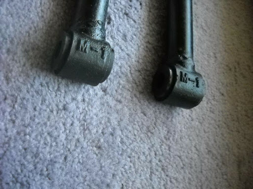

    Genuine Traction-Masters will have M-1 cast into the bar ends. Currently, their website only lists weld-on bars, but mine are bolt-on. The front mount is triangular/w one hole utilizing the existing leaf spring front mount. A second hole had to be drilled into the frame. If I can figure out how to post a photo, I will.
