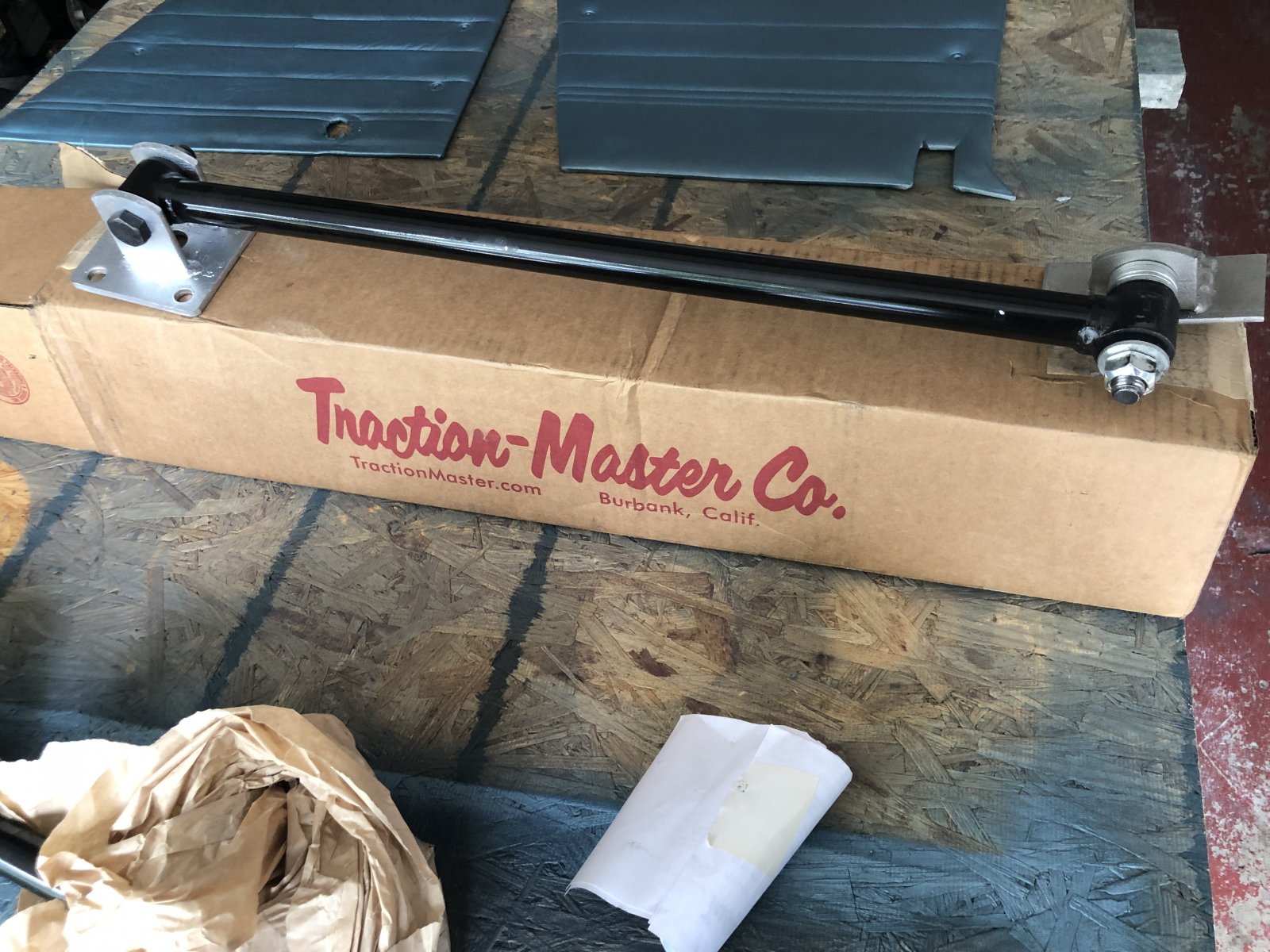

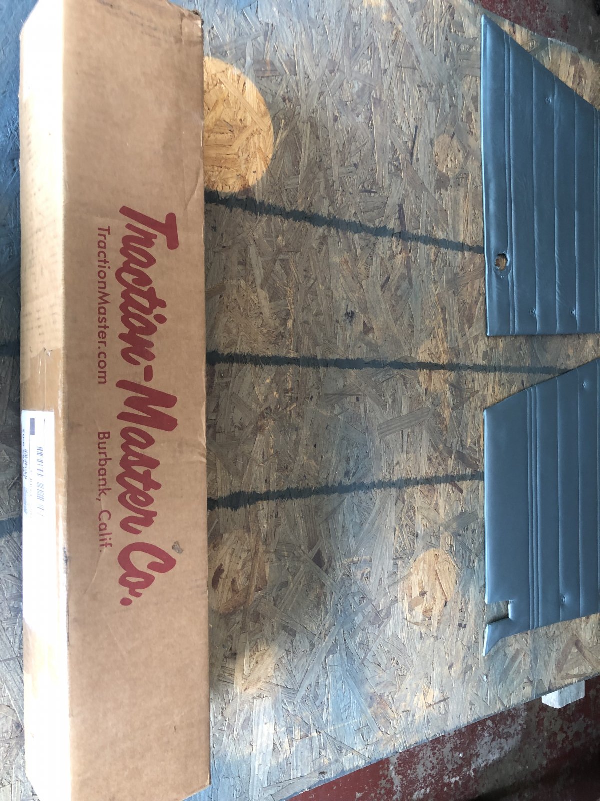

    Well they’ve arrived…Gold…nope….gold sticker…nope…Box is still cool and I’m happy to have gotten them. They seem pretty stout and I think I’ll leave them black…might see how much a sign shop would charge to make a little gold decal with that script to put in them…I’m a detail guy 781A477C-6C74-407F-9B4E-93916520740F.jpeg 8F4C9A81-EC49-47A6-9F5B-DF3E96A79A40.jpeg

    IF you run slicks and do hard launches keep a close eye on the single shear front end mount. I tore one apart not unwelded or bent but pulled the mount apart like it was cut with shears with a 67 390 mustang 4 speed.

    amazing that after 60 plus years they still only come with a single shear front mount. I would
    definitely recommend a retainer strap to prevent them from dragging on the pavement
    when the front bolt breaks

    You didn't ask, but I'd be inclined to add a half-length of an additional leaf spring to the front spring pack and clamp the front portion of the leaf springs....that's traditional too

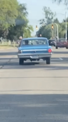

    Joe…mines sagging on the drivers side too…Wife took a video of me on the street and I noticed I got a little lean…strange I don’t see it in the garage..and yeah I’m 6’4 250, but I wouldn’t think that would do it..also hoping this could be just a weird camera angle..I’ll take some measurements this weekend...I figure that will be a winter project..and the Traction Masters will find a spot in my stash till next Spring..the Lakewood’s will get me by for the next 3-4 months of car weather we have here

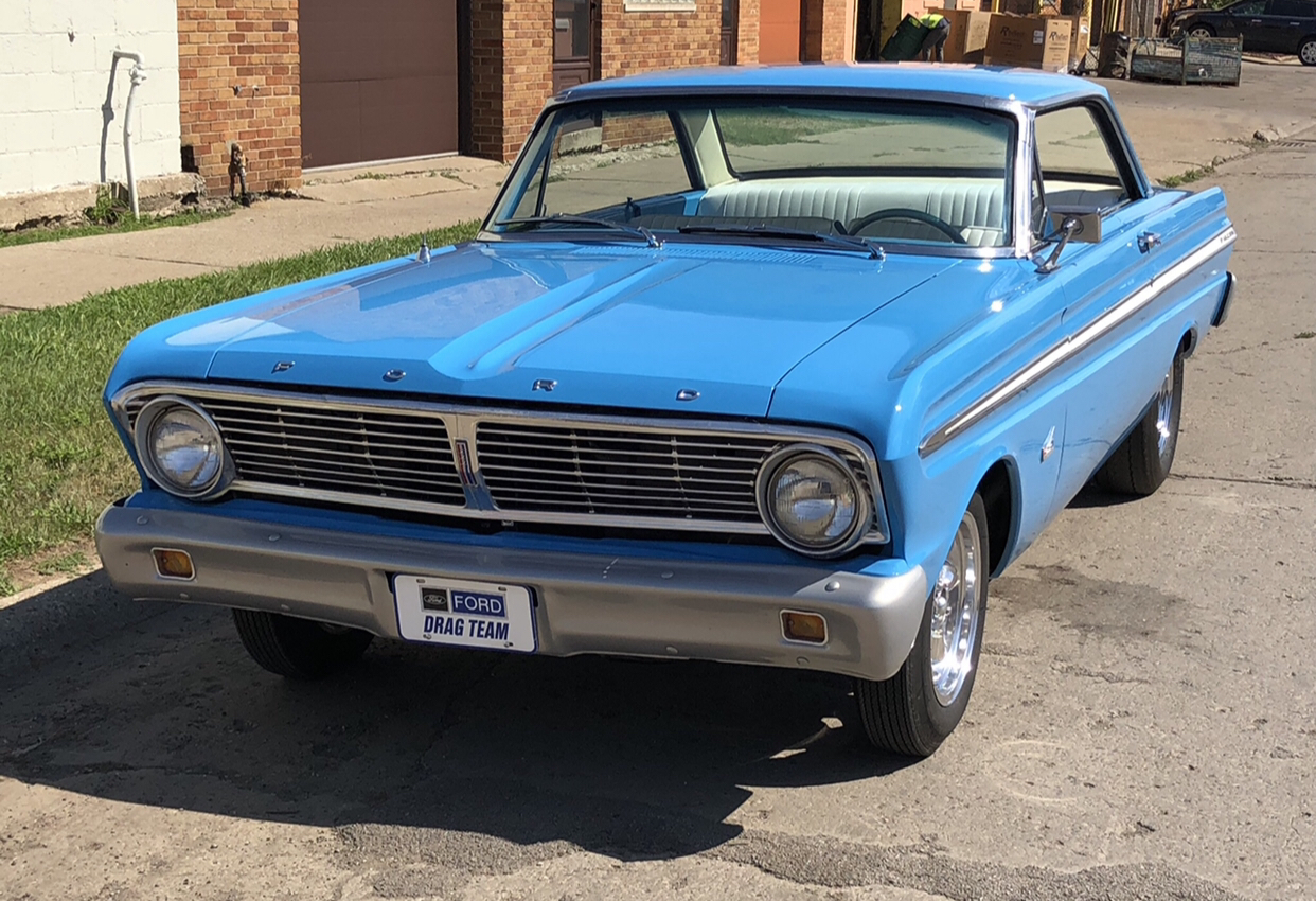

    Looks totally straight here..looks at the line near the back window..but that snapshot from the video makes it look like I should be listening to 70’s funk music while rolling down Whittier Blvd..

    Hard to tell parking on a street with curb and gutter. Grade pitches toward the curb for drainage. Park it on a level surface and measure from pavement to top of wheel well, then you'll know. You want to do that anyway before you weld the front bracket to the frame. I bet you can preload the spring if it isn't too bad by jacking the low side until it is level and weld it up. I wouldn't try that with a single sheer bracket, increases stress.

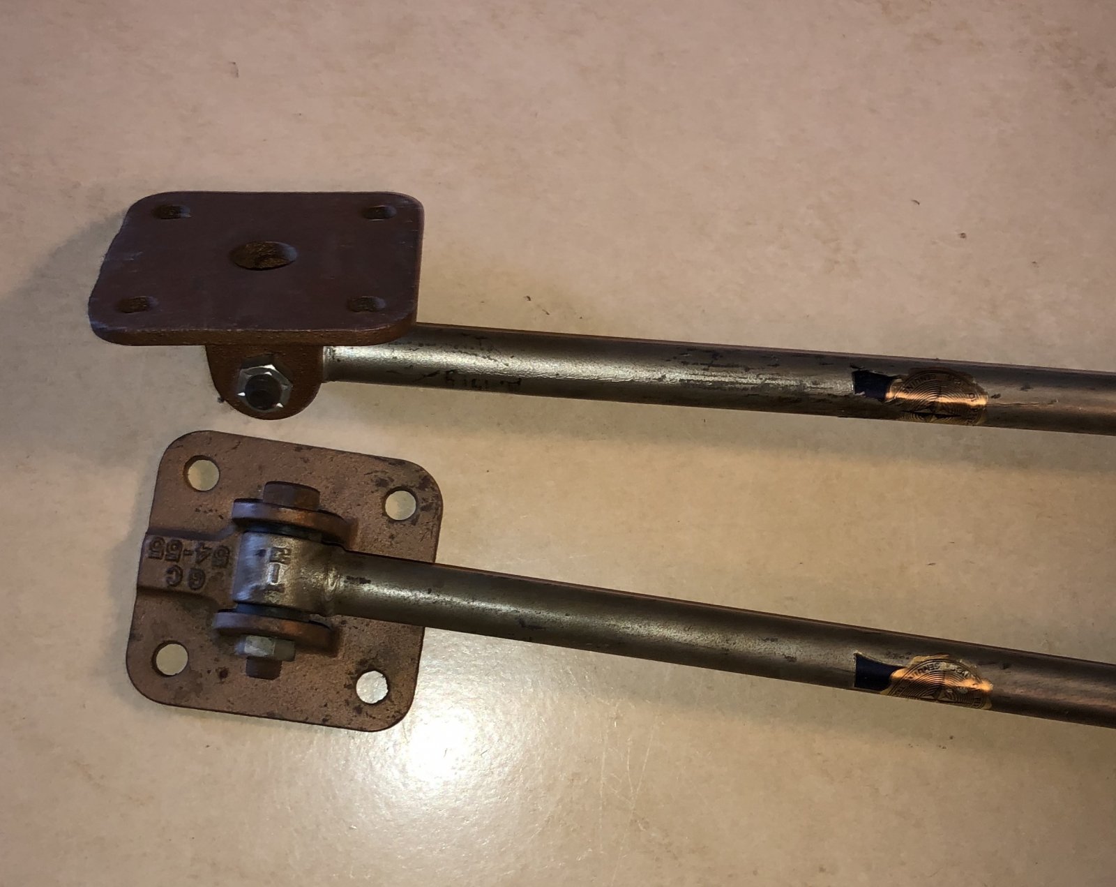

    fullsizeoutput_c0f.jpeg fullsizeoutput_c0d.jpeg Still have the Traction Masters I bought for my '56 Olds 2-door, hopped up, stick shift, back in '59. Don't have the Olds anymore, never installed the bars, now hanging in my garage. Still have the stickers.

    That's a nice looking Falcon.
    A few months ago, there was a Hemming's article about seven Canadian 65 Falcons that came from the factory with the HiPo 289. Ford America, however, did not allow American Falcons to be so equipped. Interesting story. The article also said at 2300 lbs, the Falcon was lighter than Mustangs. I think the latter weighed in at about 2800. 500 lbs is a big difference.
