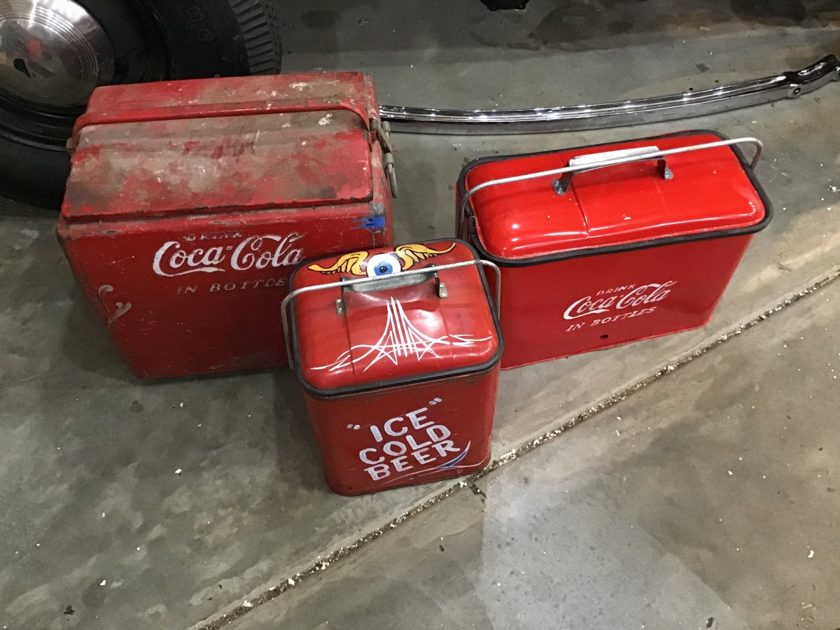

    I like to use vintage coolers like Coke Hamms ets ,as they are double walled metal and you can carry a good size battery and a hand full of tools or bottle jack. We stick this inside the trunk rumble area but have done them in the truck bed as well... they aren’t ugly and can drill a hole in the bottom to run the 3/0 cables and vent it as well.. image.jpg

    put mine in a coke cooler
    7car7 and continentaljohn like this.

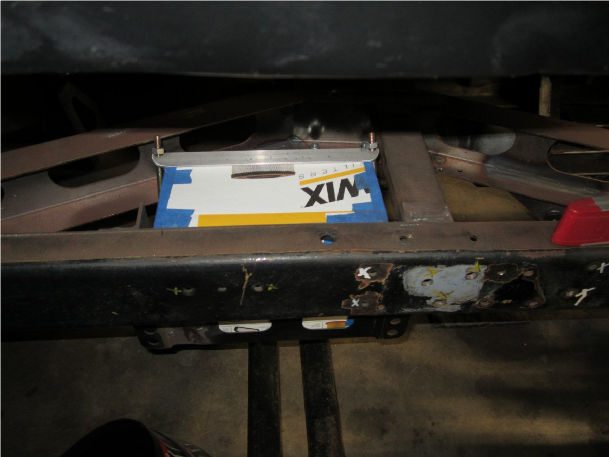

  7. On my '28 Tudor I went with a generic battery tray on eBay and cut it down to fit the group 51 battery I'm using. It's under the p***enger floor board.

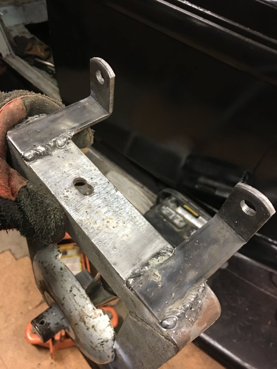

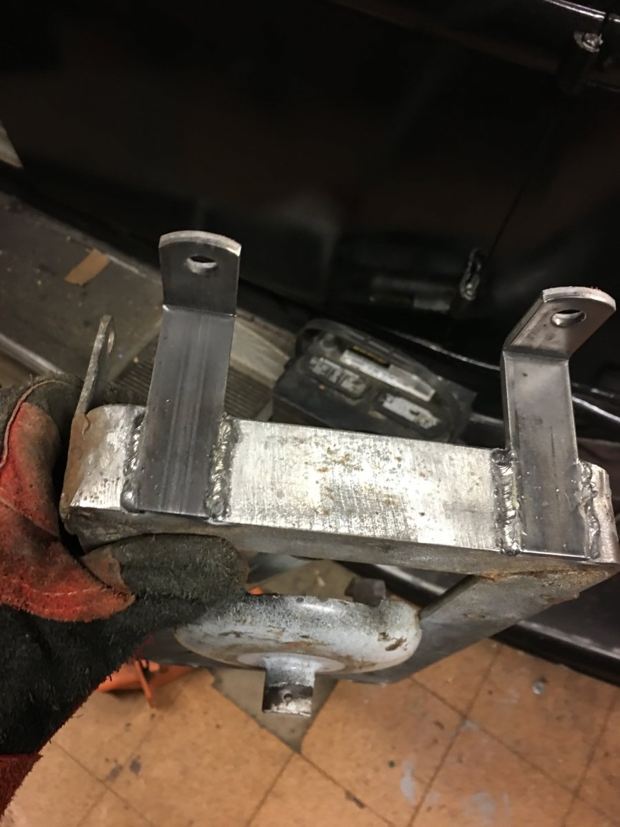

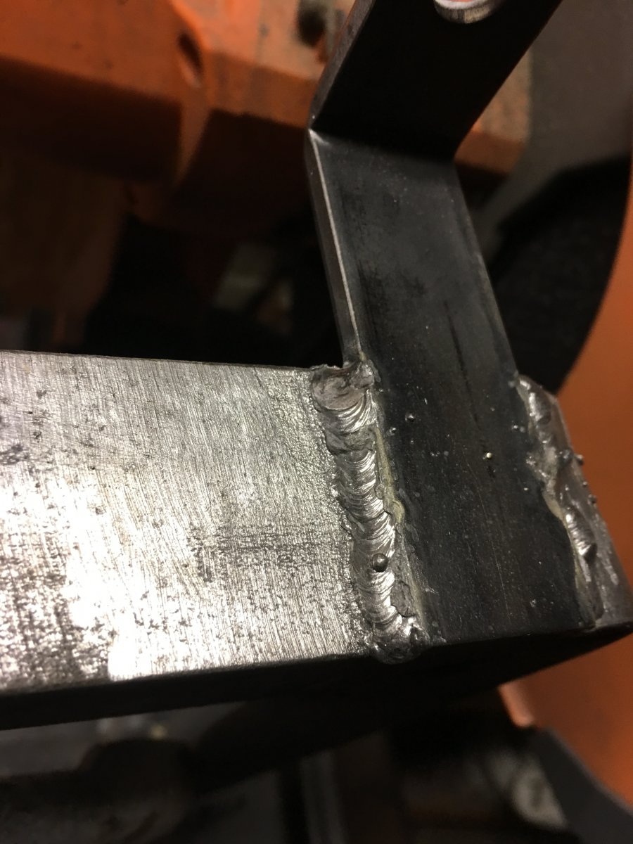

    That’s pretty slick, 1oldtimer. I just looked and i see those on speedwaymotors, too. i built this, recently, but i might have to grab one of those prefab units to try out, too.
    (The jack cradle is tacked on so i could position my battery/mount from below, just fyi.)

  9. I found the cheapest one I could (just happen to be on eBay and I wanted cheap as I was cutting into it). I ended up sectioning it length and width wise. The group 51 is mostly for Honda cars, is pretty small and in stock everywhere. I hung it pretty low under the frame and just made 2 braces to keep the cantilever movement to a minimum.
    I have to start back on the '28 again soon.
