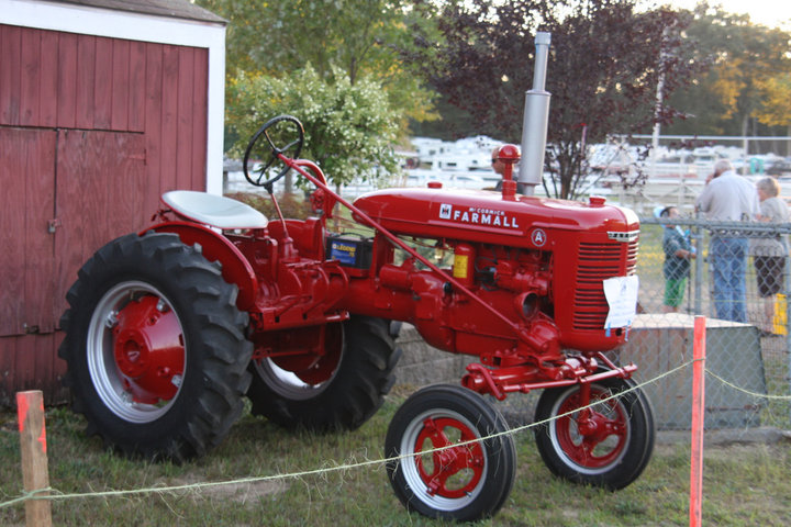

    we used the Valspar restoration series IH red on my tractor which we finished last fall. it has great sheen and its a great paint. We used a hardener in it and sprayed it with a gun. its currently housed under a breezeway next to the garage and house and its slightly exposed to the elements. I waxed it before bringing it to the fairs to protect it from any rain/wandering fingers. we opted not to put clear coat on top of the paint but i could only imagine what it would look like WITH it!! very pleased with it!
    This tractor isn't used for farm work anymore (although we could use it to do hay) and it's mainly used for fair displays and parades. When it gets dusty and dirty from sitting in the breezeway it comes out to be washed and cleaned.
