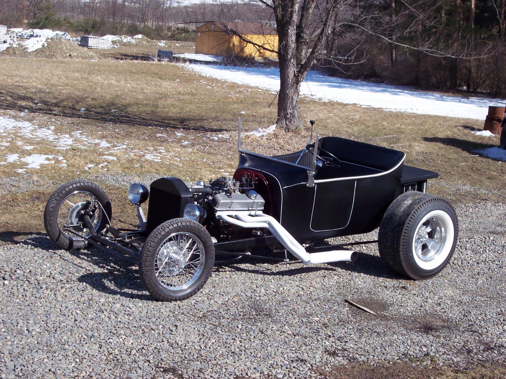

    These were both painted with the cheap TSC paint. The T-bucket is semi-gloss black. The VW is a mix of International Harvester white and gloss white, then flattened with tal*** powder. I've got less than $50 in each paint job.
