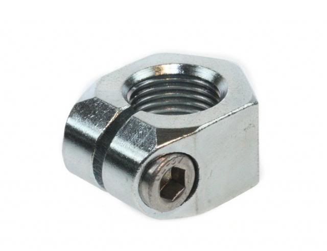

    I bought some Halibrand clone knock off wheels from Charlie Chops the other day. I want to use them on 46-48 Lincoln spindles with the original brakes. The Lincoln hubs will not work with the KO adapters. They are too long and fat. So, I am going to make new hubs with the KO provisions built in. The only problem is the castle nut that goes on the snout of the spindle. It will be recessed and there will be no way to set a cotter key.
    I thought about nylocks but they are not positive enough for me. Then I found these gems. Ford tractor wheel wheel clamps. Never seen them before. Do you think these would be suitable for automotive use? How do they work? The little tab on the insert throws me a curve.
  2. Thats kinda neat but what stops the lock nut backing off ??

    It looks as though the outer nut would have to completely fall off to fail.

  8. Thanks guys. I am most likely going to buy a set and see if they can be made to work. The clamp with the hex has the same problem as the castle nut and cotter key. No access. Charlie's drift pin and other ideas have merit and I will give them a thought. The big problem is maintaining the stock Lincoln brake drum flange location. Ford and Wilson welding hubs fit the lincoln spindle but they do not locate the drum in the correct relationship with the inset 46-48 Lincoln backing plates. It is going to take some figuring and fabricating but I am sure that it can be done.
