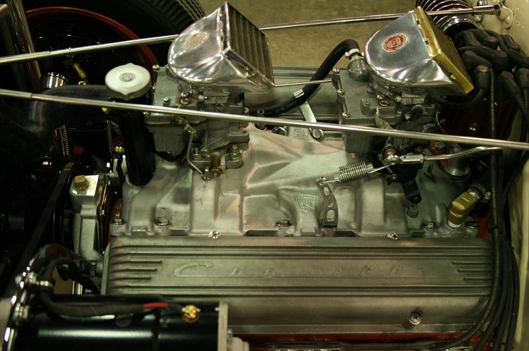

    I have to agree 100% with his comment. NO one ran those back when a hopped up 283 was normal to have.
    The hot lick would have been a 3x2 carb setup or a factory Corvette 2x4 intake with the little Rochester carbs and Corvette Finned valve covers. The power pack heads or camel hump 194 heads like shown in ptost 14 would finish off the look and be the right parts. The main thing is no visible bolt holes in the front of the tiheads for mounting accessories or you blow the **** out of your traditional theme and it's just another small block Chevy engine.
    falcongeorge and bowie like this.

    I like my Fenton 3x2, the Weiand WC4D 4x2 is a cool one too.
    bowie likes this.
