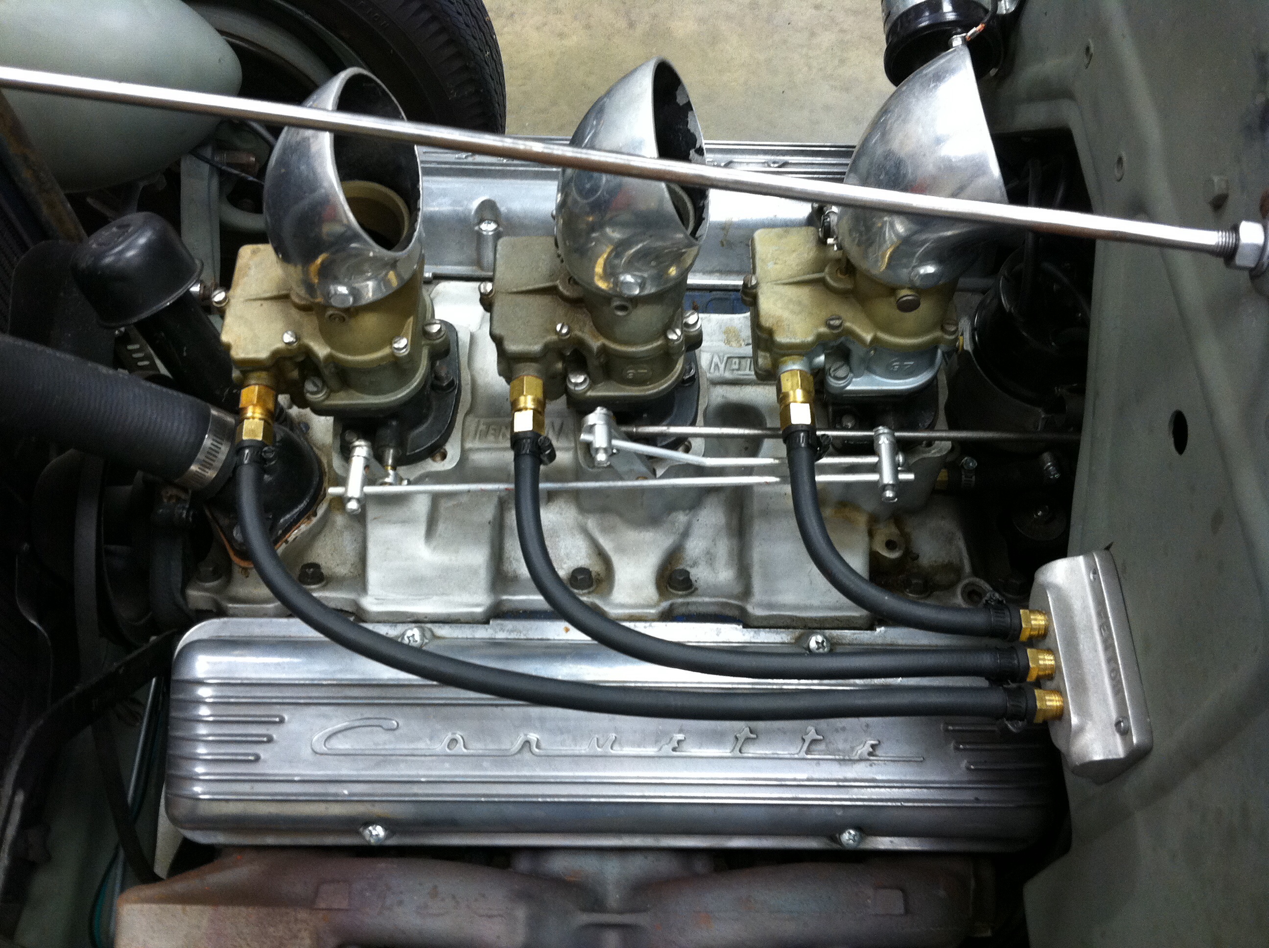

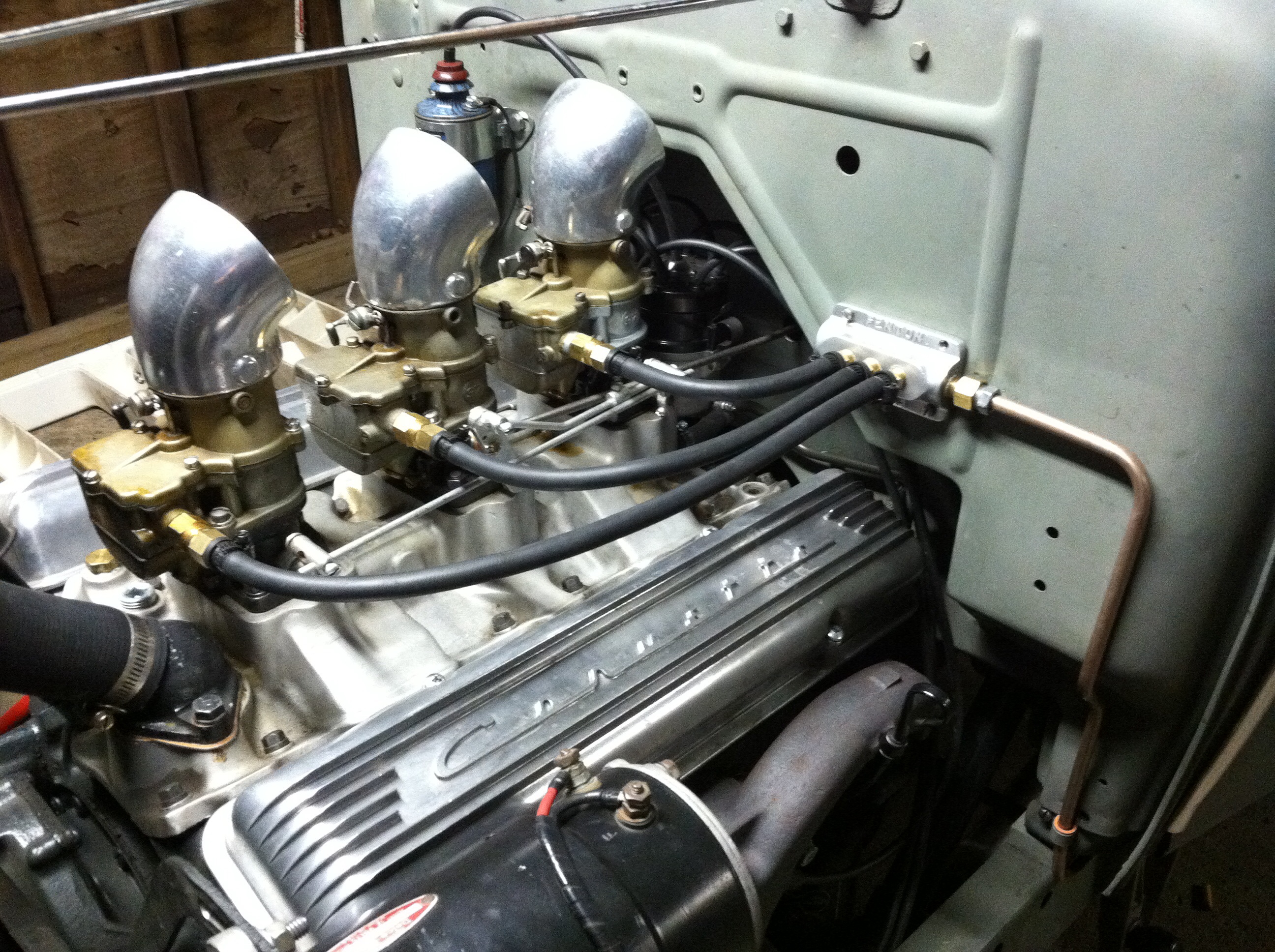

    Here's my 1957 283 in my A pickup. It's a front mount only block with a hurst mount and an oil canister.
    3731539 heads
    Howards hydraulic cam similar in specs to the GM 30/30 cam
    Vintage Fenton 3x2 with oil fill tube and three 97's and vintage frog mouth scoops
    Vintage Segal progressive linkage
    Corvette valve covers
    Vintage Mallory dual point
    Chevy 4 blade fan
    Delco generator
    Rams horn manifolds
    Here's a couple pics:

    Absolutely awesome!!

    I like the firewall clearance for the dist. The whole compartment is neat and clean.

    I like the 4 lobe Mallory dual points. Point wear is very low; although finding points may be an issue.

    Thanks. I don't care for the look of flipped firewalls on 30-31 model A's for engine clearance. When you lose the rounded edge to the firewall at the cowl it just doesn't look like a model A to me anymore. You also lose toe board too. Not a lot but 4" of leg room in an A pickup is a lot. Just under the valve cover clearance area my recess angles forward to the stock toe board location. No modification to my floor.

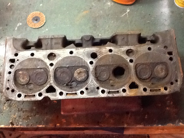

    Got a stuck complete 283 with power pack heads from a friend. Pulled the heads......full of rust. I'm not smart enough to know if there salvageable...guessing not. ImageUploadedByH.A.M.B.1415461714.455371.jpg

    They should be salvageable. Have them cleaned at a machine shop. As has been said, hard valve seats should be installed so even if the valve seats are very rusty it shouldn't matter.
