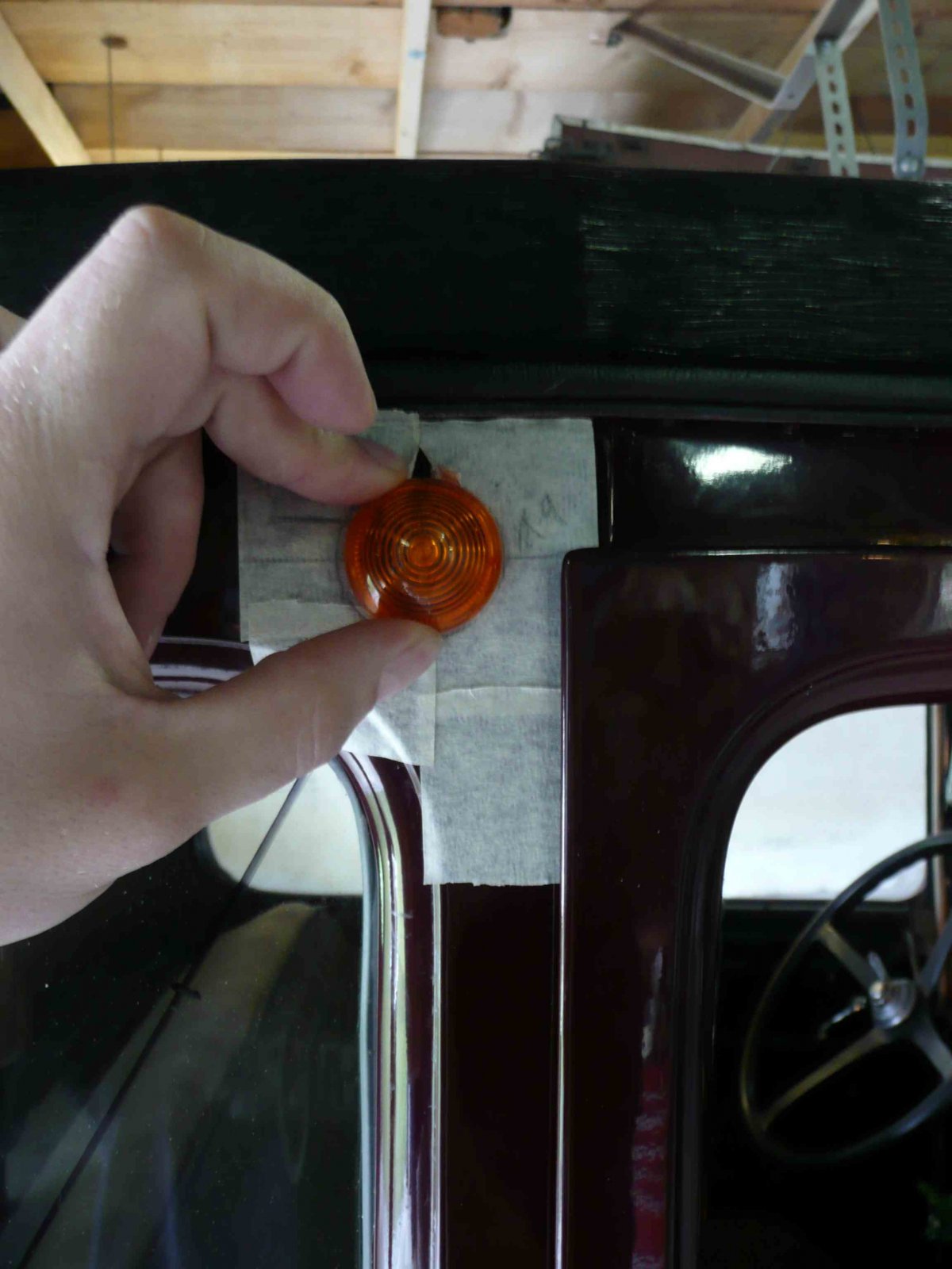

    Started with the cables for the flashers.

    First thought that flashers on the B post (you call it like that) will be enough, but after installing them i recognized, that they are not really seen from behind the car. I don't really like them at the time, so I think will get rid of them again.
    After that i got rid of the metal plate in the floor board, 'cause I think a little flap of wood would look better. So i cut it and trimmed it looking old with oil, and flames. Also trimmed hinge and the lock by burnishing it in oil.
