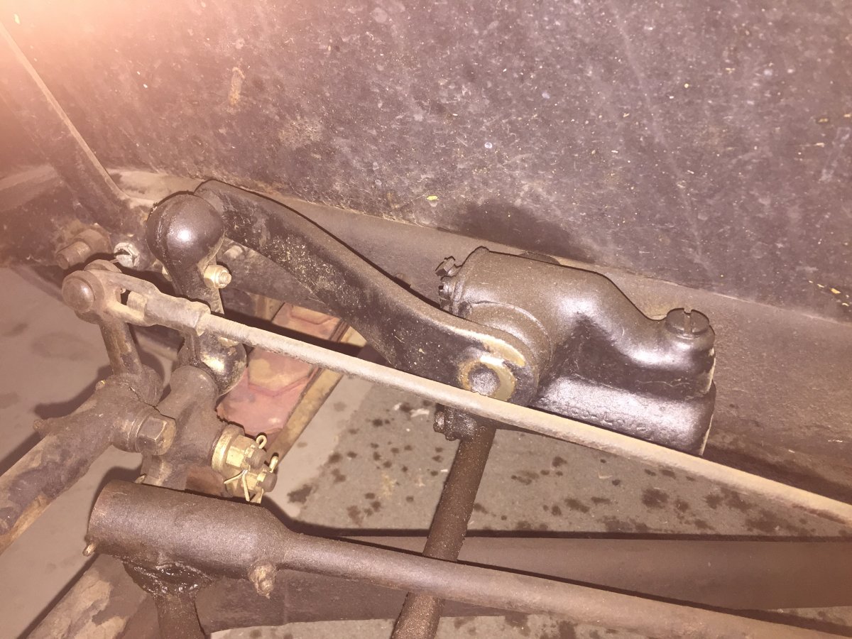

    Ah really nice. Through the frame works better on yours. I kept the mechanical brakes so I didn't have the space to mount them like you. That was my original plan before I noticed I don't have the space

    Yes. They fit there with the original perches. But I had to modify my perches and weld a piece on top so I can still run the mechanical brakes with the dropped axle. Cause of that piece I couldn't attach the shocks to the perchball. That's why I had to attach the them to the wishbone some inches back. So the shocks didn't fit between the frame and the brake rod.

    I like the way you modified the mechanical brakes for the drop!

    Thanks. That worked out pretty good. First thought it could be too weak, but there's no bending event if I apply full power on the brakes.

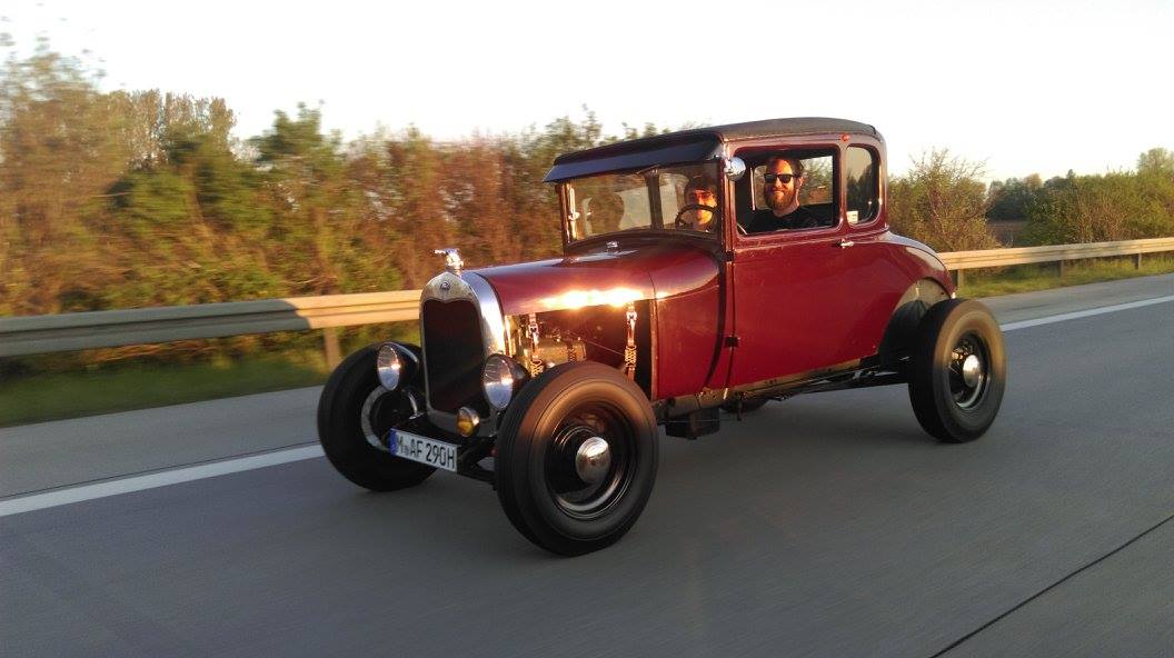

    @Dannerr: yes. hope to meet you some day. Didn't think about the romo motorfestival yet. But maybe sometimes. Next year I'll hope I can make it to Pendine Sands in UK.
    time for a little update. The Model A is on the streets since march and has driven about 2.500 miles without any bigger problems since then.
    In May we had a nice backyard BBQ at fellow hamb member Baumi with a 155 miles trip. The A did it without problems.
    After the BBQ I took the A to Italy to visit my cousin. It's about 300 miles over a 6.500 feet p*** in switzerland. Everything worked out good. Engine didn't get hot and the original brakes did a good job when driving down the p*** in 10 serpentines. And it made it up the p*** with about 35 mph.

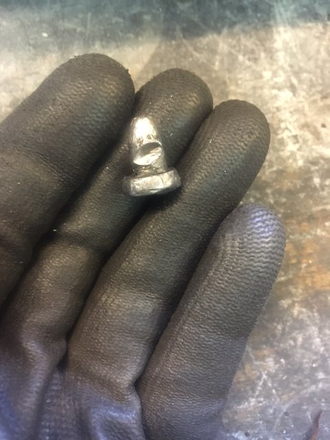

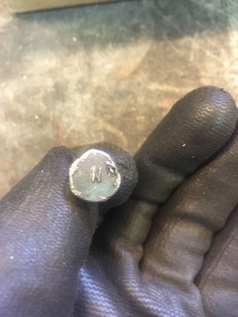

    About 1 mile before reaching my cousins house I said to my girlfriend: "The Model A really made it to Italy!!!" - Big mistake... 30 seconds later I heard a "CLUNK" and the engine stopped. So we towed the car to my cousin. Opened the cluch and the transmission, but didn't find anything. The engine ran, but there was a irregular clunking sound in the bellhousing. Didn't hat the opportunity to completely open the clutch there, so I got me a rental car and the Model A came home on a trailer.
    At home I checked the clutch again. And not wanting to pull the engine you check alot, not to do that. So I pulled the starter and searched for "something" in the bellhousing. After 45 minutes of stirring around, I finally got out a bolt...
    Last year the bold of my starter spring broke. I thought I got everything out, but i didn't. So that little f*cker was the problem. Put everything together again and since then, the car is working perfectly again.
