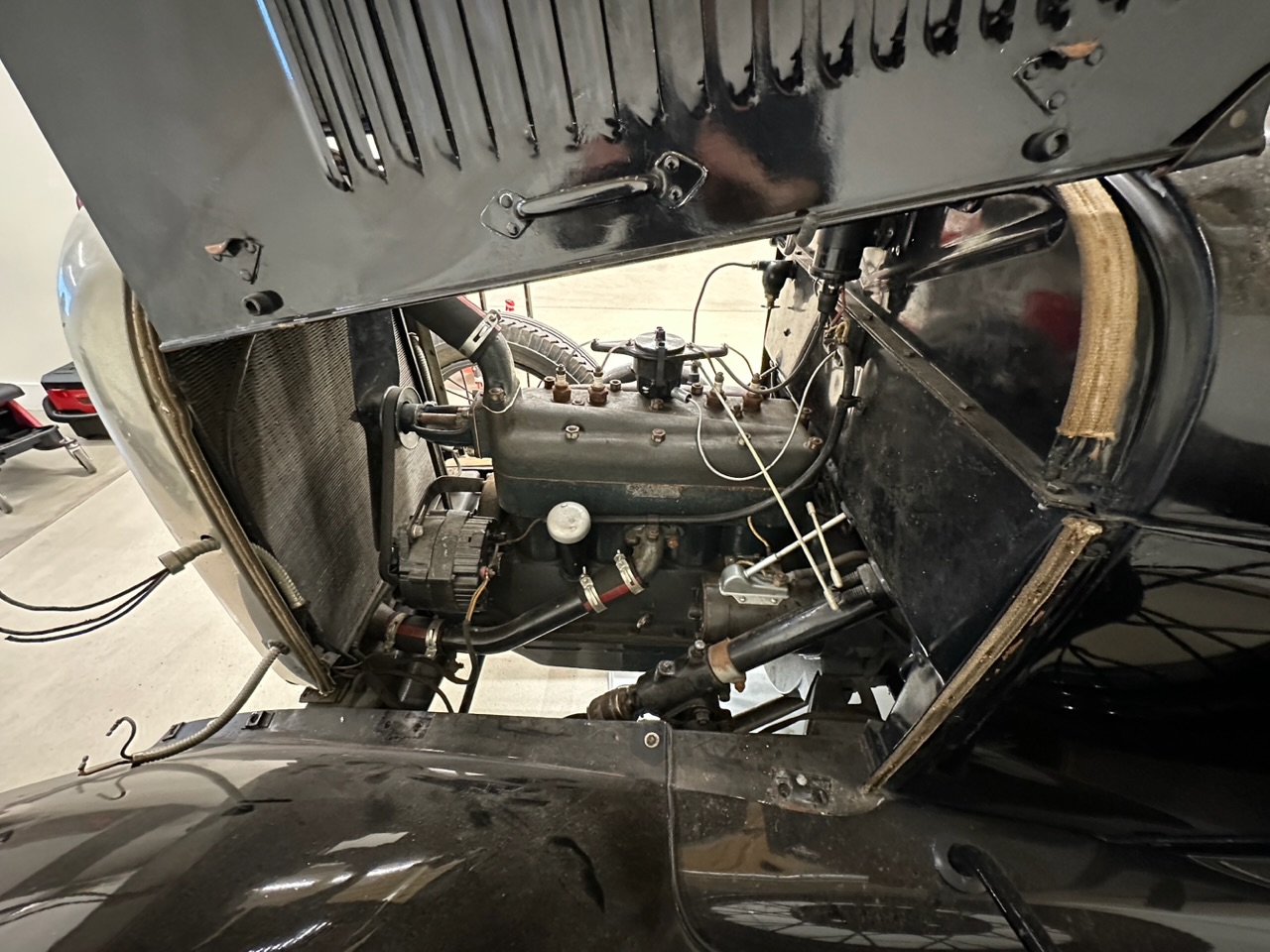

    Some pics from when it arrived

    And after stripping it down a bit - left side aprons and rear bumper in for now - will tackle those later

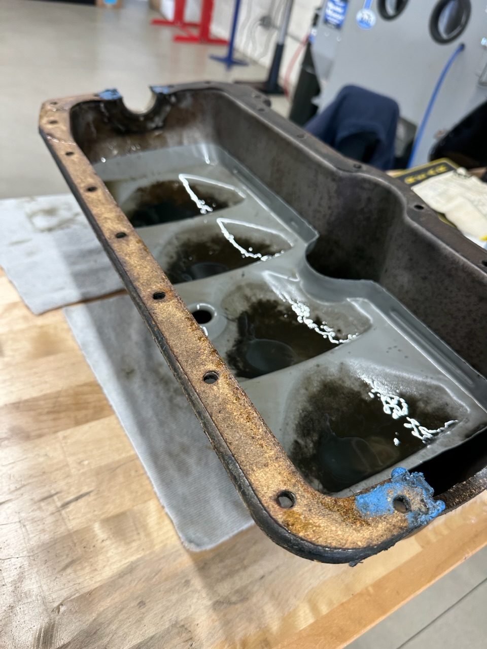

    Some sludge but not too bad

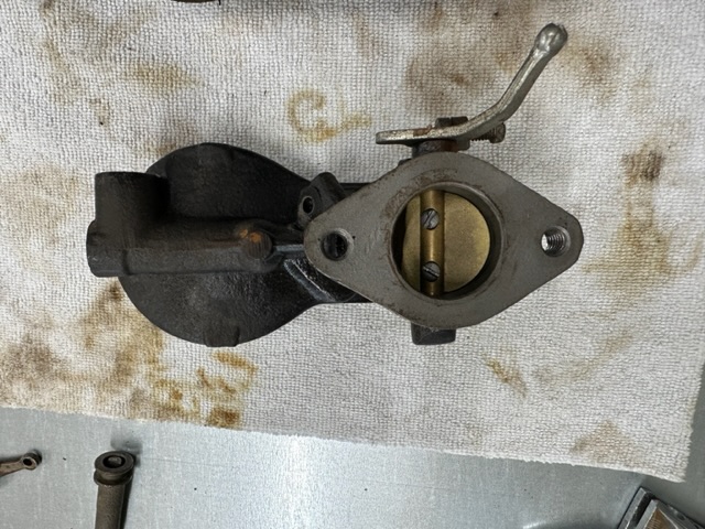

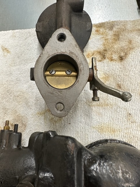

    Cleaned and rebuilt the Zenith - was leaking when it went back on from not fully tightening down one of the jets - leak free after tearing it down again…am planning to run a single downdraft but am focused for now on getting the car running after it has been sitting for an unknown period of time

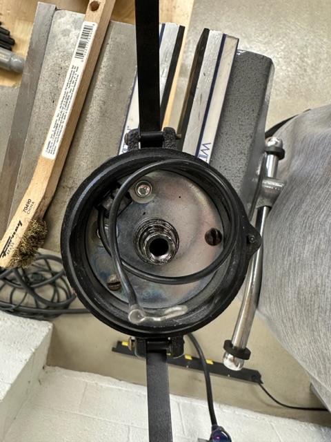

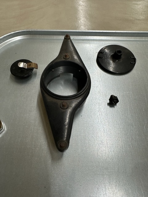

    Distributor was in good shape - modern points - set points, ran the shaft through the wire wheel and wire brushed the plug contacts and it cleaned up nicely IMG_0261.jpeg IMG_0263.jpeg IMG_0268.jpeg IMG_0275.jpeg

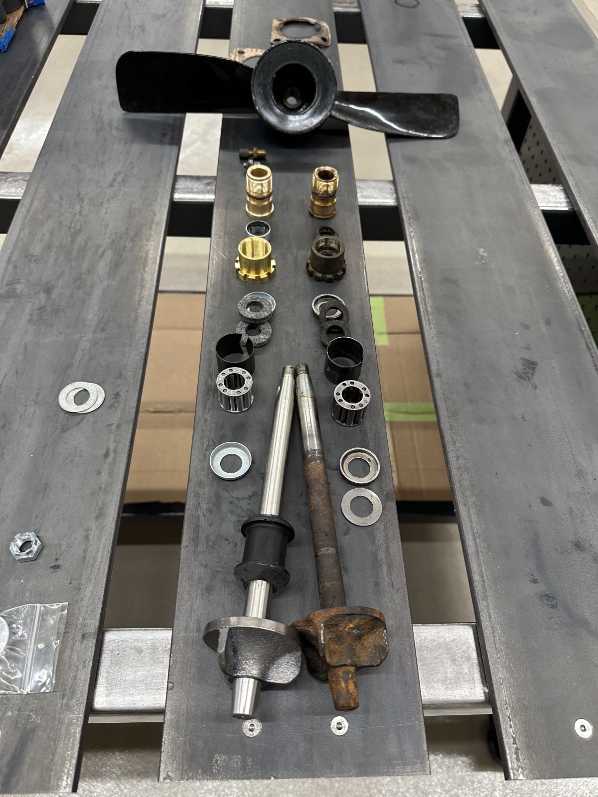

    Next up is water pump rebuild and inlet / outlet replacement

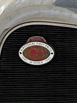

    Hopefully it will be a lot better when I am through with it! The radiator badge will definitely need to go back on at the end of the build

    If you want easy performance, single downdraft intake with a different carb like 97 Stromberg or Holley 94 is where it is at for easy bolt on performance.

    That baffle will pop out of the pan, exposing the underside. Might find some sludge down below.
    Looks like a pretty solid car, good luck.

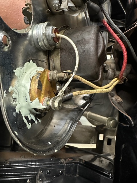

  18. Nobey
    Joined: May 28, 2011
    Posts: 1,517
    Nobey
    G_Don, chryslerfan55 and Jet96 like this.

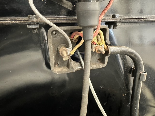

    Thanks Nobey - I took the baffle out (was a bit of a bear to get out) and cleaned the bottom of the pan - just did not take pics.
    Appreciate the advice on the ammeter - I have the plastic nubs that thread on above the terminals just did not have them installed when I took the pic - ***ume those were there to prevent any accidental grounding to the tank?

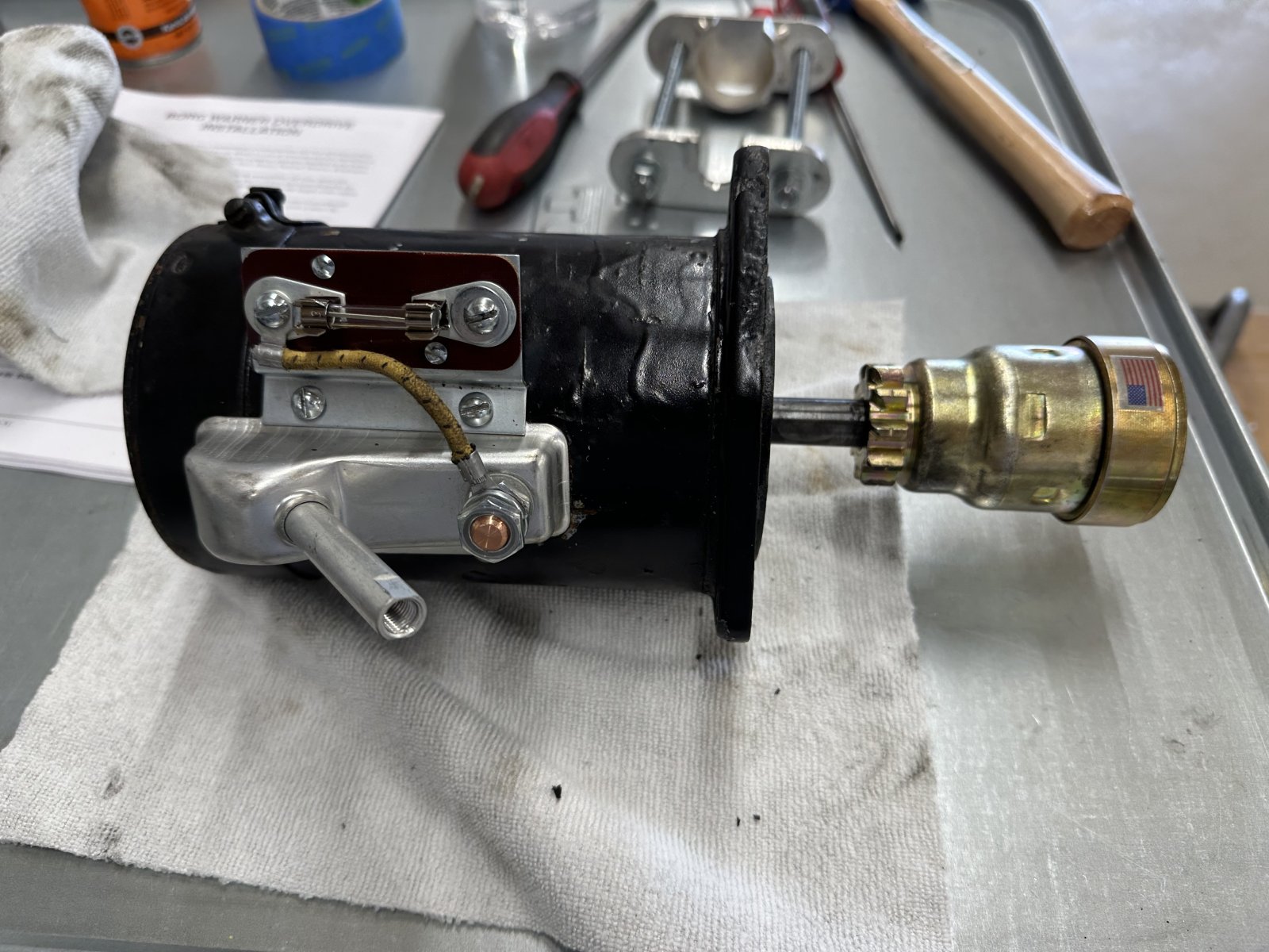

    Bit of progress today - got the water pump torn down and the housing painted. Also installed a modern bendix for the starter.

    I second removing the oil pan dipper tray. Mine had tons of sludge underneath.

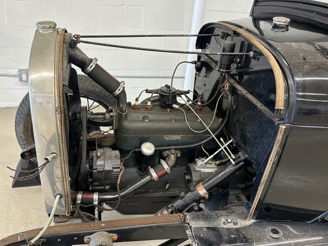

    Thanks Hitchhiker - 6.0 high compression head and FS Ignition are on the buy / build list. Have a set of Ted's floaters already which will be installed when I tackle the brakes (and am planning on new cast iron drums). Haven't given a lot of thought to gearbox yet but appreciate everyone's input about. I just finished rebuilding the water pump today so will see how I did when I put the radiator back on....

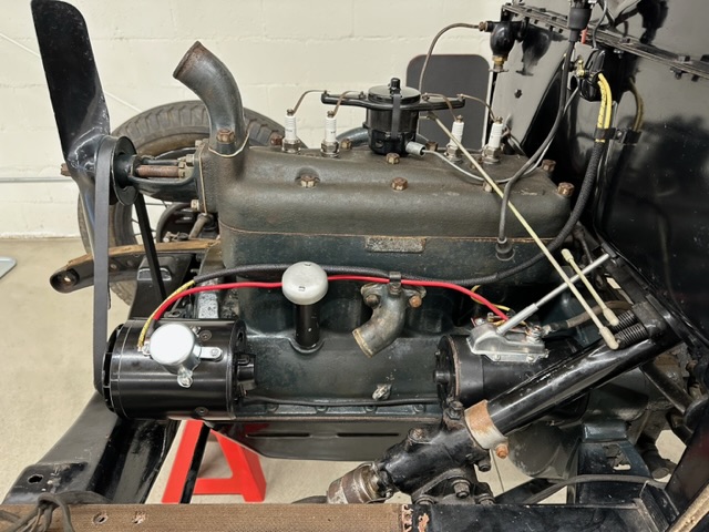

    Today’s progress…

  29. Hitchhiker
    Joined: May 1, 2008
    Posts: 8,594
    Hitchhiker
    Perfect. You'll have a real runner with that stuff on there. It's fun to start stock and upgrade as you go too. I'm sure the pump will be fine....for awhile. Potentially many years to come. I've put A LOT of miles on my truck over the last 10 years. I'd say the water pump was easily the biggest reliability issue before I went with the leakless pump with sealed bearings on both ends.
