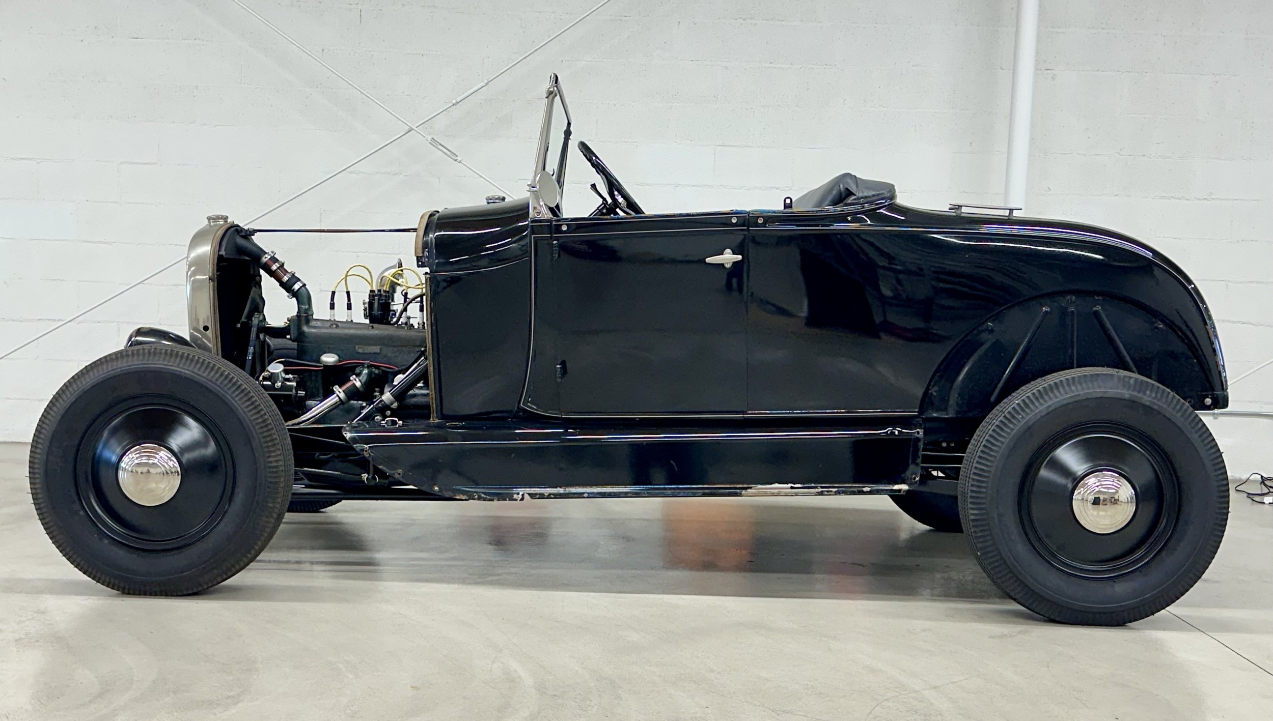

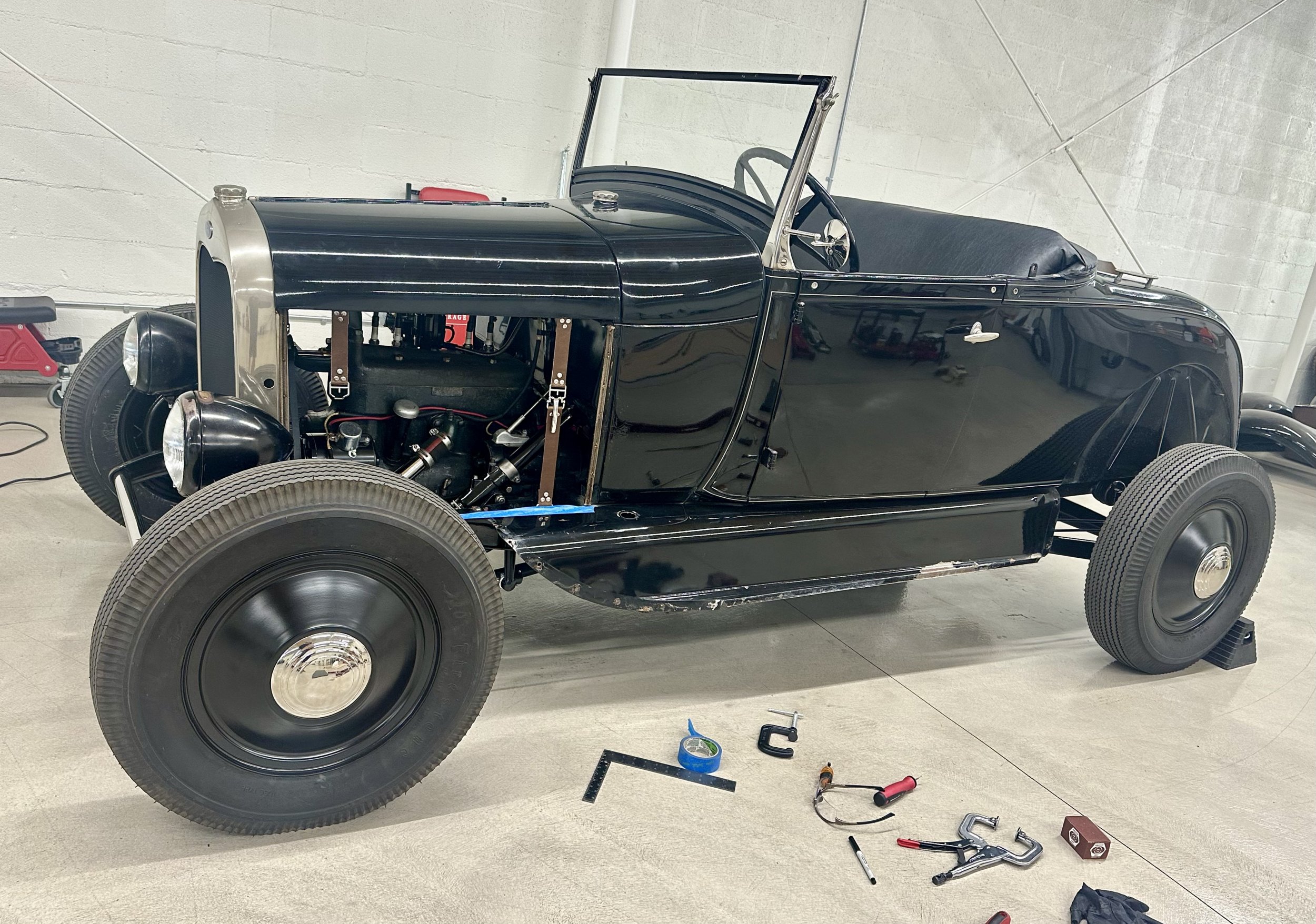

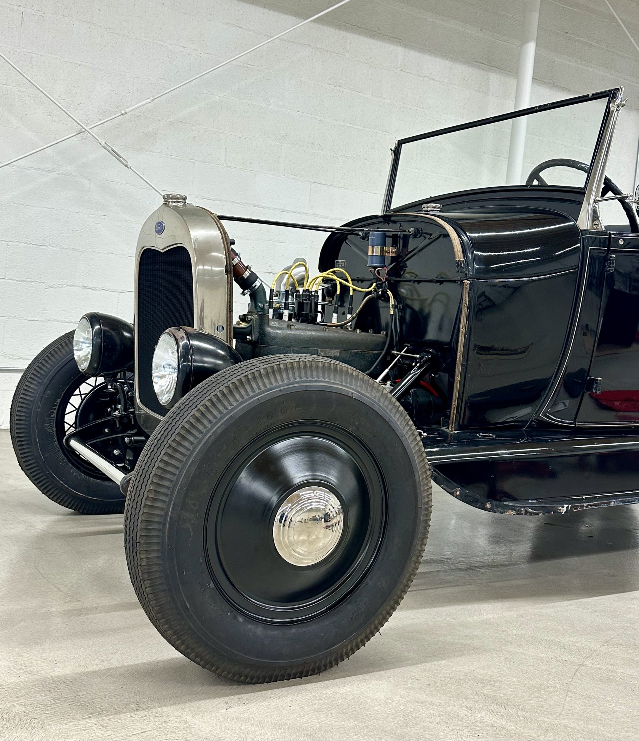

    Decided to try out some Brewster caps to see how they fit the car - really pleased with the way they turned out. Only drawback is they need to be removed to add air to the tires.

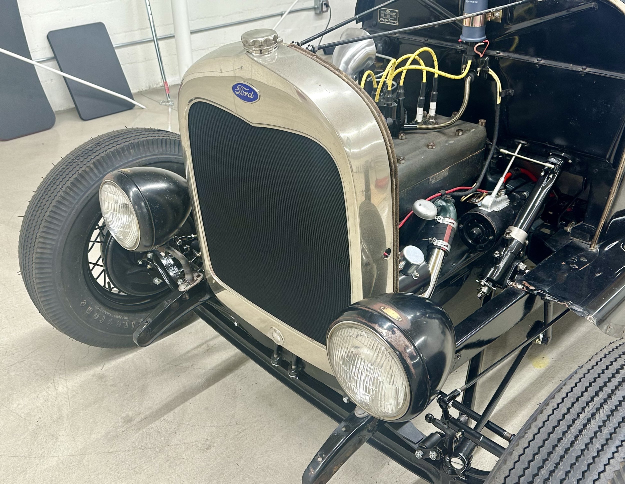

    Richard - I appreciate the kind words on the headlights - agonized over them a lot.

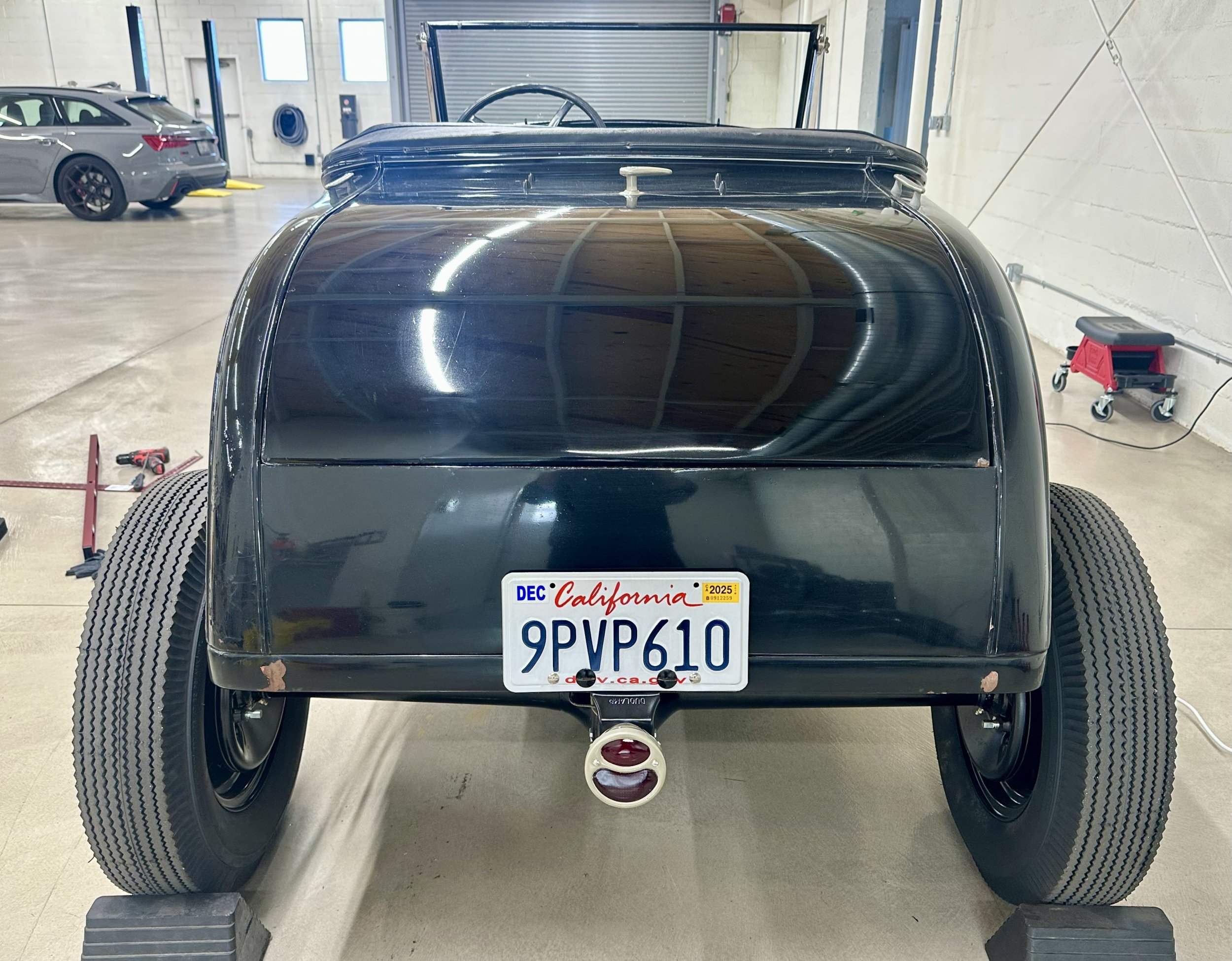

    Managed to chase down some grounding issues with the headlights and taillights and everything is working now. Got some plates on it as well - need to find a set of vintage plates to replace the modern ones but that is lower on my priority list.

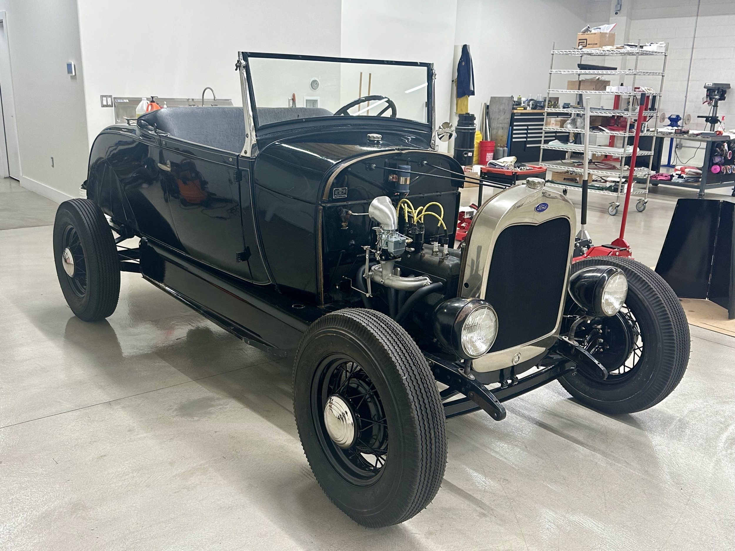

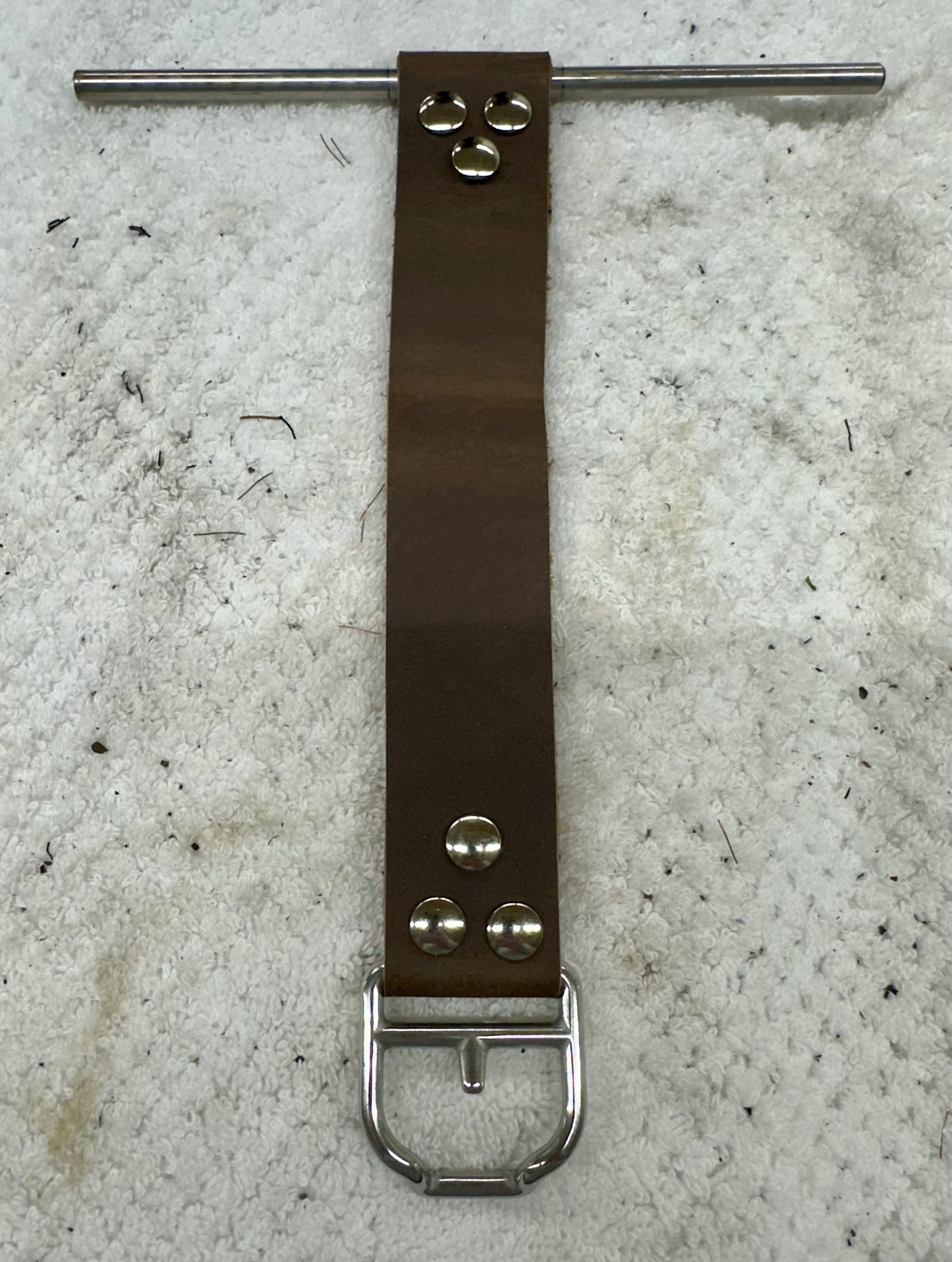

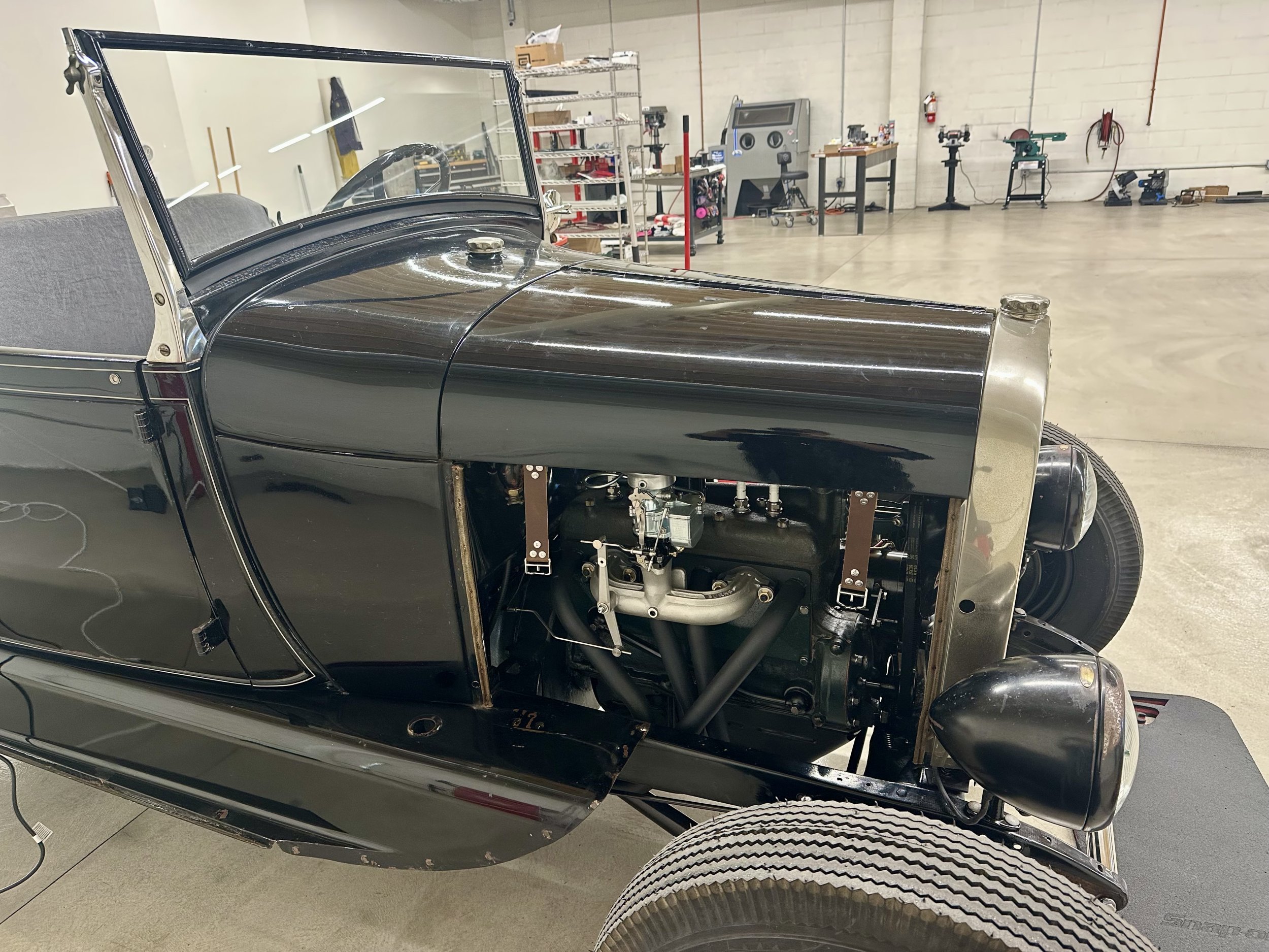

    Started work on fitting the hood and dialing in the straps - am really happy with how the first one came together. Will definitely take some fine tuning but that should be easy once the footman loops are in place.

  7. winduptoy
    Joined: Feb 19, 2013
    Posts: 4,312
    winduptoy
    I understand you wanting to get the hood tied down....nice....but now it time to wear those ***s off the tires
  8. reffiesj
    Joined: Dec 10, 2018
    Posts: 192
    reffiesj

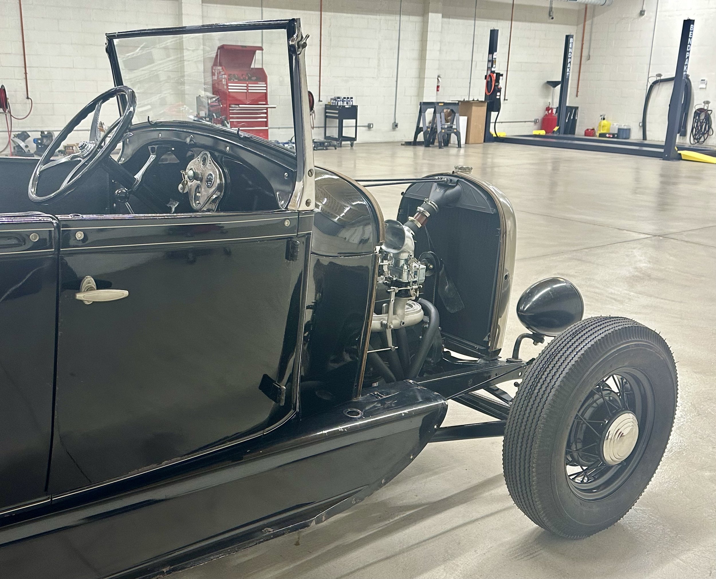

    Winduptoy - am getting very close to having it out on the road - just need to chase down an upper radiator hose leak (waiting on some Permatex #2 to be delivered) and then I can start wearing down those tires….in the meantime I got the rest of the hood straps installed.

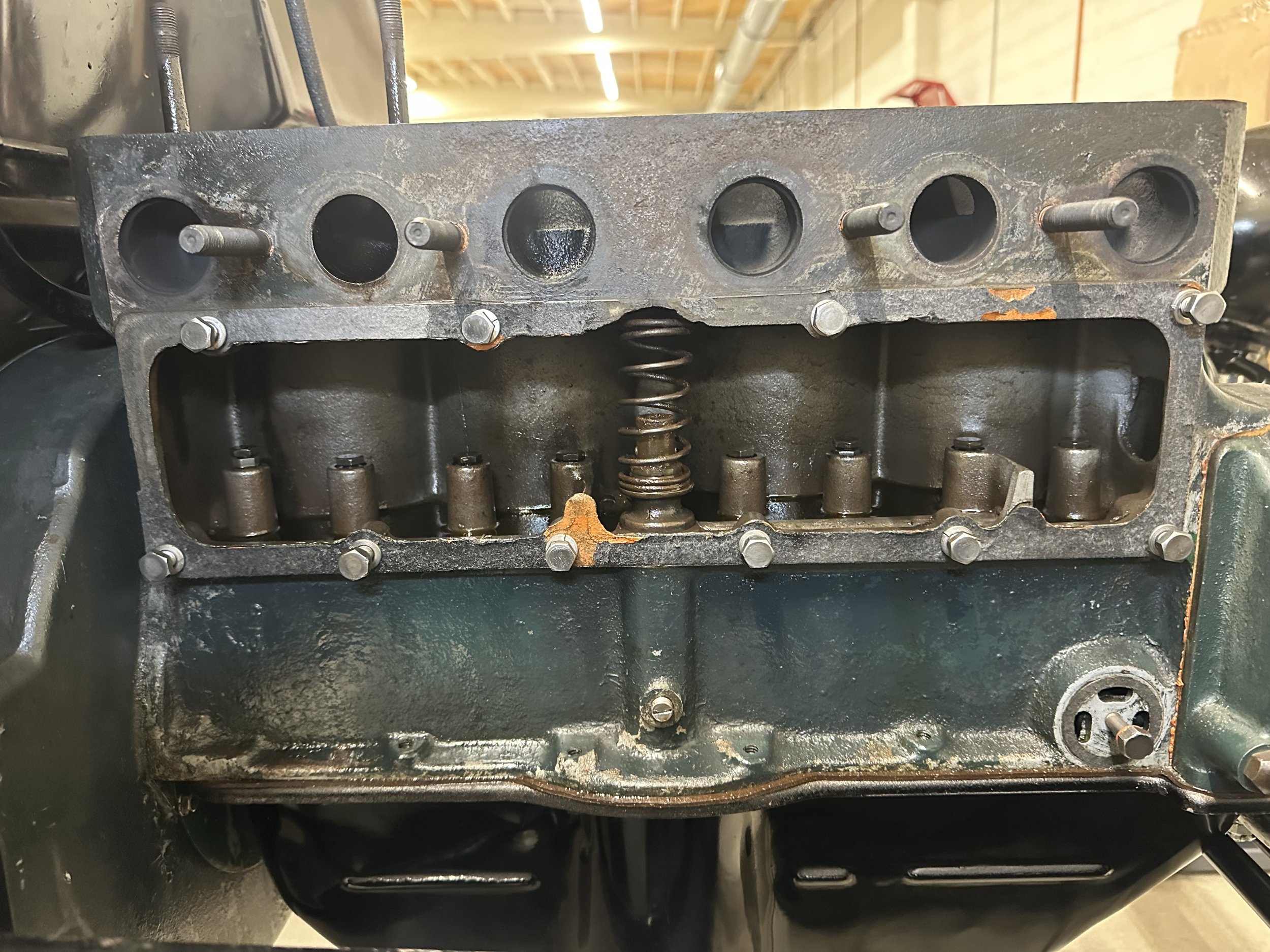

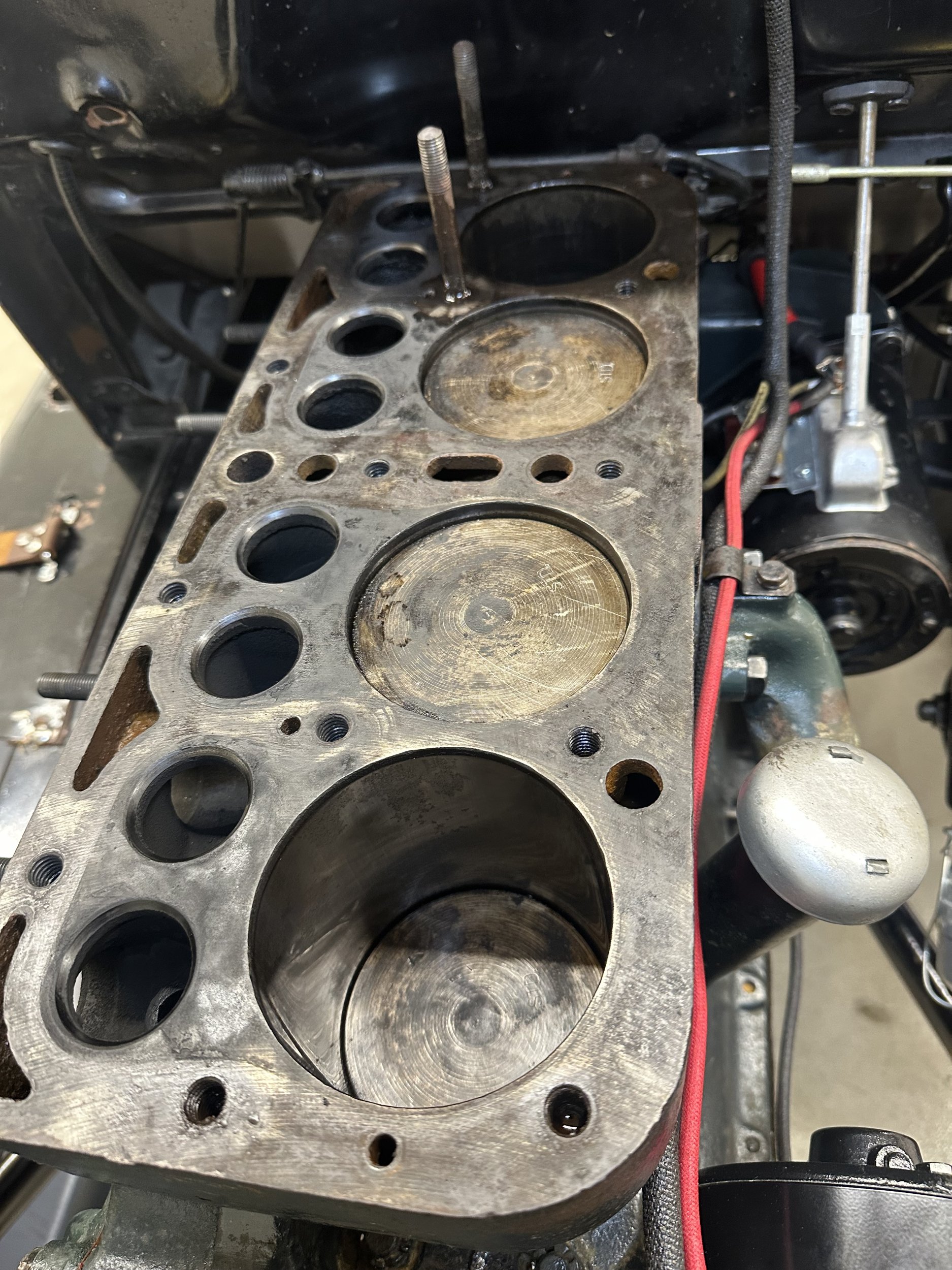

    Got the valve train out - not too bad except for one valve guide that was lodged in really tight. Eventually lots of Kroil, some heat and a BFH got it out. Two head studs also did not come out right away - am going to pull out the Kroil, induction bolt tool and snap on stud removal socket and see how it goes IMG_2636.jpeg IMG_2637.jpeg
    richard noble and ZerroHalfcup like this.
  16. Kevin Pharis
    Joined: Aug 22, 2020
    Posts: 753
    Kevin Pharis
    from Califunny
    Wowza! A standard bore A bone! That’s sumpin you don’t see every day

    Kevin - I was a bit surprised to see it as well!
    Charlie - thanks for the recommendation - thankfully I didn’t need it - last two came out after a few cycles of heat and penetrating oil.
    Hitchhiker - thanks for the support!
    Head studs out and ready for next steps…

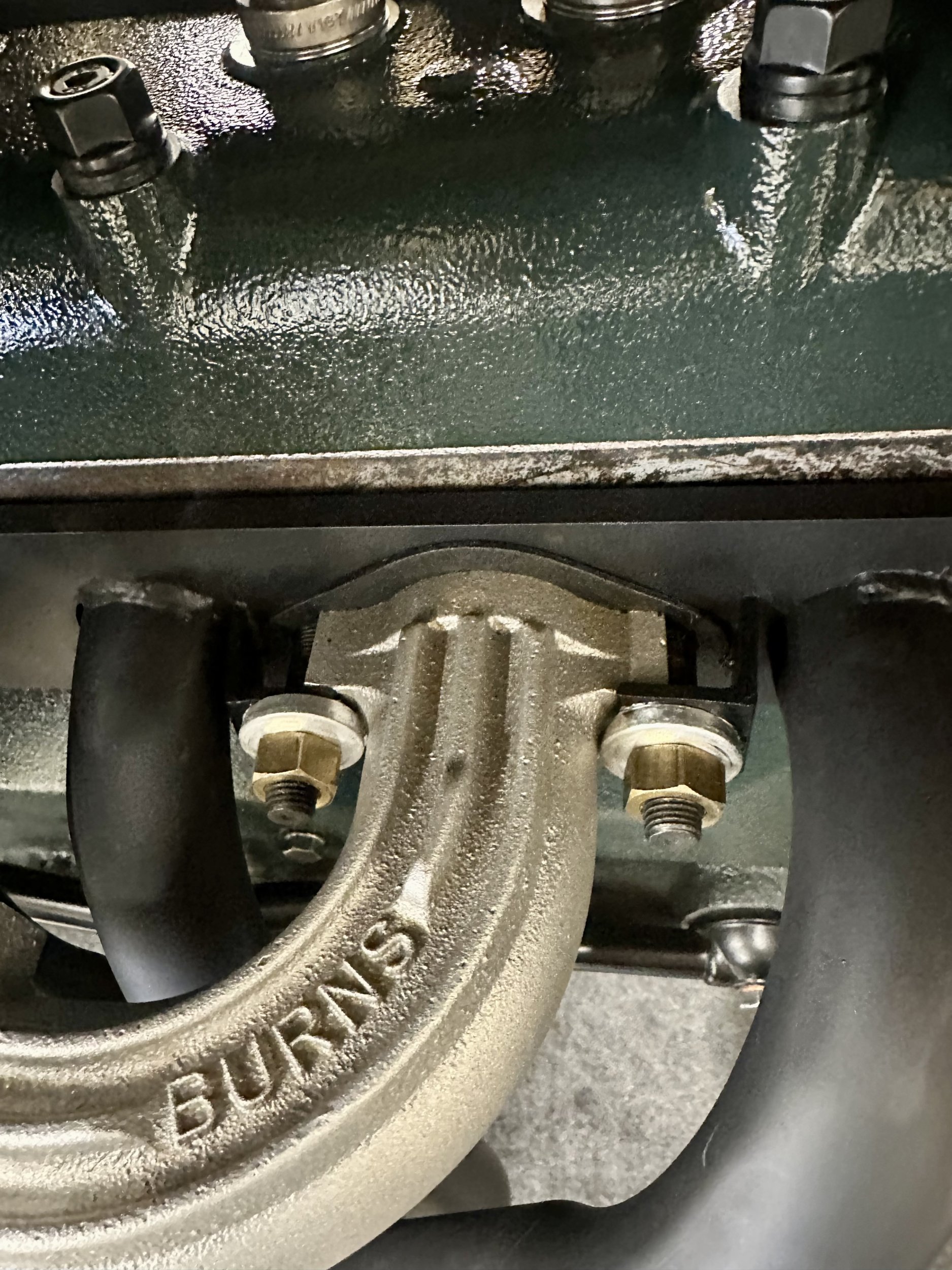

    Got everything back together and reasonably dialed in. I was fighting a lot of popping and backfire under load which turned out to be air leaking in at the intake /exhaust manifold. Seems to be running well now. Others may know this, but it turns out my exhaust washers were backwards - proper install is with the concave side facing the engine - hoping I can save others a little bit of grief….
