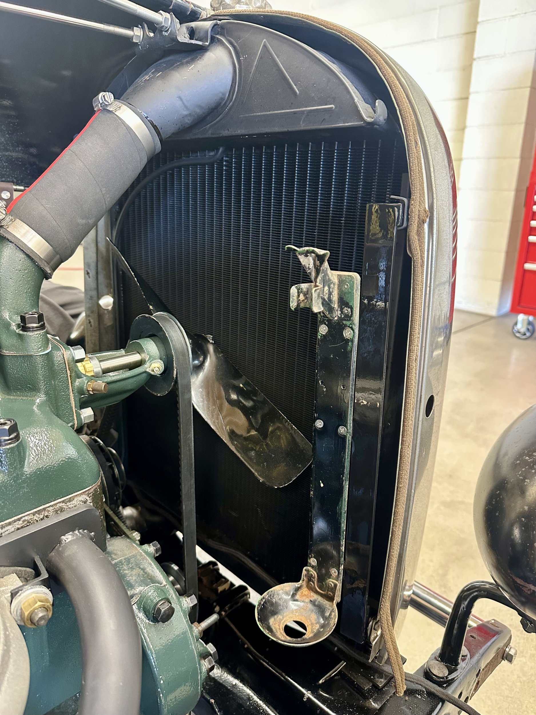

    Overflow tank installed and drum retainers painted. Getting close to being fully prepped for RPM Nationals and Antique Nationals!

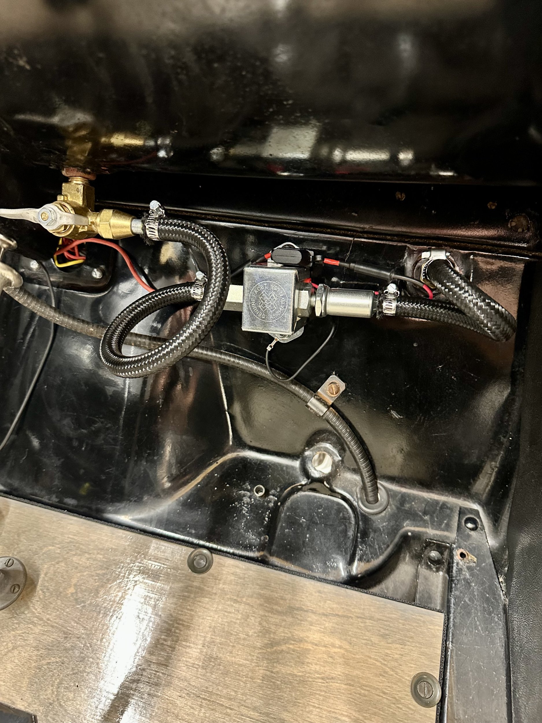

    Finally got around to getting the fuel pump installed. Decided to put it on the firewall on the p***enger side. Might paint it black down the road so it is less noticeable. Next up is converting the intake over to dual 81s - need to order some hardware to fit the fuel block - nothing in my stash fit…

    Info on the fuel pump please! How much pressure does it supply?

    Dan - it is a Facet low pressure pump - no need for a regulator. See pic below.

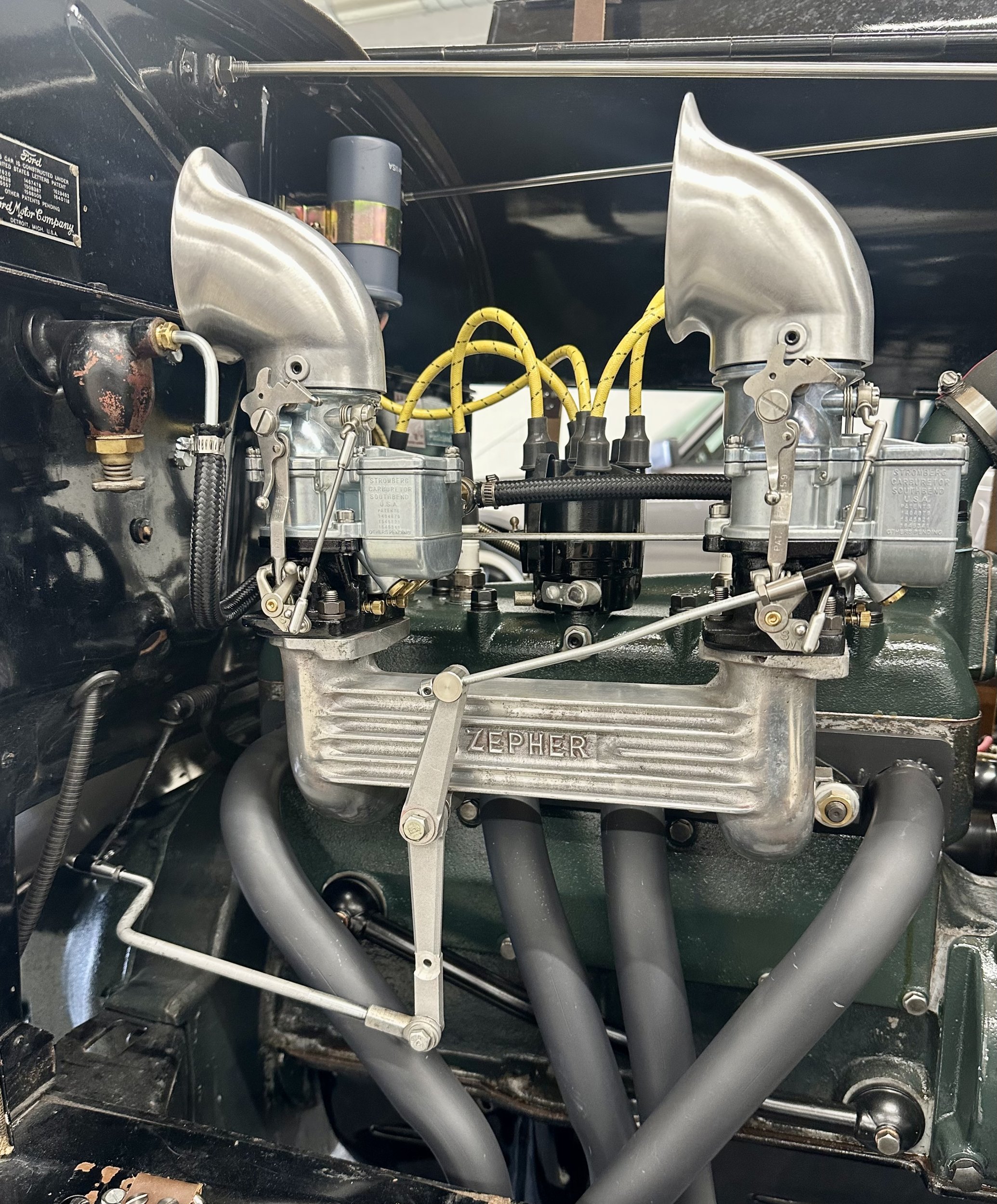

  10. reffiesj
    Joined: Dec 10, 2018
    Posts: 215
    reffiesj

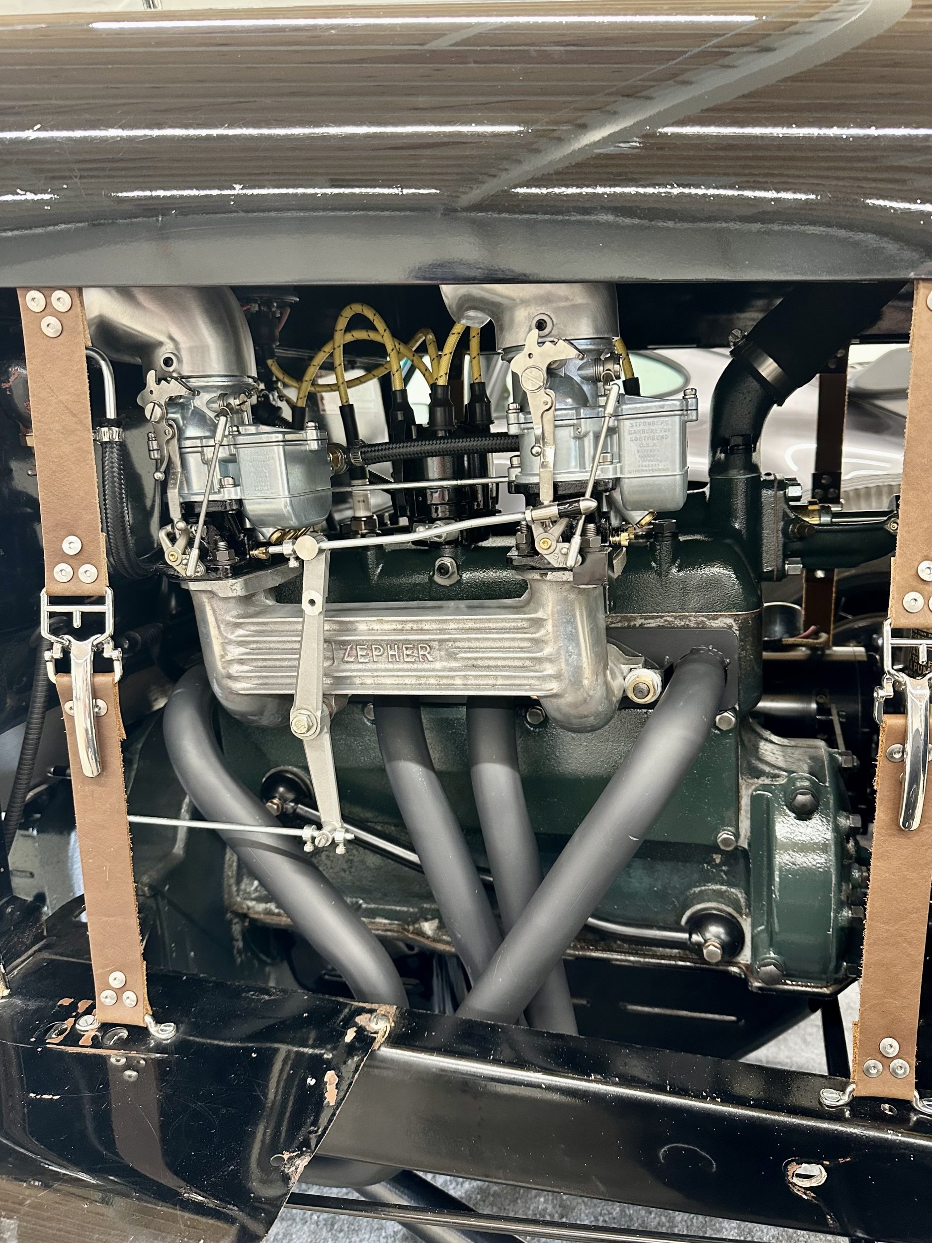

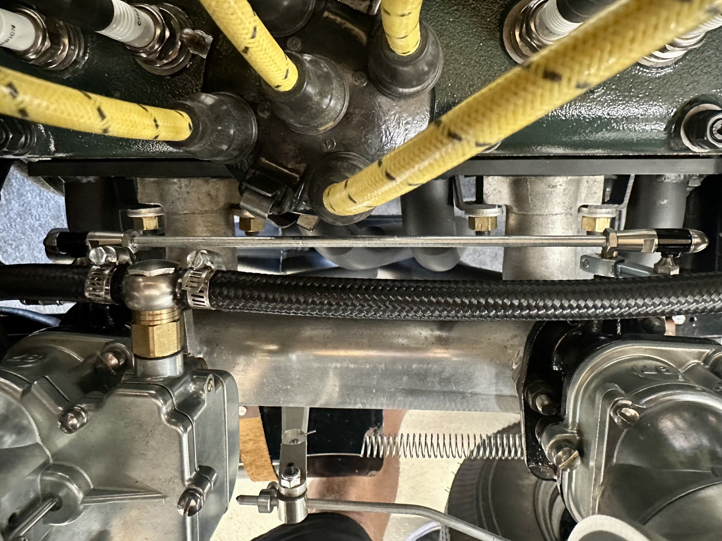

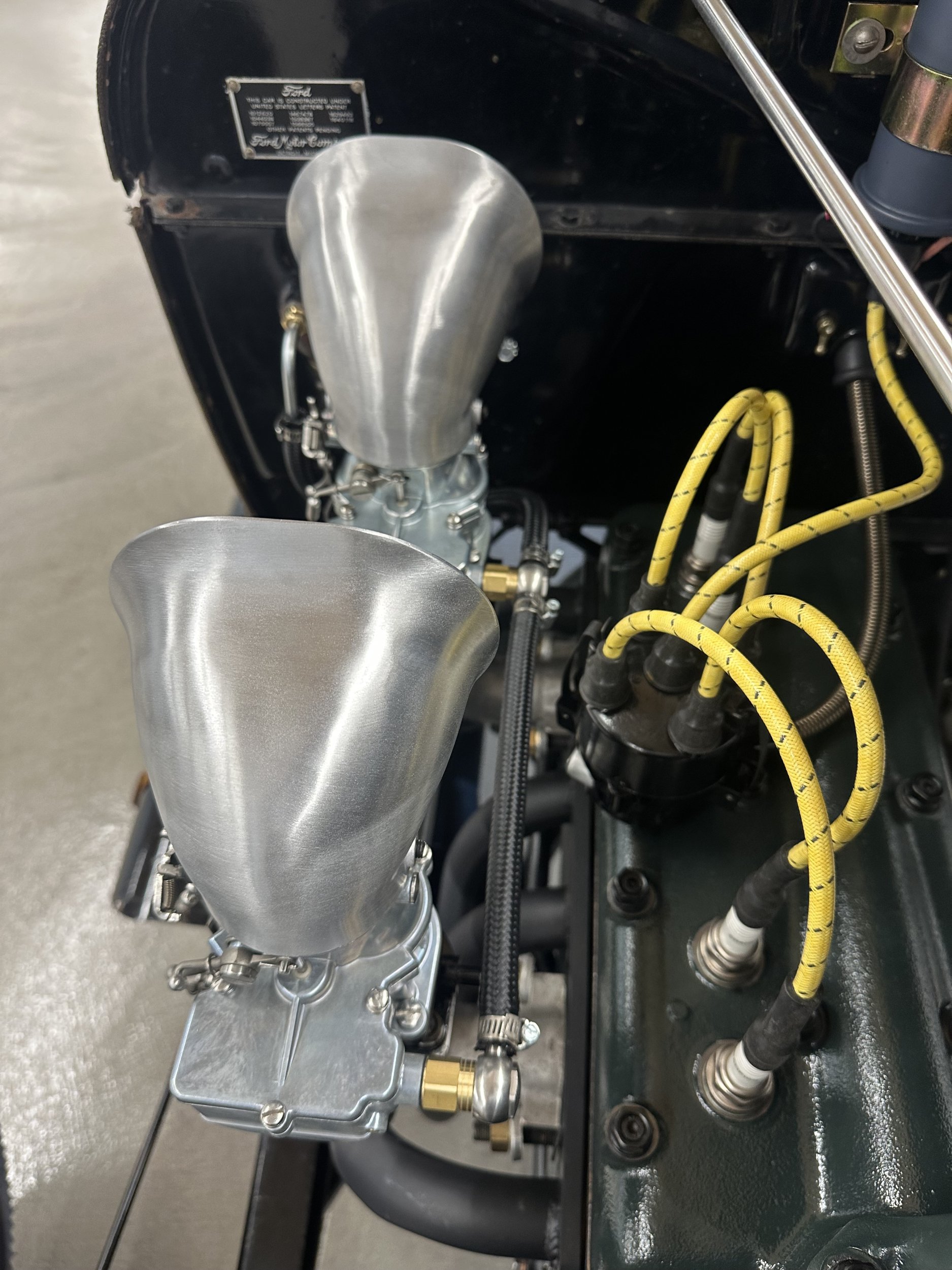

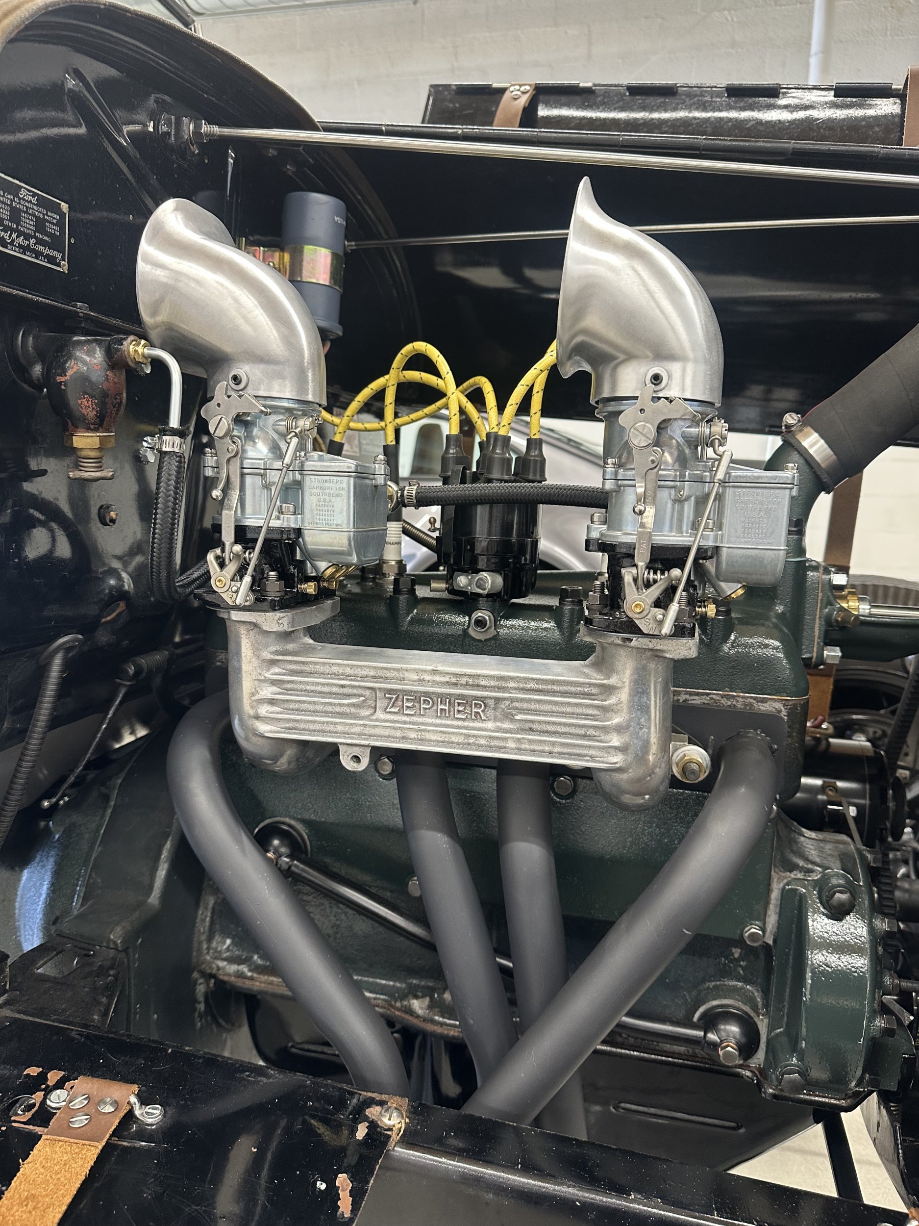

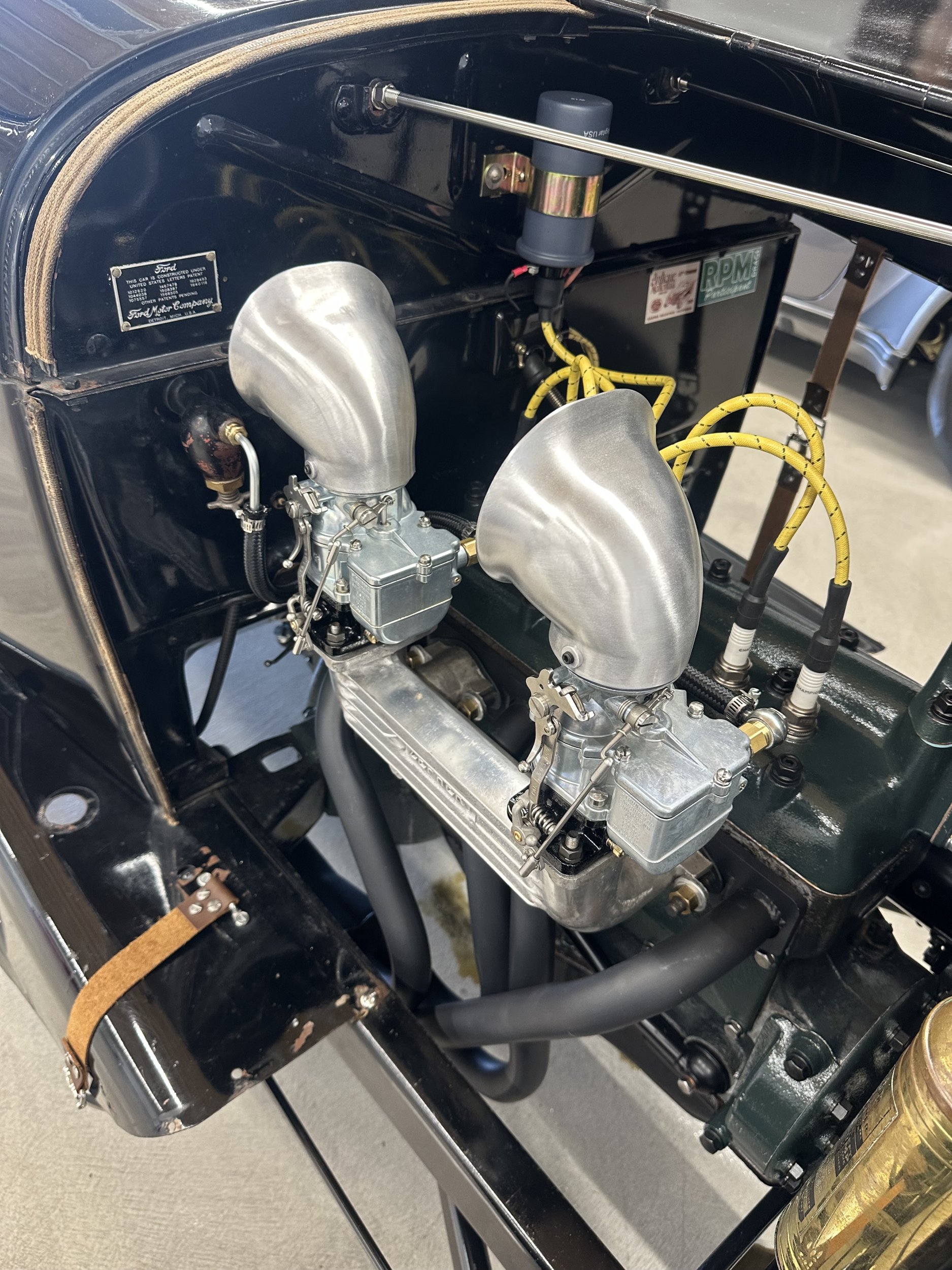

    Got the intake, carbs and fuel lines installed. Decided to go with a T connection since the fuel block was making the firewall really crowded. Got the carbs synced and mixture in a reasonable place. Will need some fine tuning. Linkage needs to be reworked quite a bit so that is next up on the list.

  13. reffiesj
    Posts: 215
    reffiesj

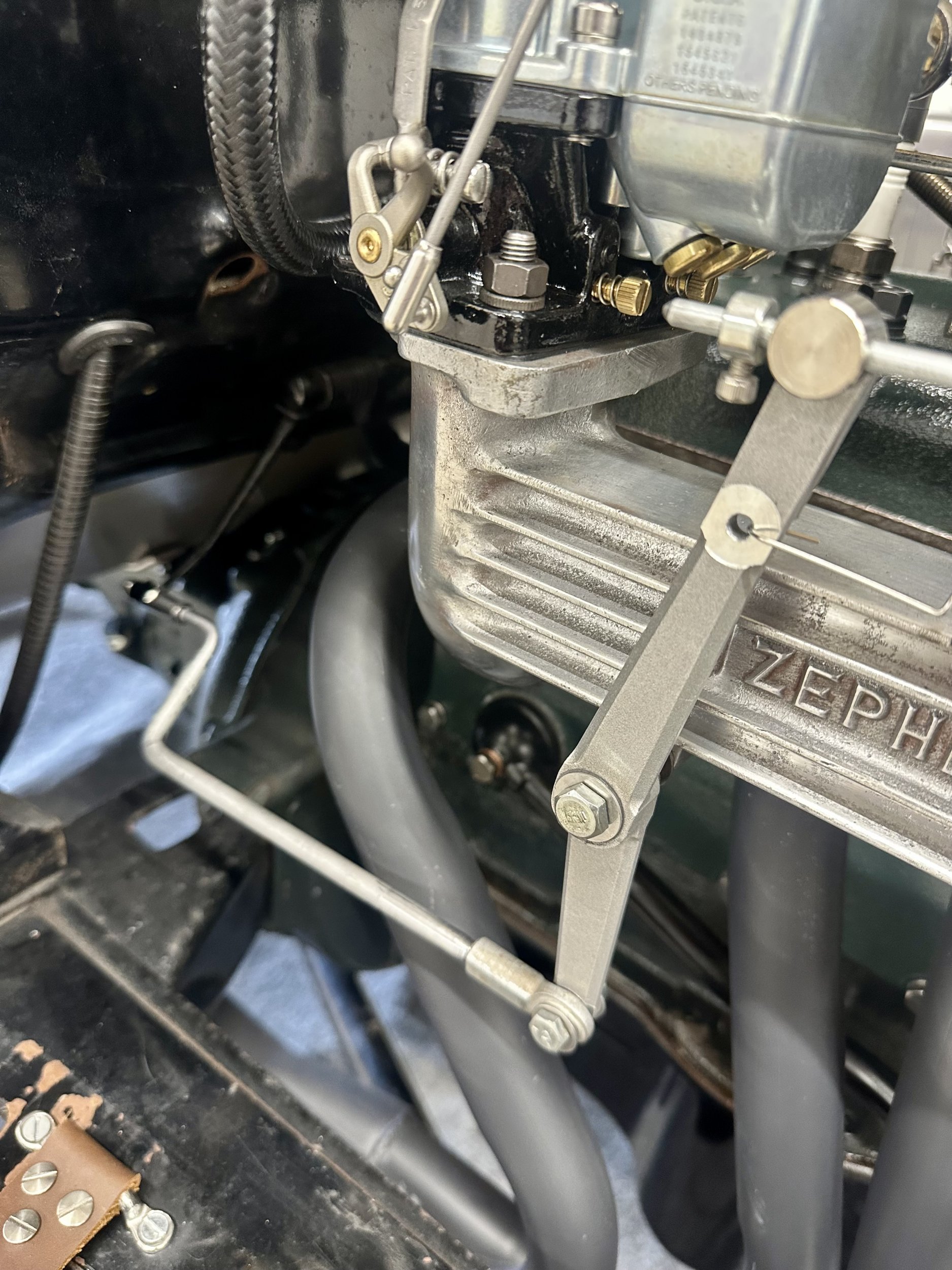

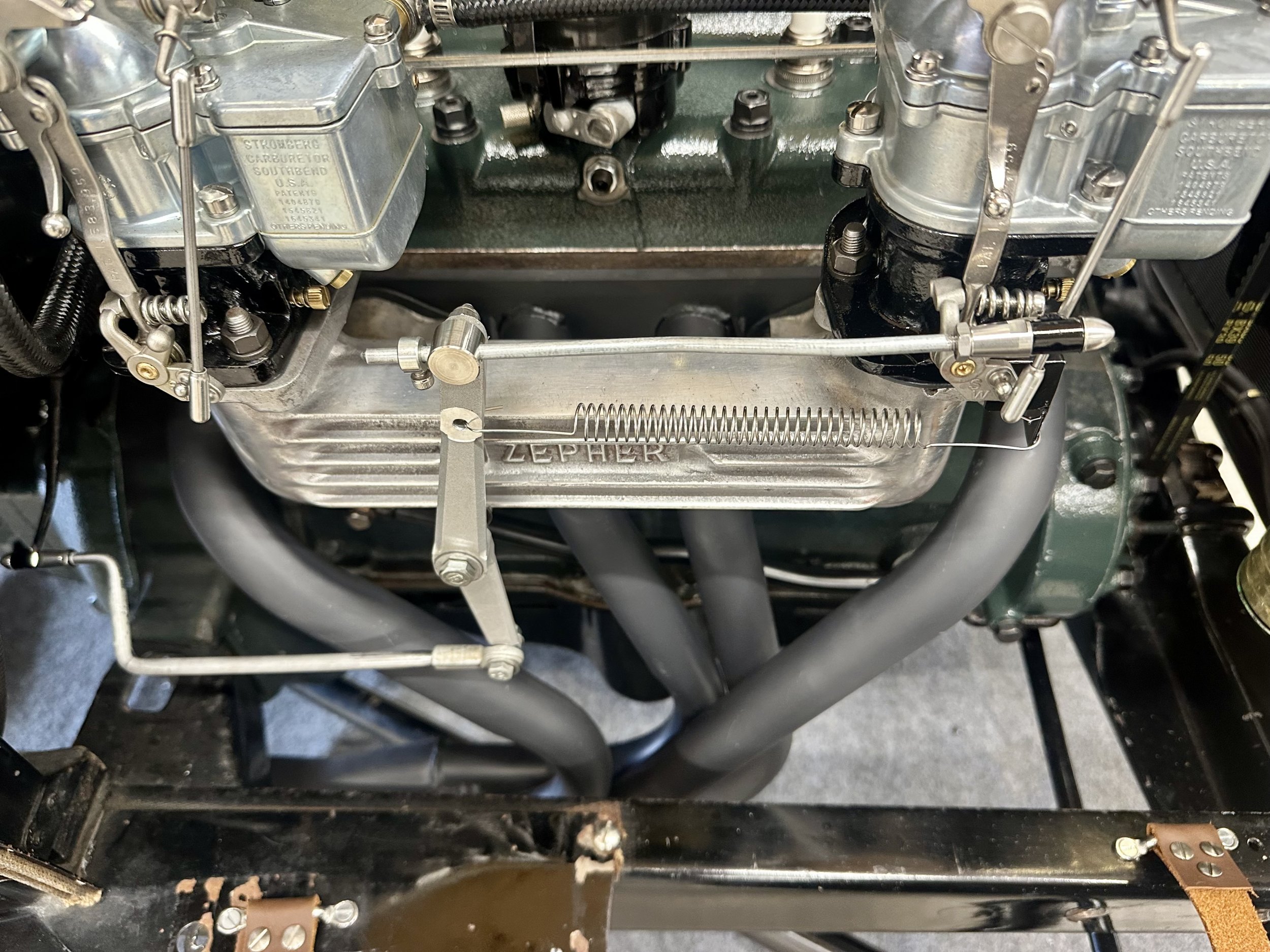

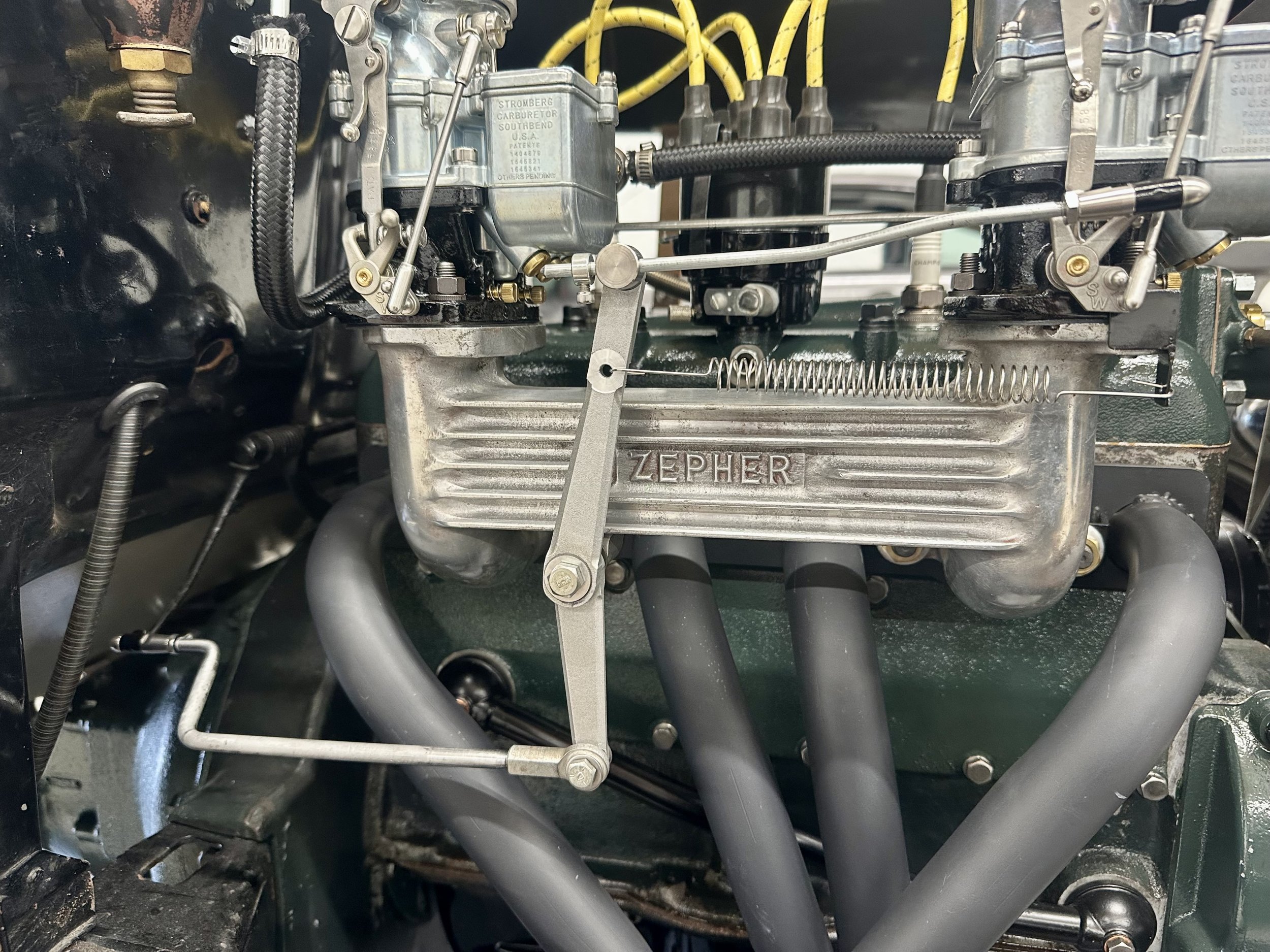

    The 3/16” rod was too small a diameter to handle the force from the pedal and was deflecting. Reworked it with heavier diameter (used an old radiator support rod). Works much better but I am getting a bit of an on / off action with the gas pedal - I think I may have overdone it with the return springs - have one on each of the throttle arms on backside of carb, the two accelerator pump arms and the long spring on the linkage arm plus the spring on the pedal ***embly itself. Does anyone have any suggestions on the geometry or examples of how they have hooked up dual carbs using a model a pedal and zepher intake - any suggestions appreciated. When it is “on” it runs like a scalded dog.
  14. Dedsoto
    Joined: Jan 7, 2014
    Posts: 380
    Dedsoto
    from Australia
    Is the pedal ***embly moving freely? they can bind up if never oiled. I'd also be tempted to try flipping the bell crank up the other way to change the ratio.
  15. reffiesj
    Posts: 215
    reffiesj
    Thx Dedsoto - flipping the bellcrank made a huge improvement. Pedal modulation is terrific now.
    woodiemike, J.Ukrop, Outback and 5 others like this.

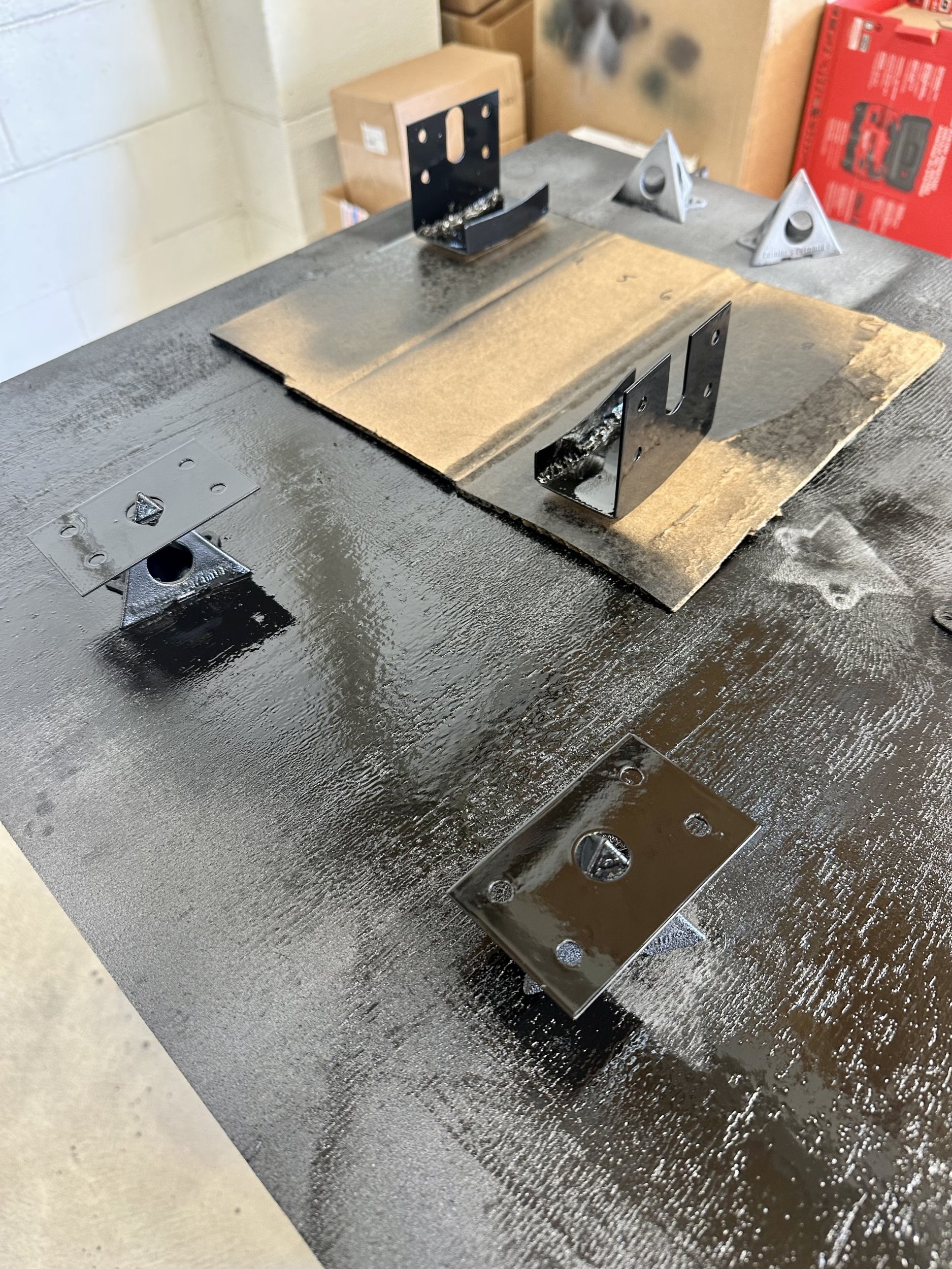

    Working on some mounting plates to get the front shocks set up. Figure that was easier and quicker than welding up the egged out holes in the frame.
