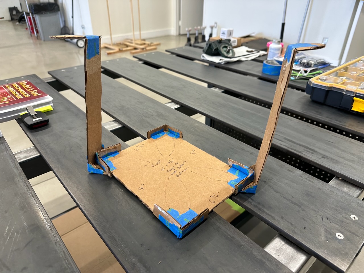

  4. They make a battery box that is modified to mount a master cylinder. Just be careful there are some cheap ones out there that flex.

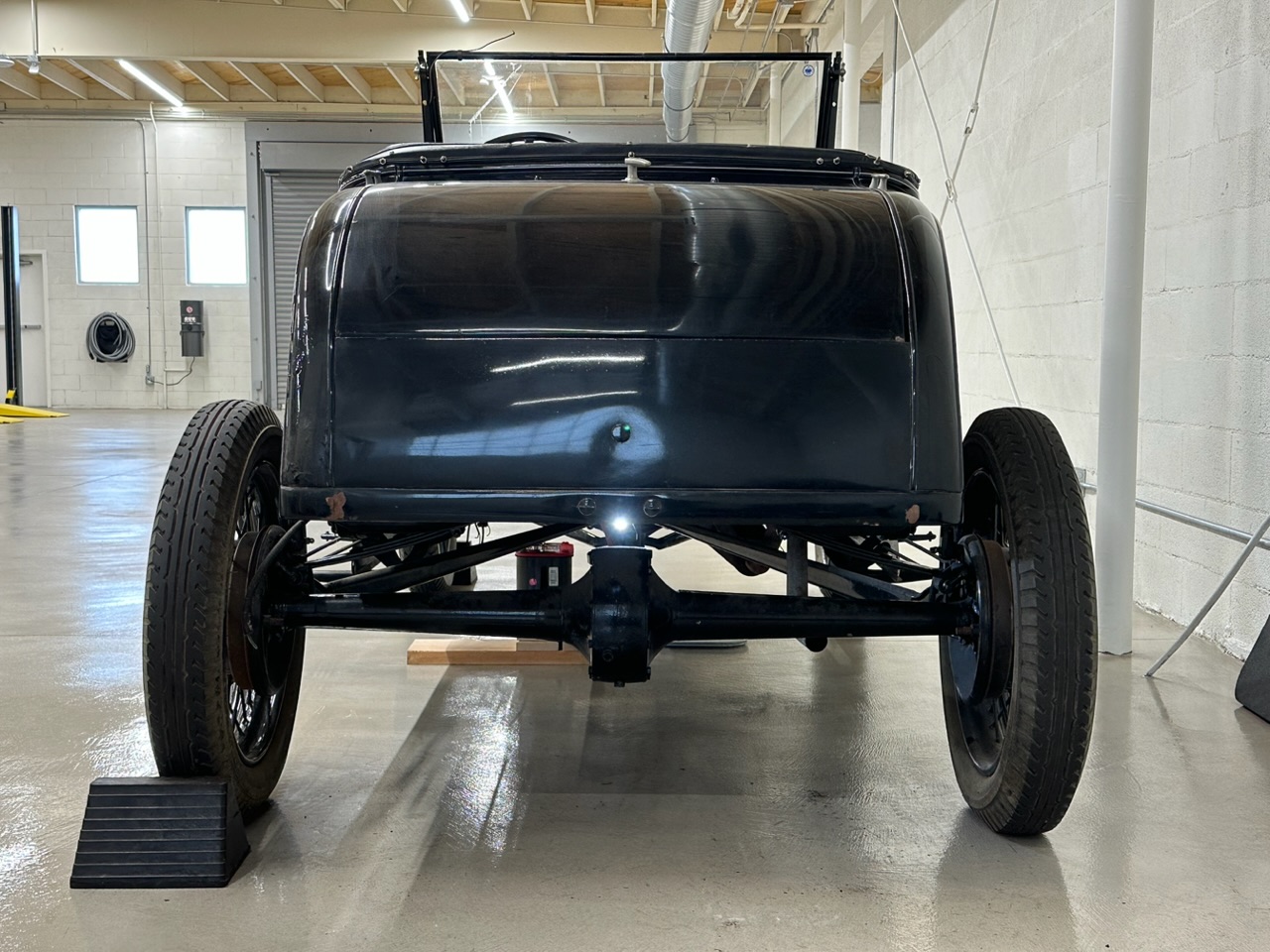

  10. Martinbuilt
    Joined: Mar 23, 2023
    Posts: 141
    Martinbuilt
    Mine just arrived today. Can you post a photo of it installed? I haven't tried it yet, but it looks like it's going hang well below the frame. I might need to find aprons.

  11. Zax
    Joined: May 21, 2017
    Posts: 951
    Zax
    Here you go. Sorry about all my junk in the background.

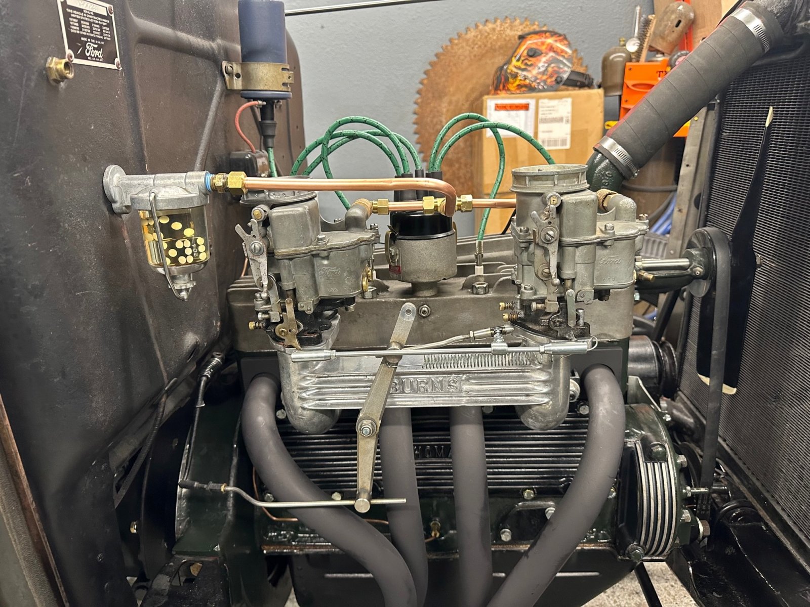

    Here’s my set-up. High compression head, Ansen downdraft manifold with English Stromberg 97, and 2 to 1 headers. Still have the stock distributor and thought about changing it to an FS but it runs great and very peppy so I will keep the stock setup for awhile.

    Steves46 - thanks - looks great - what is the holder for the coil - is it fabbed to match the intake design?
  14. manyolcars
    Joined: Mar 30, 2001
    Posts: 9,609
    manyolcars
    GuyW likes this.

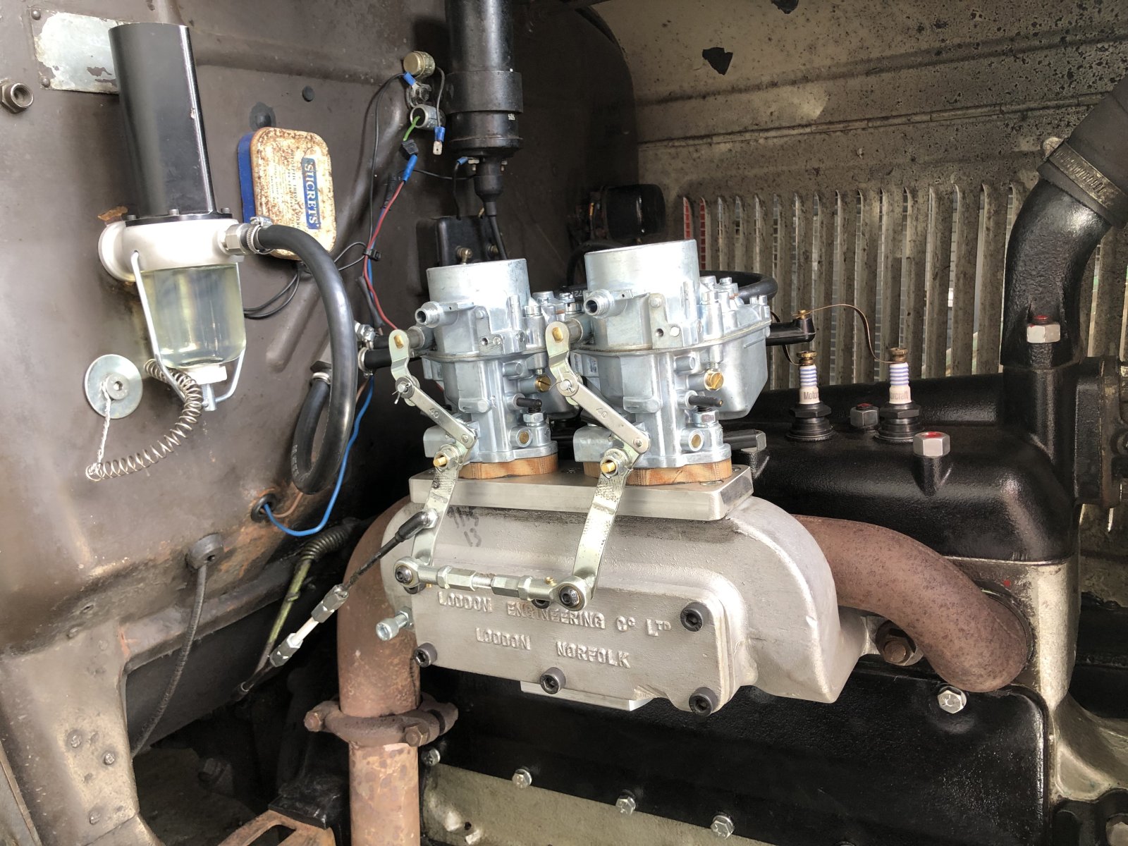

  16. ModelAMitch
    Joined: Jul 8, 2022
    Posts: 295
    ModelAMitch
    Is the stock location for the sediment bowl not good enough to run a down draft intake manifold? Was the car starving for fuel at all?
  17. Steves46
    Joined: Sep 23, 2008
    Posts: 575
    Steves46
    from Florida
    That is the stock location for the sediment bowl. Honestly, it may indeed work fine without an electric fuel pump however I decided to install one when I converted over to a downdraft. I do carry an extra fuel line to hook up between the sediment bowl and carb in case the fuel pump fails.
    winduptoy likes this.
  18. ModelAMitch
    Joined: Jul 8, 2022
    Posts: 295
    ModelAMitch
    I know thats where the sediment bowl goes, but I noticed the fuel lines running elsewhere instead of directly to the carb. Some guys on here I notice have a fuel pump with their down draft set up and some use gravity. Just wondered if you encountered any problems with the gravity system. Thanks, the engine bay looks great!
    Also, is that a fancy coil you have mounted on the firewall? Looks cool

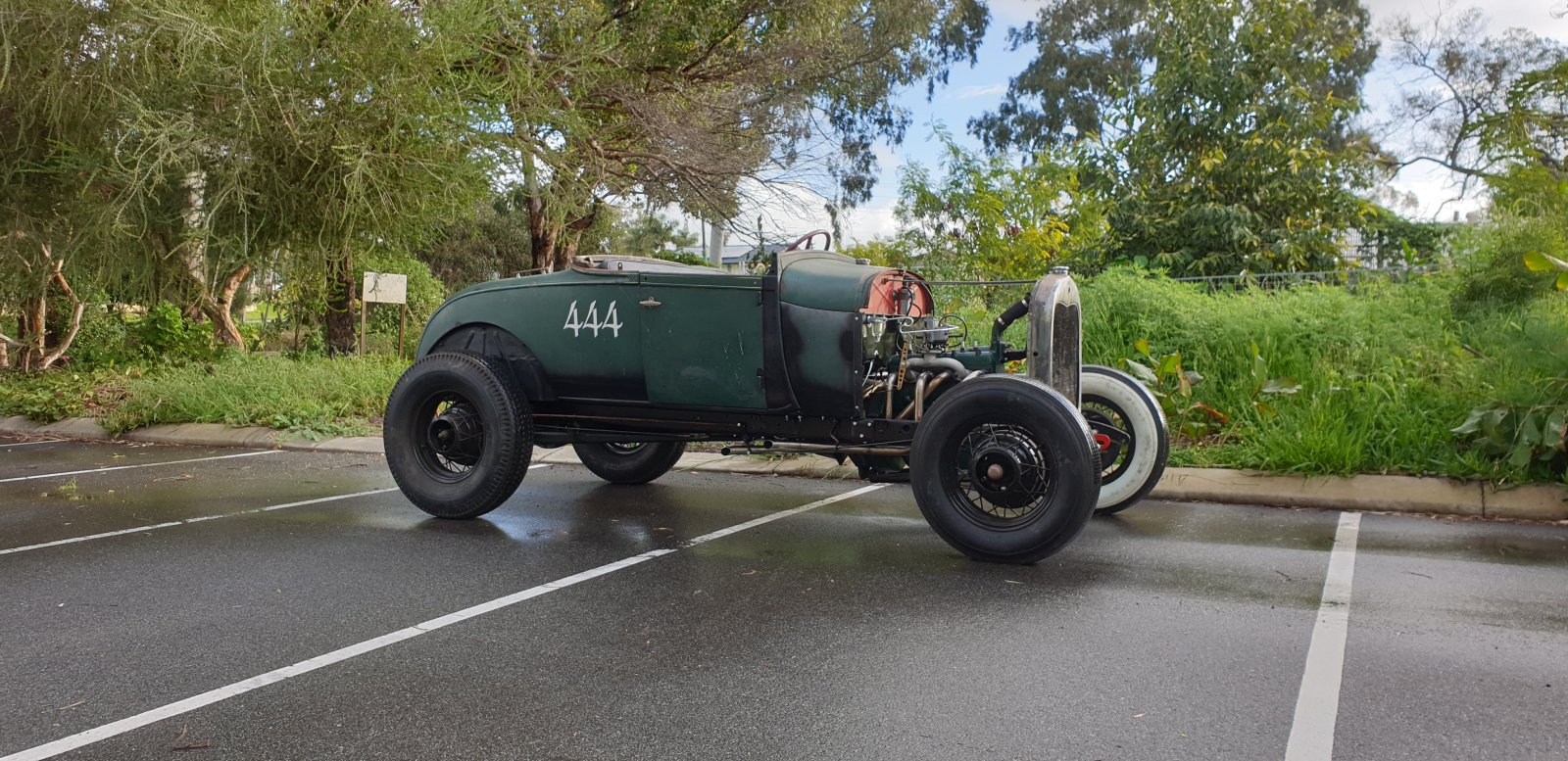

    Hi , not wanting to hijack your thread but for inspiration check out mine- just got it running and boy it is sweet with these two 81`s on it. YouTube video-https://youtube.com/shorts/9T0LNSjB0_Q?feature=share coupe outside.jpg

  22. Good observation, you are probably right. I still have mechanicals in my Model A so no photos available.
    Ask trikejunkie (post #51) to give you a side view photo and then add for the master cylinder.

    I saw one at the car show in Porterville last week, on a high boy 30 roadster. The box is quite visible and the master
    cylinder hangs below that. I would say aprons are a must for this application.

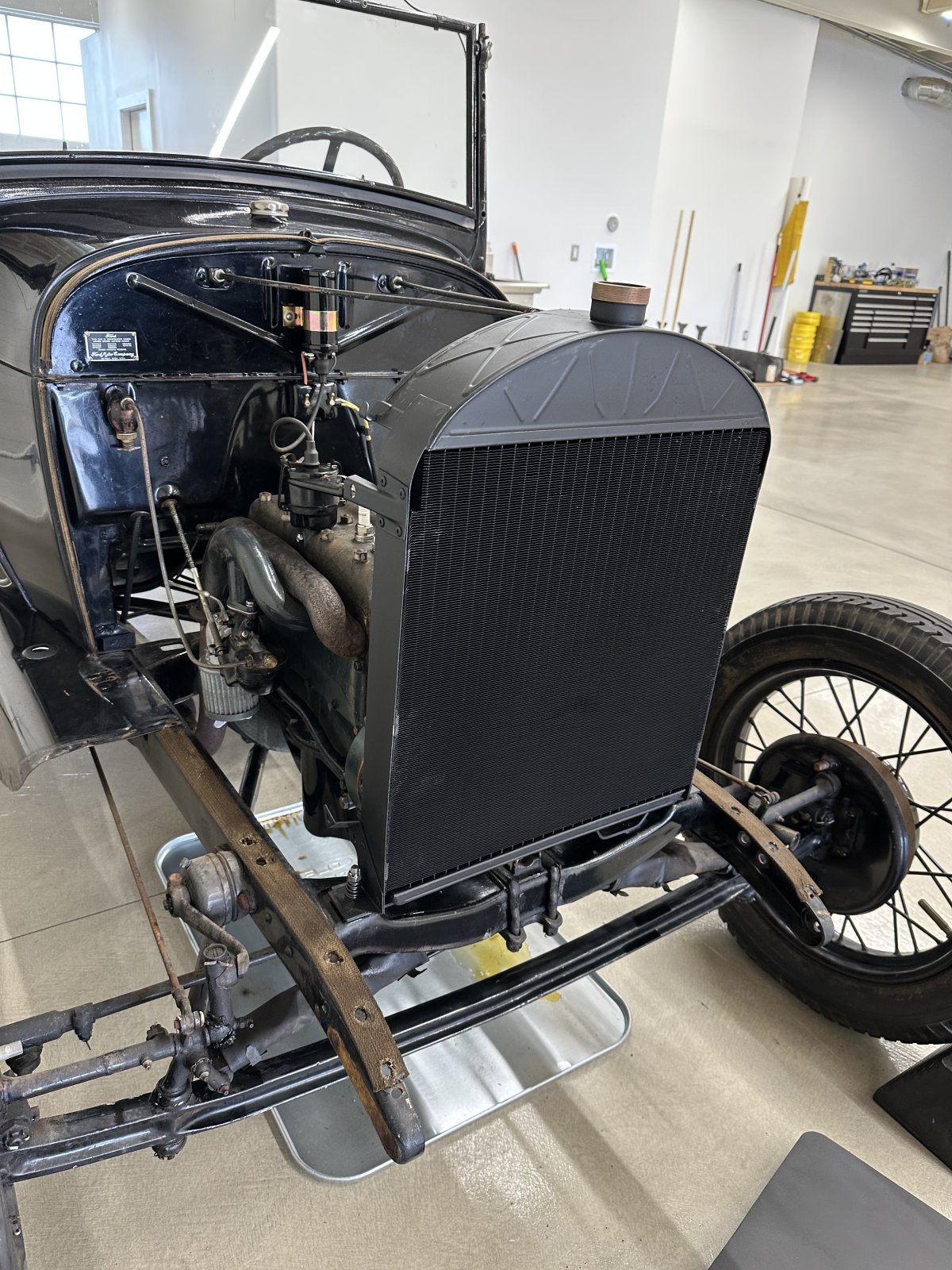

  25. reffiesj
    Joined: Dec 10, 2018
    Posts: 191
    reffiesj
    Thanks Manyolcars - not sure my fabrication skills are up to the level required for the conversion but we will see…****** is a bit down the road….
    Stubbsrodandcustom - appreciate the inspiration
    Trikejunkie - your car sounds great

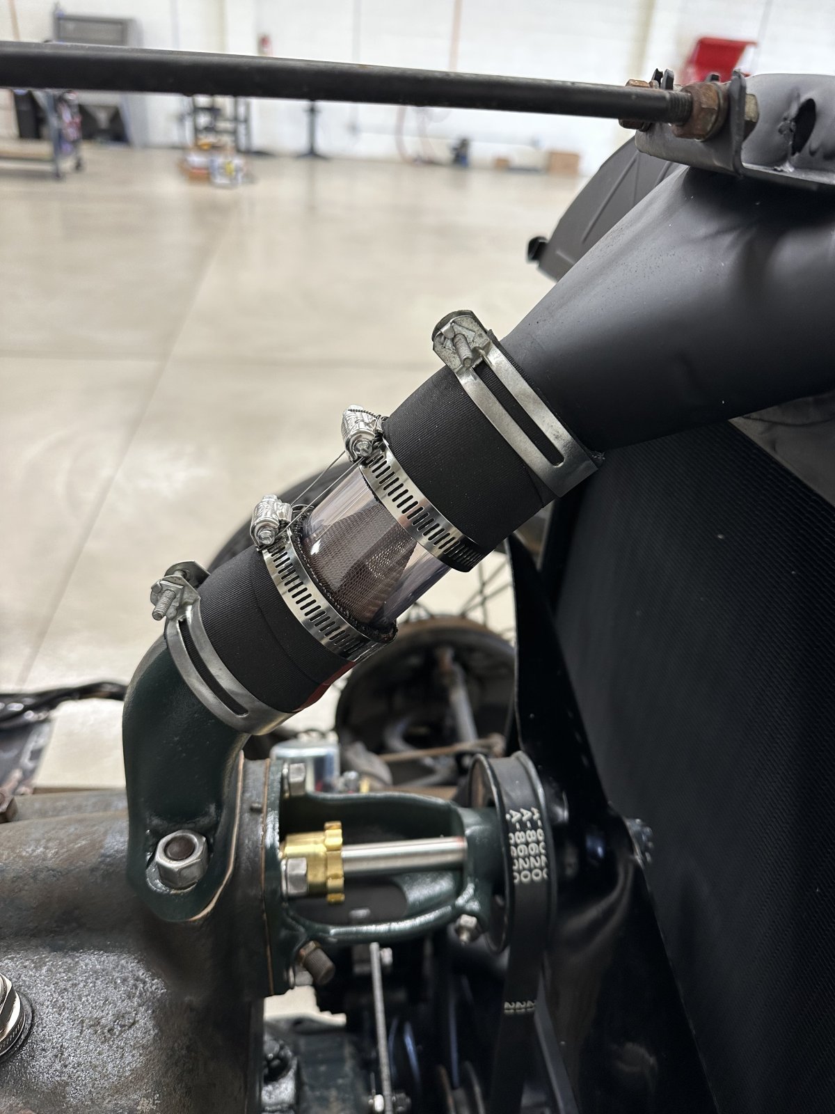

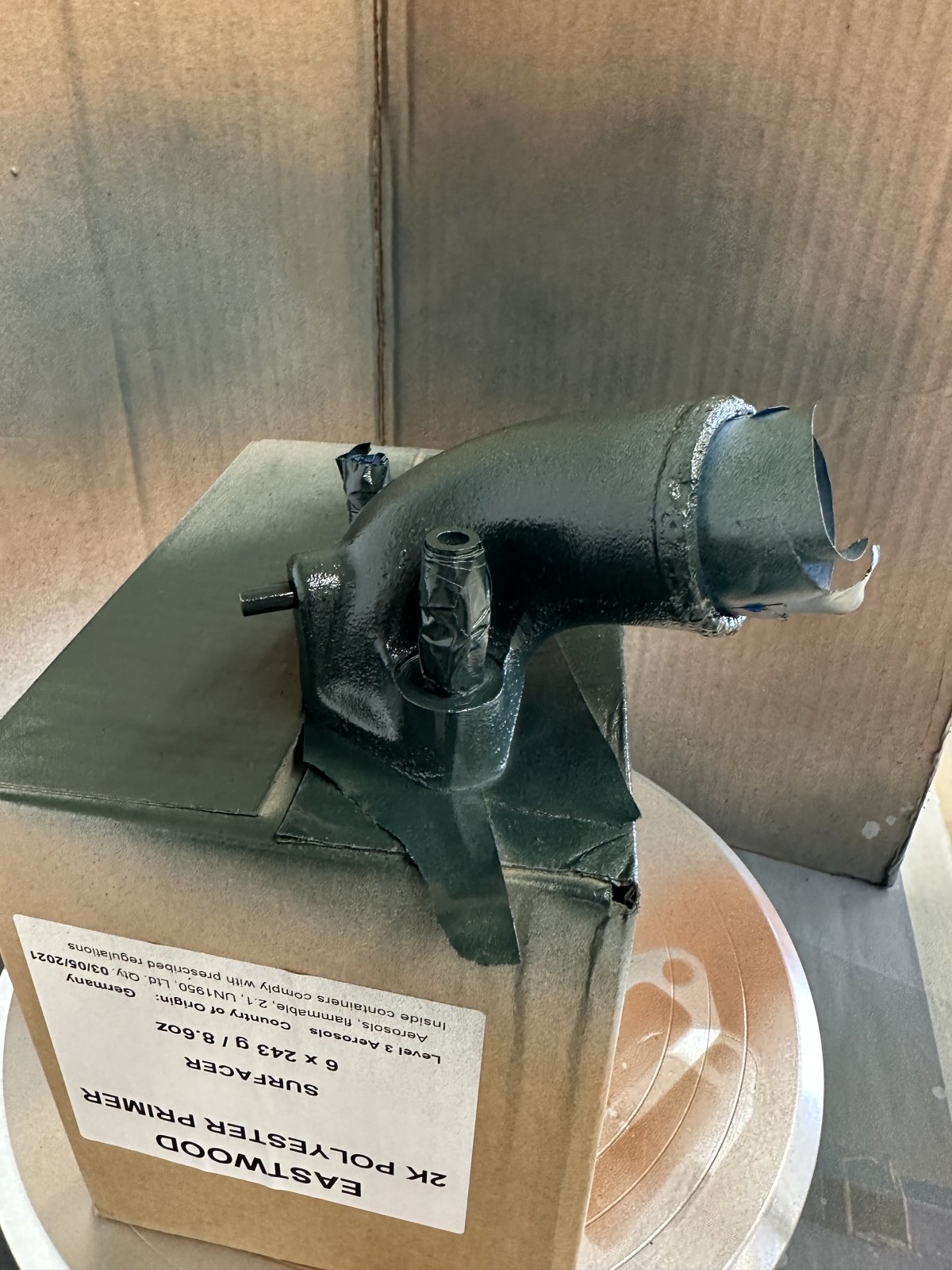

    Made a little progress today - cleaned the engine bay and got the new radiator and upper hose in - I am going to give a Gano filter a try since there was a lot of scale in the old fittings - went with the clear one for now (I suspect there will be a good amount of crud in the block despite washing it out) and will put a br*** one in later. Also got the water inlet blasted and painted - had ordered a new one but the vendor sent a differential plug instead….will sort that out after the holiday….ran into an unexpected issue w the new radiator - the powergen is too far over to the left with the stock fan belt and touched the bottom fitting on the radiator - anyone else run into this issue? Ordered a B39 belt which should give me enough clearance.

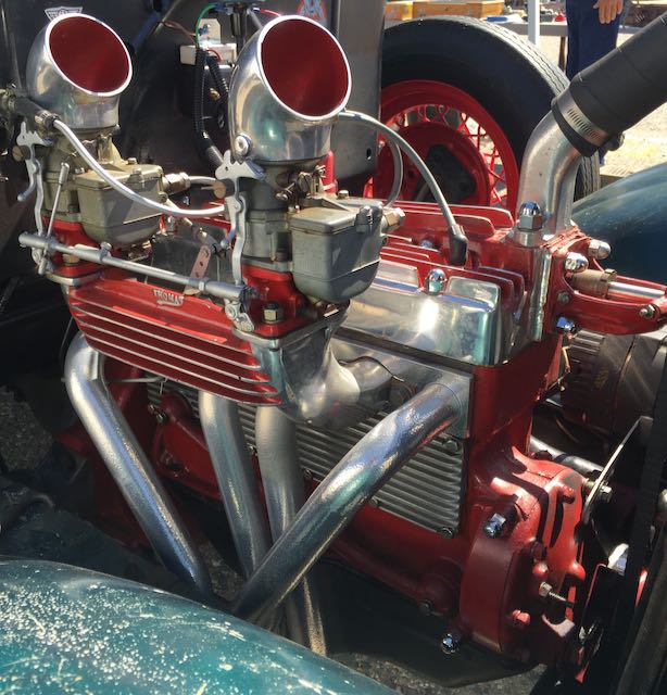

  27. Steves46
    Posts: 575
    Steves46
    from Florida
    Thank you for the kind words. The coil cover is from O’Brien Truckers. Dennis makes some really cool stuff.
  28. Close up of Craig’s set up using a modified petrol/paraffin manifold with twin single choke downdraft Zeniths fed by his fuel pump design. C44CC273-3324-4B6F-8BF3-87E69749DCA1.jpeg

  30. reffiesj
    Posts: 191
    reffiesj
    The B39 belt turned out to be too tight so got the B40 to work after some adjustments. Got the rest of the cooling system back in the car and checked for leaks. Turns out the water inlet gasket (I used a copper one) was leaking so replaced it with a paper gasket and permatex sealant - hoping that does the trick. Will check the system again later in the week. Also tackled the rear bumper - it was a bit tricky to get it out with the body on but doable at the end of the day.
