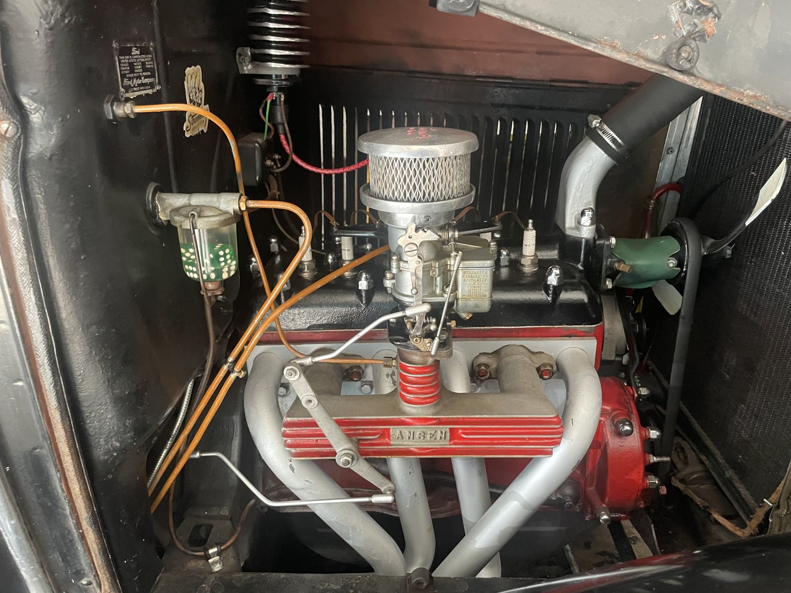

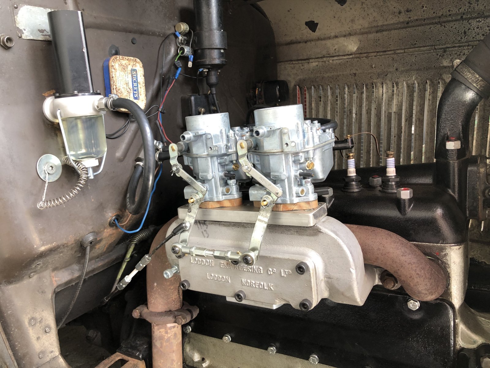

  5. Can you tell us more about this intake?
  6. Loddon is a small town in Norfolk in the UK. Loddon Engineering used to build industrial engines from Ford engines at best guess. The manifold is set up for an updraft carb originally. The removable plate covers a chamber that would have preheated the incoming charge so the engine could run on paraffin when warm.
    Another friend of mine had the same manifold and blanked off the lower inlet, machined the top for a flat plate, to adapt a pair of Landrover single choke Zeniths. I put Craig in contact with him, and he copied the same setup.
    Tim, Jim the Sweep, winduptoy and 4 others like this.
  7. Awesome project. I wish you success sir. Needs a banger though. He he.
    winduptoy likes this.
  8. The dice in the fuel bowl, wow I've never seen anything like that before! That looks super cool
    winduptoy and chryslerfan55 like this.

    Thanks but I was inspired by the set-up "Stubbsrodncustom" was using on his super cool Model A.
  10. does that hamper fuel flow at all?
  11. Steves46
    Joined: Sep 23, 2008
    Posts: 575
    Steves46
    from Florida
    No sir not at all.

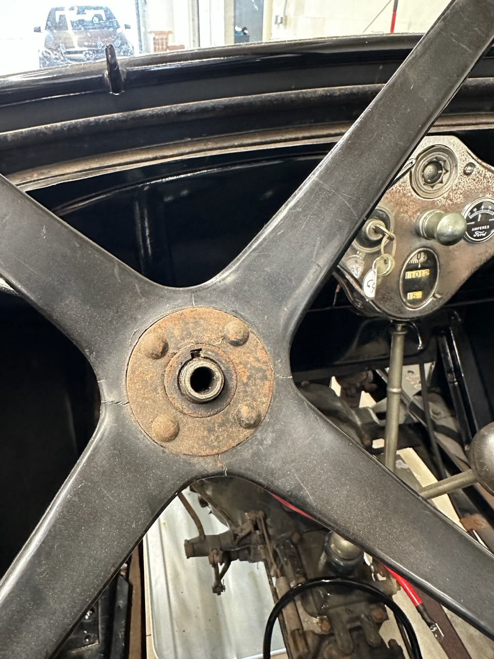

    Got a little done today - fabbed a spacer for column mount so it can be moved off the gas tank and cut off the running board mounts - need to go back at some point and grind off the riveted sections but that is work for another day. Also upgraded ammeter to 30 amp version.

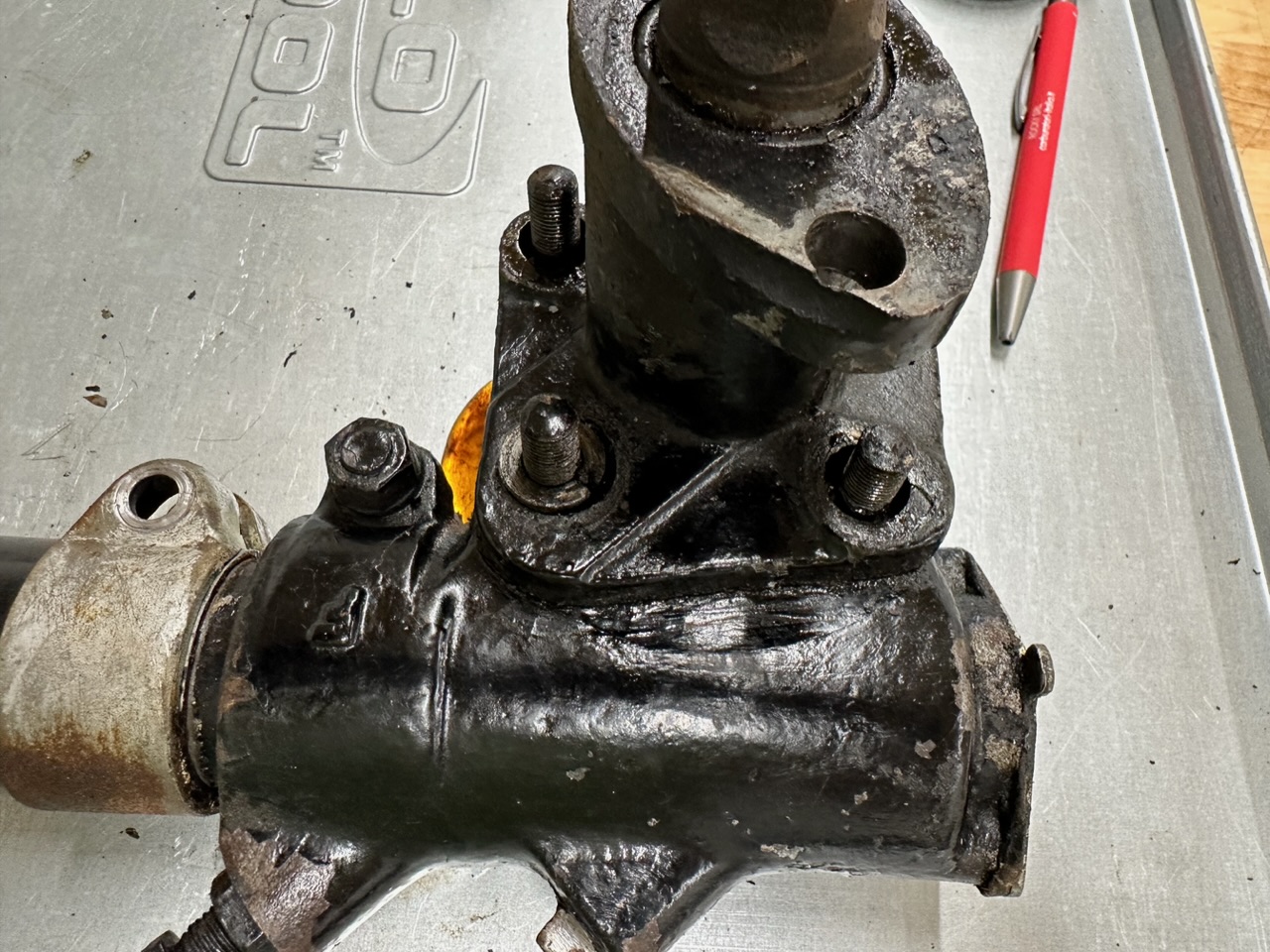

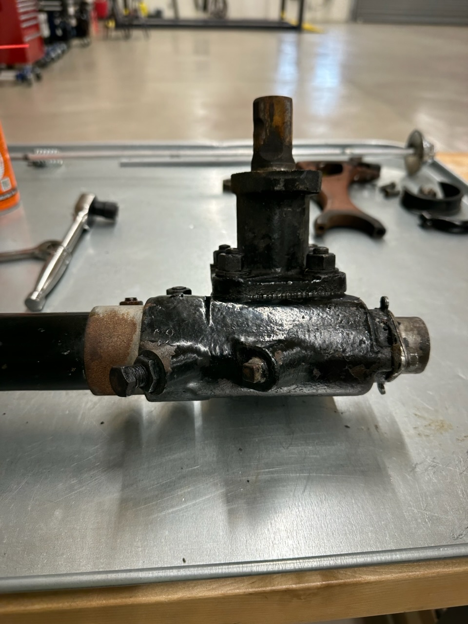

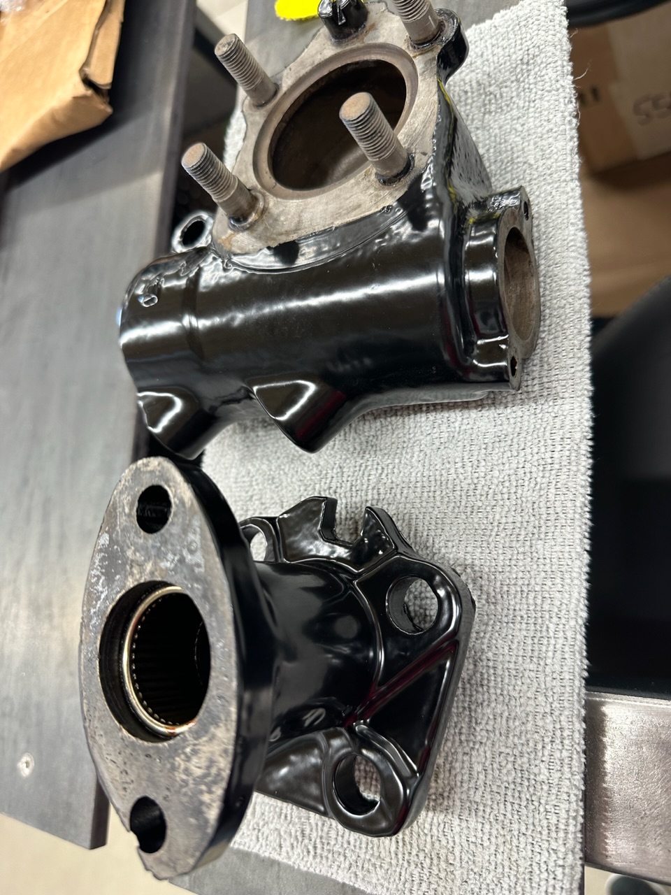

  15. reffiesj
    Joined: Dec 10, 2018
    Posts: 191
    reffiesj
    Thanks Metalhesd140 and ModelAMitch.

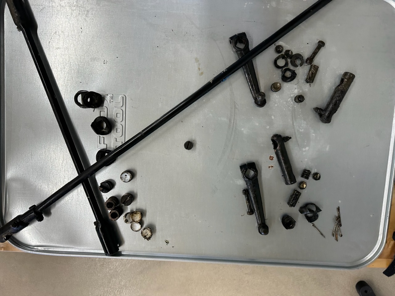

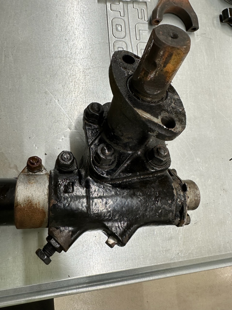

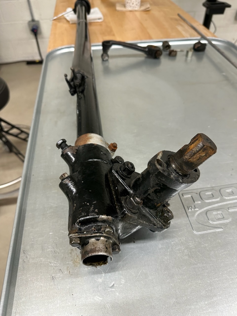

    Got to work today on the steering box - it was leaking like crazy - would not hold 600 weight for more than a couple days so dug in to see what was wrong - plenty it turns out - no gasket or thrust washer and also no eccentric sleeve or stud (but the cone was there - go figure…). Back to waiting on parts…

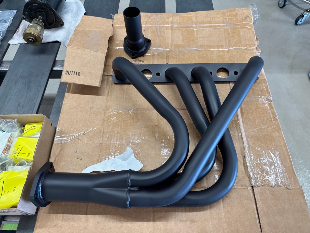

    Picked up the ceramic coated exhaust and collector today - looking forward to getting them installed. Had bought a vintage Cragar intake to go with it but did not realize it had oversized ports - shifting plans to run a repro Burns for now. IMG_0397.jpeg

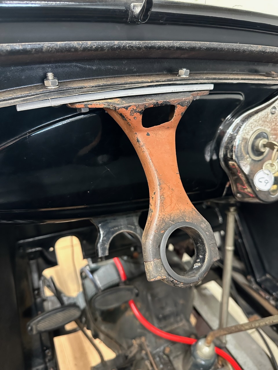

    Steering rebuild underway and also relocated steering wheel support to the dashboard

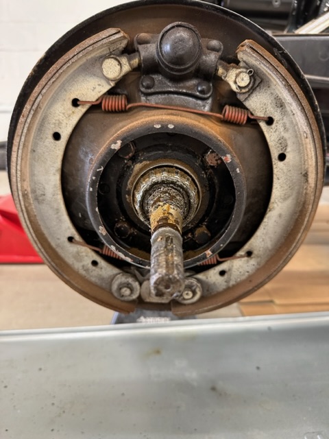

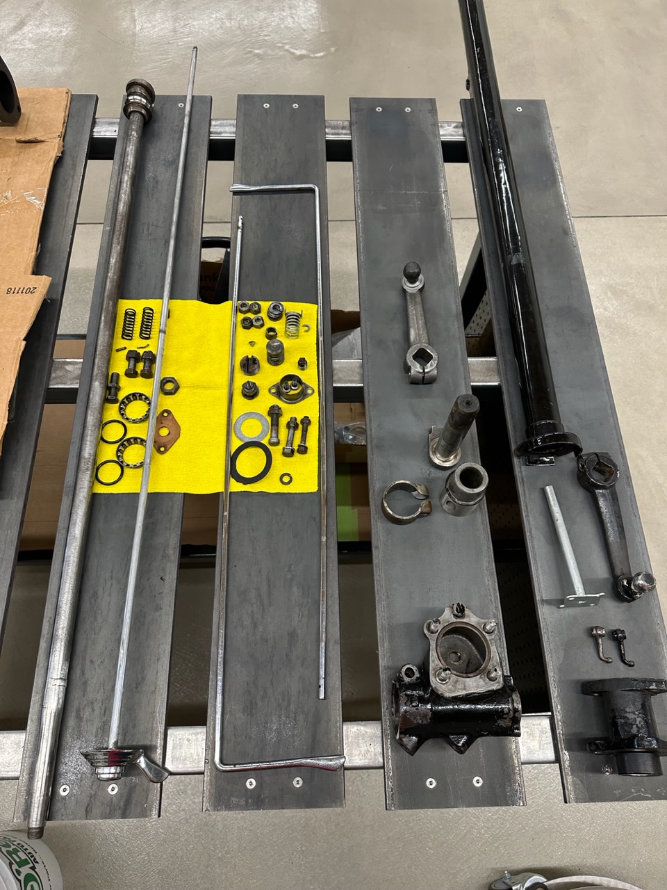

  20. reffiesj
    Posts: 191
    reffiesj

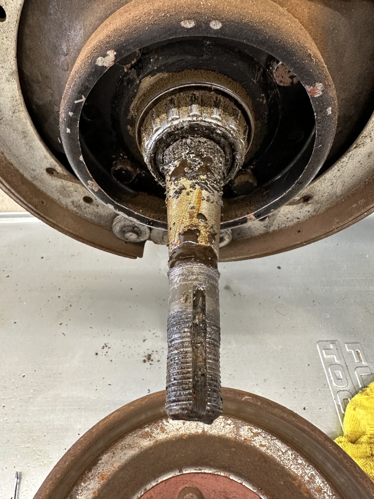

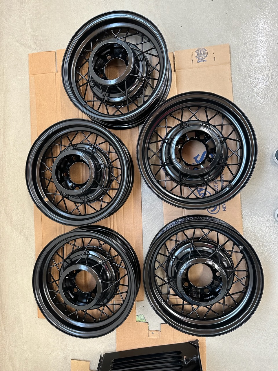

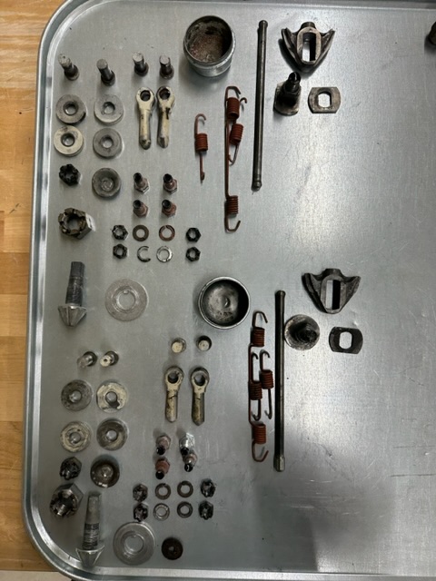

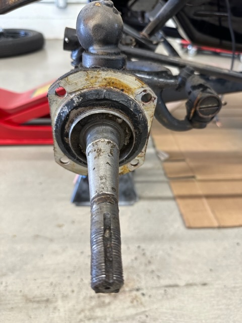

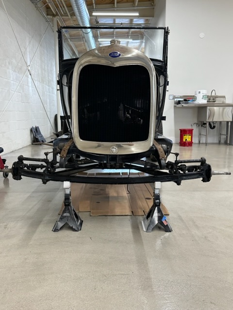

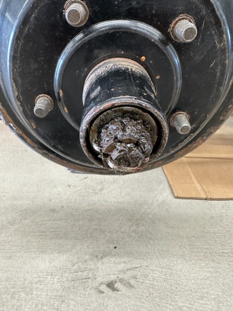

    Made some progress today on tearing down the front brakes - old grease was hard as a rock and bearings were in pretty rough shape. Am planning to drop wheels, steering and brake components off at the powder coater after the holiday.

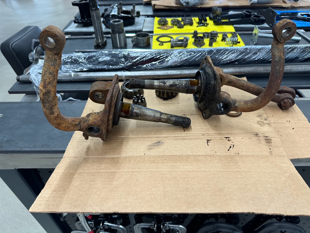

  21. Outback
    Joined: Mar 4, 2005
    Posts: 3,641
    Outback
    from NE Vic, Oz
    Is it just the photo or are the stub axle threads worn/stretched?
    Good to see progress

  22. reffiesj
    Posts: 191
    reffiesj
    Outback - I think it is the photo - but am planning to run 32 spindles to go with the 32 axle I am going to use. This photo shows the threads a bit more clearly.

  23. Outback
    Joined: Mar 4, 2005
    Posts: 3,641
    Outback
    from NE Vic, Oz
    Yep makes sense. Cheers

    Why the relocation of the steering wheel support? Thanks, keep it up!

    ModelAMitch - Thx for the encouragement - moving the steering support to the dash helps alleviate stress and potential cracking on the gas tank which is where the 29 original steering support is located. I am probably going to run both since it looks like the original support was riveted and welded in place at some point.

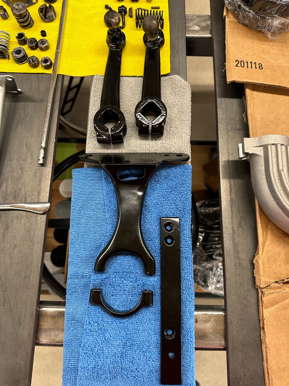

    Got a little time in the garage yesterday before I had to go man the grill. Removed and dis***embled the drag link, tie rod, shock links and shock levers - one of the Houdailles seems shot although I am going to play with the adjuster to see if it firms up. What are folks’ experience running dog bone links in place of the originals - am I correct that later model NOS dog links won’t fit since the hole for the balls are both on the same side but that there are repros that will fit?

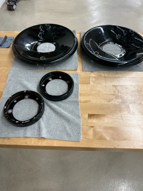

    Picked up some parts from the powder coater and bought a set of 32 spindles that need to be cleaned up. Probably won’t get a lot accomplished until a month from now given other commitments. IMG_0636.jpeg IMG_0637.jpeg IMG_0638.jpeg IMG_0639.jpeg
