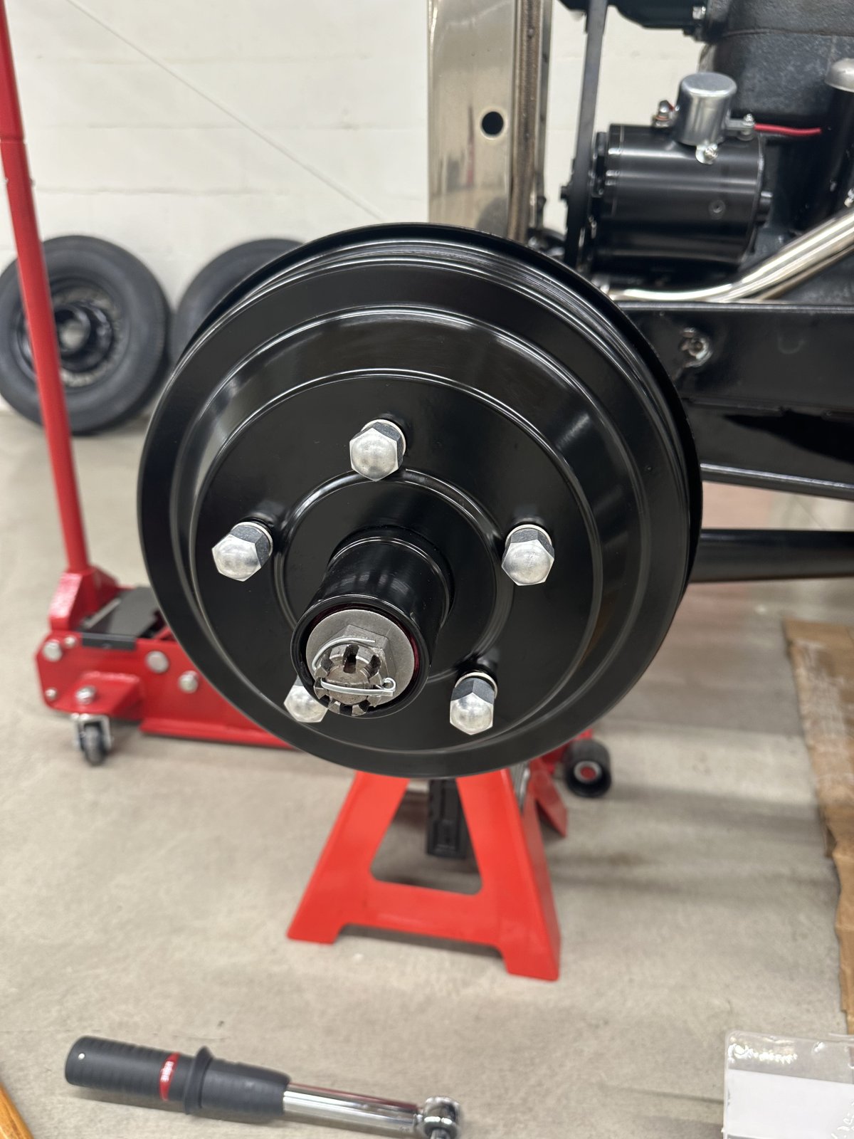

    lowroder - I went with the 32 axle up front since it gives an additional 1.5” drop on top of the reverse eye main spring while still facilitating mechanical brakes - the Roadster Supply spring also seems to be lowered by about two leaves (I needed to put two old leaves on the bottom as a spacer). I returned the Old Yankee main after the fact and am still planning to use their reverse eye main in the back.
    It took me a while to find a good set of 35 wires which I then had powder coated. The drums are cast iron which were powder coated as well.

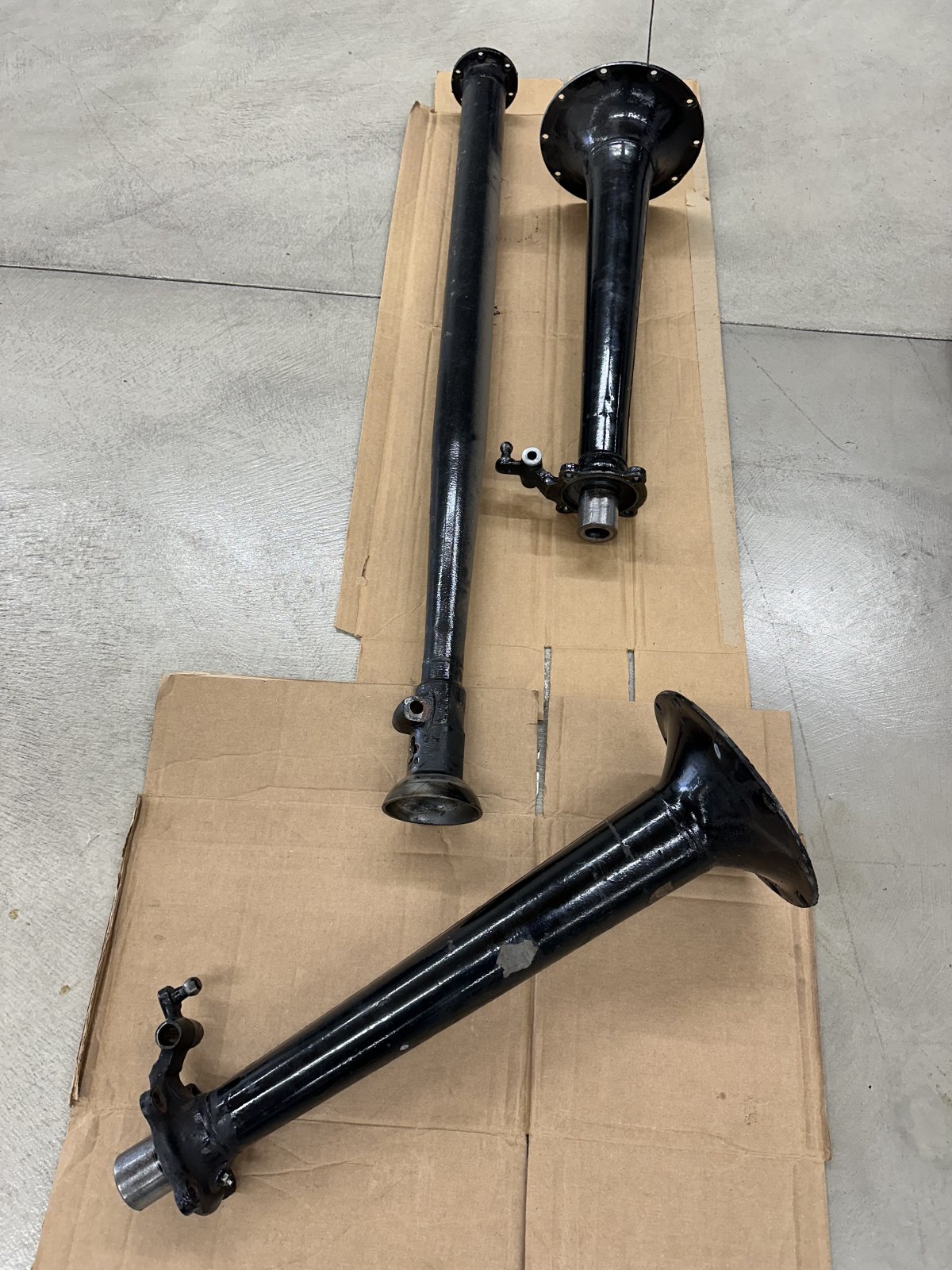

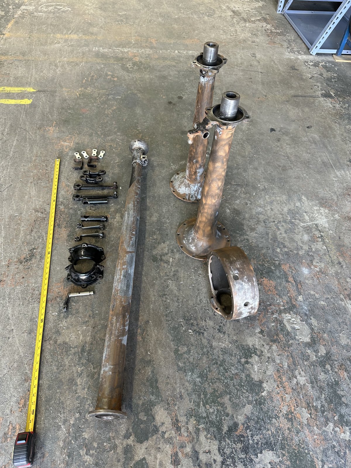

    Started teardown of the rear end. Things look pretty good - better than I anticipated. Am debating whether it is worthwhile to pull the ring and pinion to go down from the 3.78 installed to a 3.54 - figured I won't have it all apart again anytime soon so am leaning towards doing it but if others have done it and don't deem it worthwhile that is worth knowing. ***uming I move forward, if anyone has an old spider gear carrier yoke in their stash please reach out - I need an old one to build the Tom Endy carrier bearing pre-load tool.

    Quick update to the post above - after getting the housings torn apart, I turned my attention to the ring and pinion - 39 teeth and 11 teeth - turns out there is a 3.54 already in there - that should save some time…

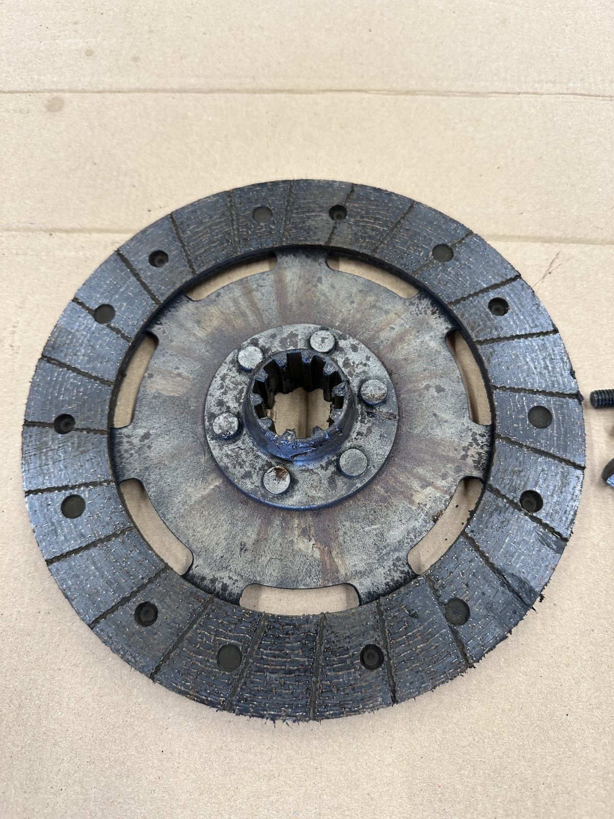

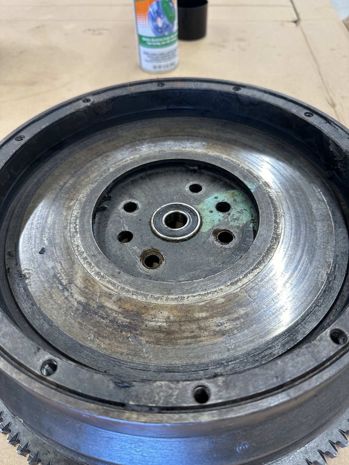

    Pulled the pressure plate, clutch and flywheel (that was a bit of a wrestling match from underneath the car). Clutch had a bunch of oil / grease on it and no safety wire on the flywheel housing bolts and a cotter pin and small ground up spacer were sitting at the bottom of the flywheel housing (see pic w flywheel spacer). Planning to upgrade to a lightened flywheel and V8 pressure plate and clutch while I have it all apart. IMG_1523.jpeg IMG_1529.jpeg IMG_1530.jpeg IMG_1532.jpeg IMG_1533.jpeg

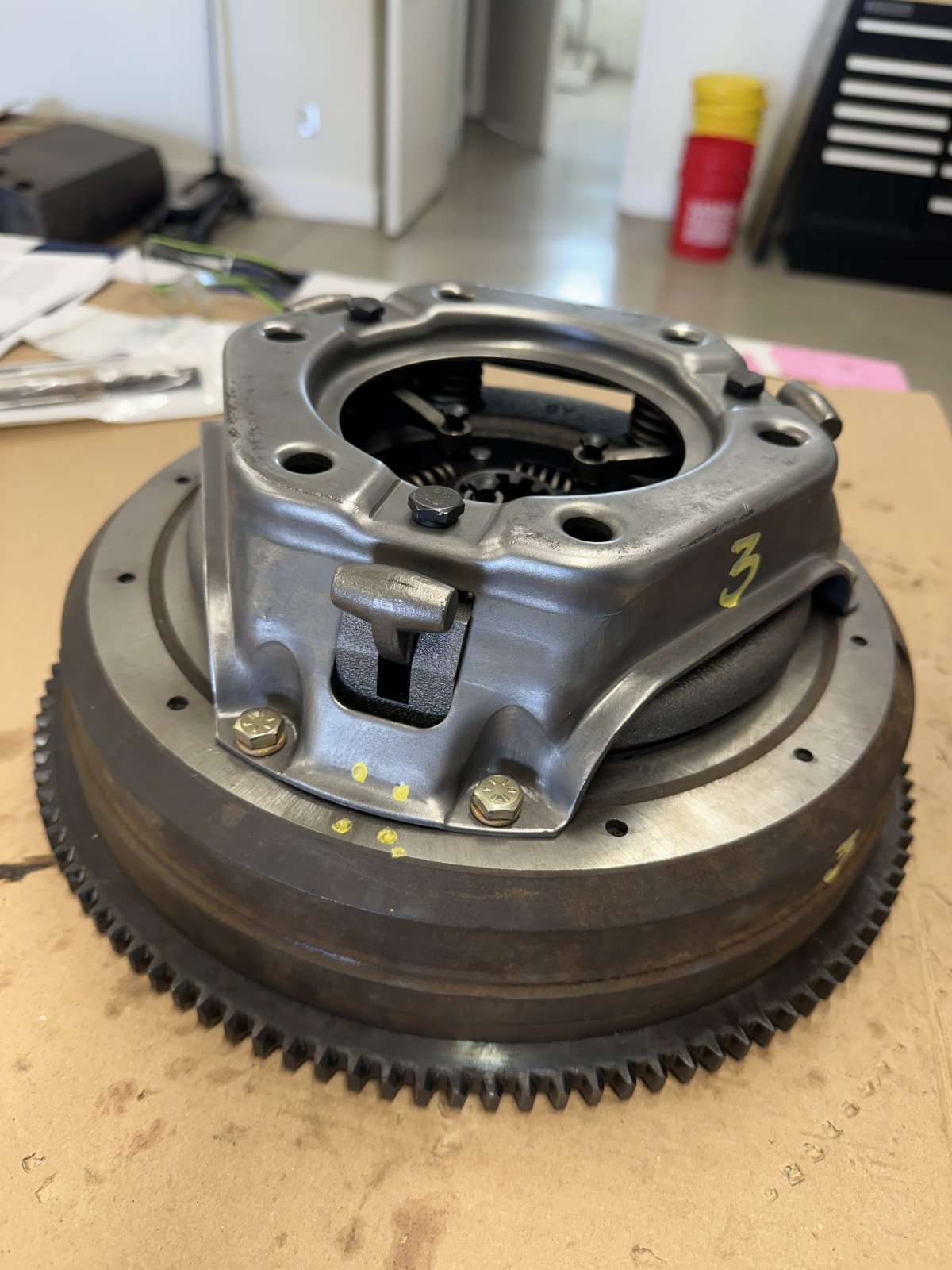

    I have a number of lightened stock ones drilled for the V-8 pressure plate....PM me if you are not wanting to stand at your lathe and make mounds of chips

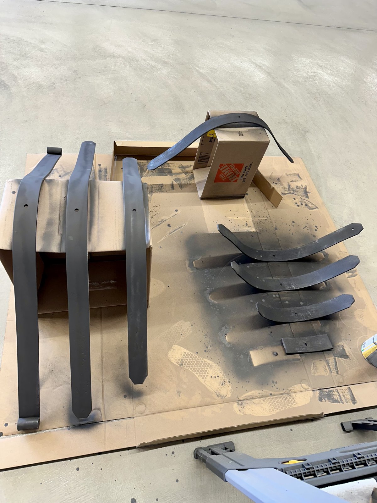

    Got sidetracked this weekend fixing a shifting issue on another car but made some progress stripping down the leaves in the rear spring and coating w slip plate. Also painted the shift tower housing and primed the front shocks. I forgot how much I hate painting….

    Lightweight flywheel, new clutch and V8 pressure plate arrived this week and got them in the car this morning.
