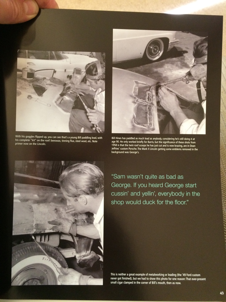

  25. [​IMG]speaking of traditional, here's some reprinted shots of the lead slinger himself doing what he did best. RIP Bill Hines[emoji120]
    loudbang and zombiecat like this.

    And a ****load of Indy roadster bodies...
